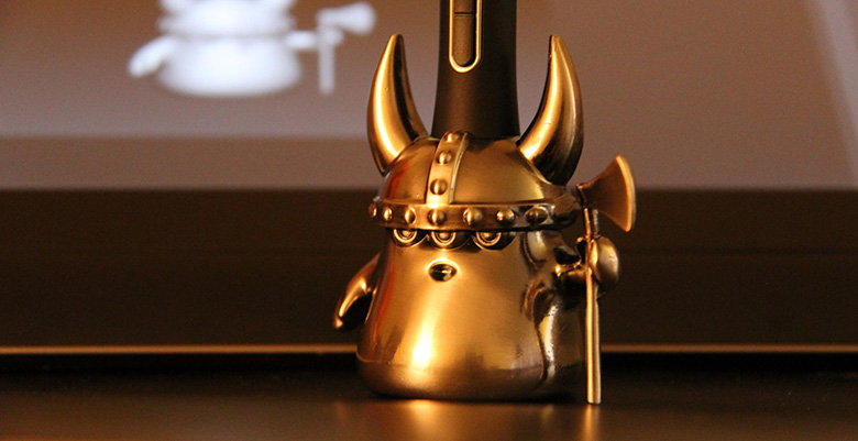

Here’s what the final pen holder design looks like molded and cast out of metal:
![Wacom pen holder molded and cast out of metal](https://www.fictiv.com/wp-content/uploads/2020/07/strong-3d_07.jpg)
