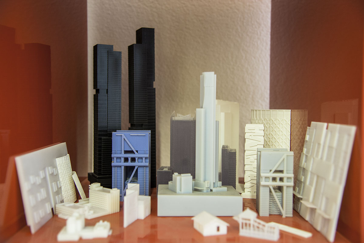

Moddler’s clients include individual artists and entrepreneurs but also architecture firms, toy companies, and big-name movie studios. The company has printed models for well-known films such as Thor, Oblivion, Men In Black 3, and “others we’re not allowed to talk about because they’re not out yet,” grins Jared.

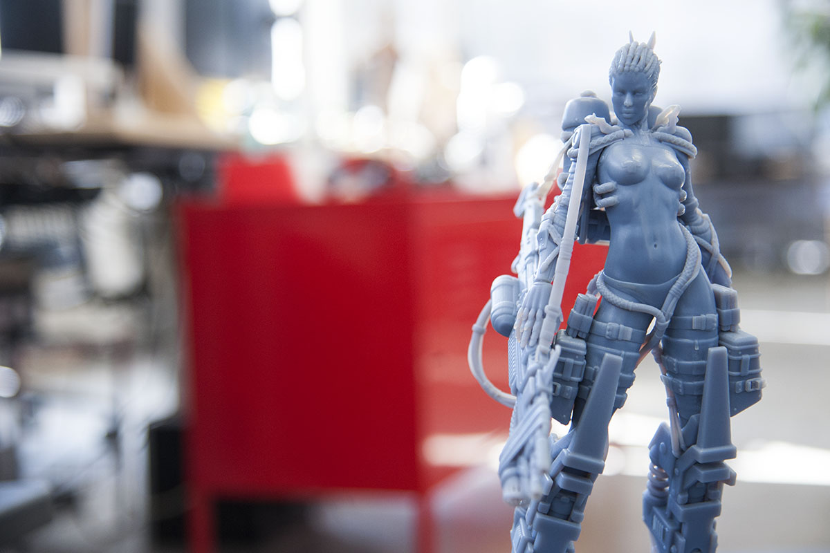

One look at the company’s portfolio makes clear the difference between desktop printers and Moddler’s machines, which print layers 16 microns thick. That’s less than a human hair, which measures 40-50 microns. But beyond the ultra fine detail, Moddler’s not done with a part until it looks like work of art. Not a micron of support material to be seen anywhere. (We get into those microns, below.)All Moddler Customers Are Created Equal

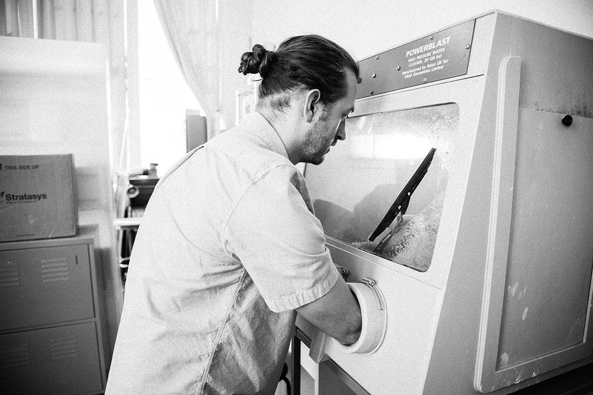

Every 3D-printed object needs a little TLC and Moddler takes this step very seriously. First, any support structures that can be removed by hand without damaging the printed part, are taken off. Then it’s off to the water jet, a pressure-sensitive 100-psi machine for a first cleaning.
![](https://www.fictiv.com/wp-content/uploads/2020/08/moddler-hws_06.jpg)
After that, Moddler soaks the part in lye, which removes all remaining support material, but none of the build material. One more time in the water jet to remove the lye. Then, it’s time for the drying station and hand-cleaning. Finally, says Jared, “we blow-dry the parts by hand. We never ship out a part that’s damp or wet.”
“We take extra care with the delicate parts,” he adds. “It’s very meditative, therapeutic to clean the pieces, it’s like digging out an archaeological relic.”

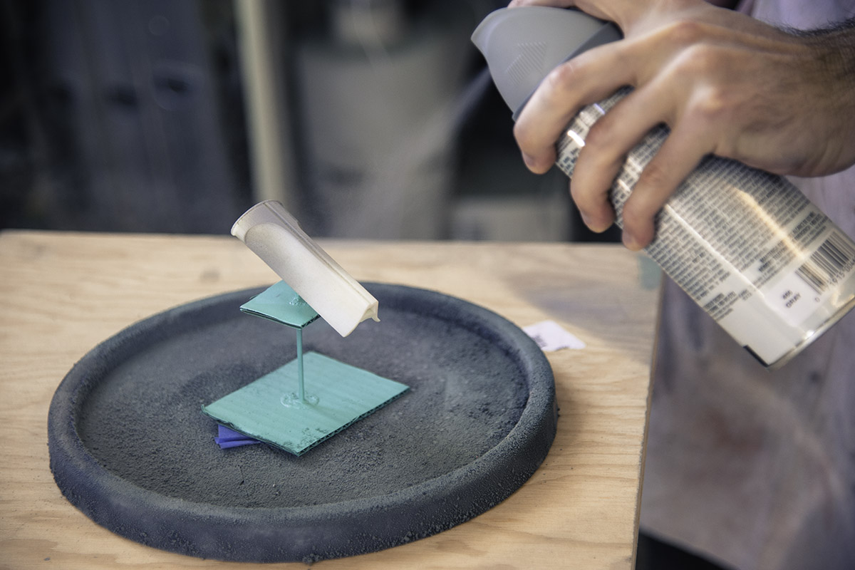

Some customers, says Jared, want more than just 3D printing; they want a perfect model—for that beauty shot or demo day. This means sanding and painting. For those customers, Moddler starts with 150-grit sandpaper and works down to 2500-grit to make it as smooth as possible. Then they prime and paint it, and sometimes do two rounds of sanding and priming—whatever it takes to make that part sparkle.
“It takes a long time,” says Jared. “We get into all the cracks with those little metal files.”
