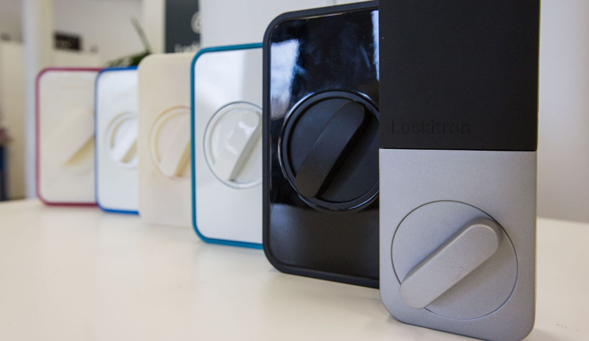

1. Consider Spray Painting as a Finish for Visual Models
People often think of spray painting as a low-end finish, but if you know the right circumstances in which to use spray painting, it can look just as good as a professional paint booth job.
Note that the main drawback of spray painting is durability, so if your prototype is going to be touched and handled constantly, spray paint will show wear-and-tear quickly. However, If the prototype is going to sit away from people’s hands, it will look fantastic.
![](https://www.fictiv.com/wp-content/uploads/2020/08/spray-painted-veroblack-prototype.jpg)
Spray Painting Tips:
- If your prototype is 3D printed, opt for a high resolution material like VeroWhite
- Always sand down the surface until it’s perfectly smooth and clean before applying paint
- Use a primer for a good bonding layer between the plastic and the paint
- Wet sand after each primer layer
- Use good paint — we recommend Montana Colors Spray Paint
- Use a Polyurethane Clear Coat as a final layer for protection and gloss
