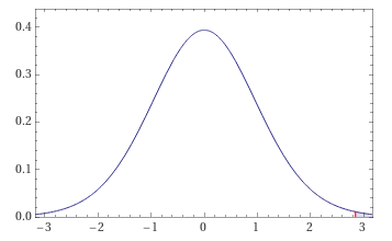

The graph below shows where the t statistic that we calculated falls on a distribution. The shaded part is the probability of getting this result by random chance. Again, this probability is below our significance level of 0.05.
normal distribution curve graph
This shows the t distribution for our hinge samples.
