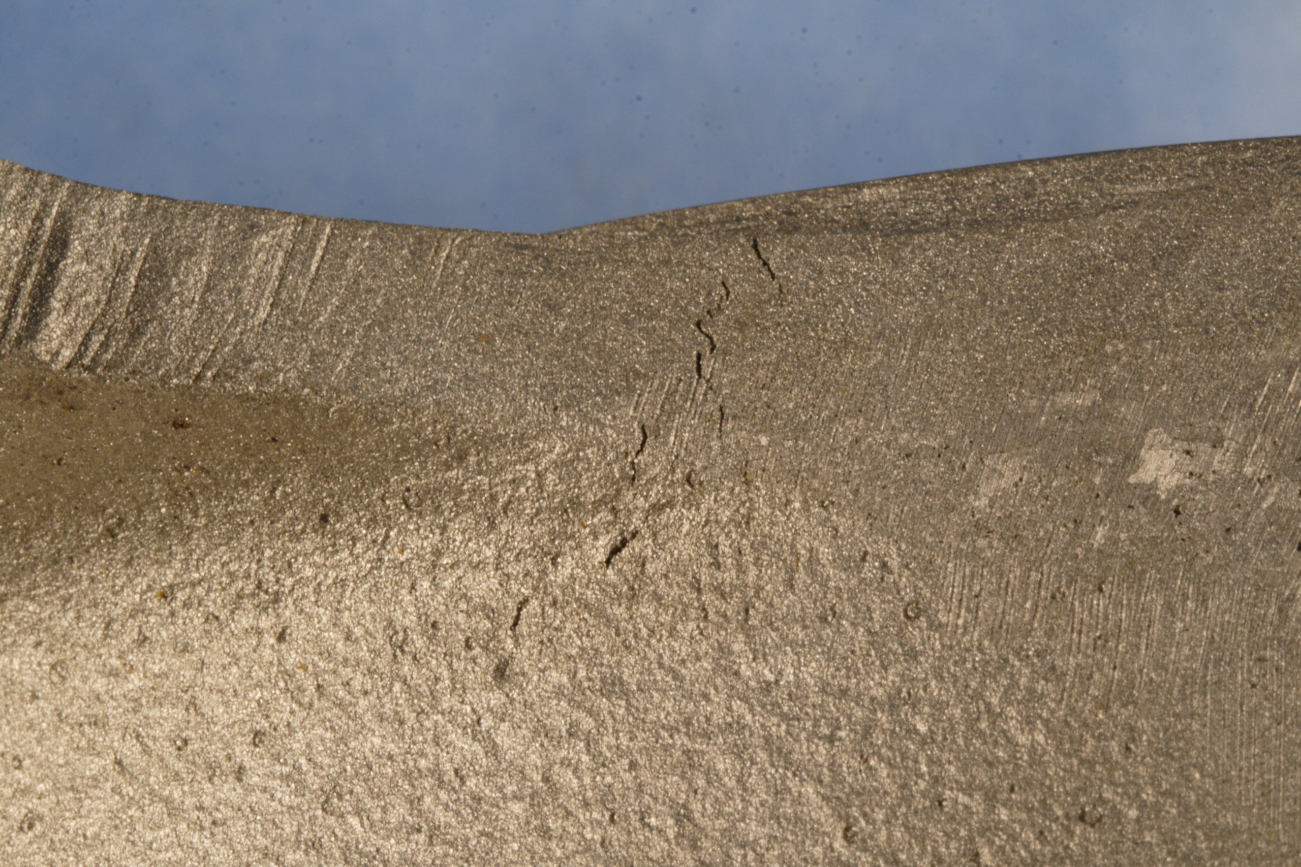

Casting Crack / Tear Defects

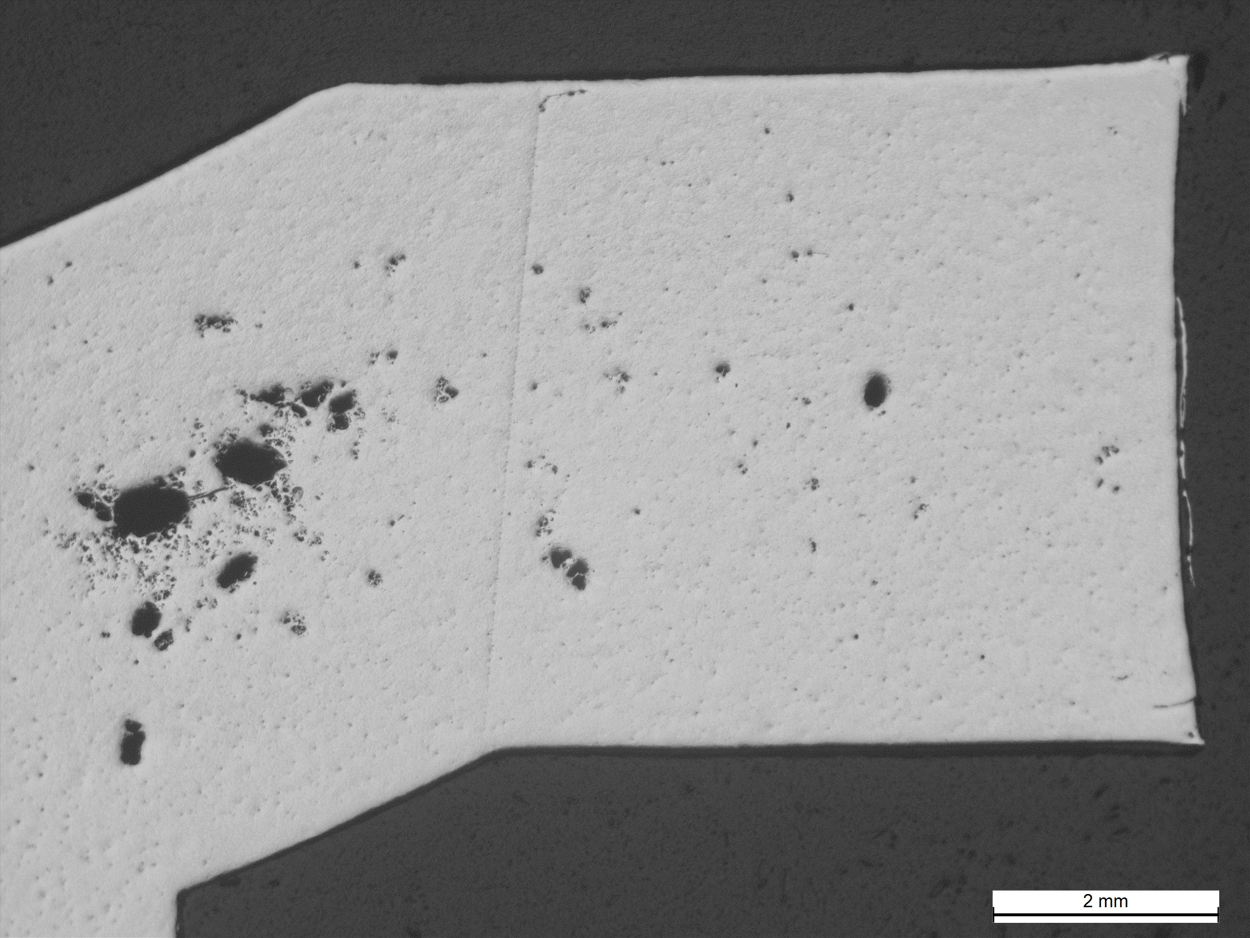

Cross-Section of Casting Porosity Defect
  1. Pinholes and blowholes: Due to gas entrapment leaving voids and/or bubbles as it cools; tends to leave voids at the top of the mold or exterior of the part as gas tries to escape.
  2. Shrinkage porosity: Caused by a lack of molten metal volume in the mold; results in small holes in the casting that are typically not as smooth as pinholes or blowholes.
  3. Shrinkage cavities: A larger section of shrinkage porosity that may result in significant structural issues; typically propagates from the inside of a casting to the outside as castings cool from the outside in.
  4. Hot tears or cracks: Defects due to rapid cooling; like shrinkage cavities but they are less jagged; cause mechanical performance issues.

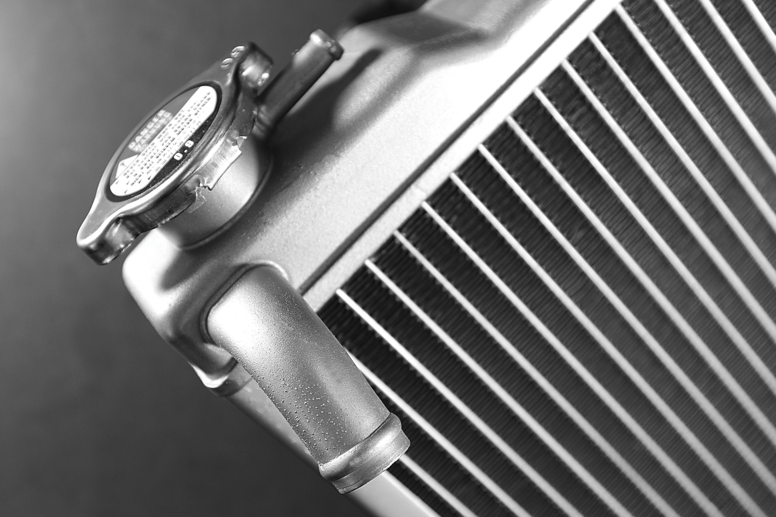

Example of a Pressure Test Specimen (Automotive Radiator)
Pressure Range or Leak Testing
Pressure range or leak testing is often considered to be functional testing intended to ensure the assembly or component can properly perform over the entire operating pressure range, without leaks. This testing often involves exposing the test specimen to an operating environment (primarily temperature) and a lower and upper limit of pressure values. The purpose of this test is to ensure the component or assembly being tested maintains its structural integrity and there are not any casting, machining or metal joining defects. A pressure range or leak test is considered an Acceptance Test Procedure (ATP) performed on every production part but may also be part of a more extensive Qualification Test Procedure (QTP). This type of pressure testing can also be utilized to assess the integrity of any additional components assembled on the test specimen, such as gaskets or seals.
Most of the assemblies or components which undergo pressure testing are designed such that the fluid flowing through them only experiences a set amount of pressure drop (aka air decay). This is something that is determined during NPI and is often a measure of success during a pressure range or leak test. For pressure testing where the test specimen is suspended in fluid, with a gas flowing through it, leak testing works by visually looking for air bubbles during the testing. For example, with pneumatic pressure testing, if gas bubbles are present in the fluid during testing, the test specimen is not airtight and it does not pass the test.
