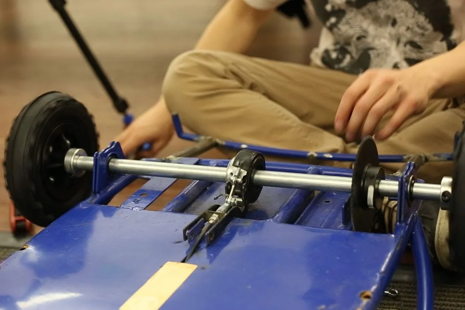

The issue we ran into here is that Razor uses an odd 19.85 mm rear axle, and no one makes roller chain sprockets over 20 teeth with a 20mm bore size. We decided, in the end, to buy a 60 tooth roller chain sprocket with a ¾” bore diameter and use a 20mm drill bit to increase the opening.
Unfortunately, this led to another problem: Now that we had opened up the bore size, the original key that locked the sprocket in place on the rear axle was too large, so we spent some time milling it down to the right size.
But then…the sprocket bore opening was just slightly larger than the axle, which was causing some wobble of the rear sprocket. We fixed this issue by using a thin shim to center the sprocket and then clamped it on both ends with shaft collars. Not ideal ,since this was additional unsprung weight, but we decided it was our best option.

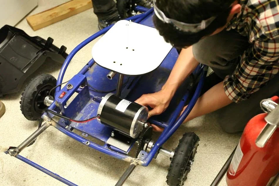

Once the sprocket was installed, the motor installation was fairly straight forward. We welded a steel plate to the frame to mount the motor, which was then lined up and held down with 4 bolts. We used washers to raise the motor and act as a tensioner on the chain.

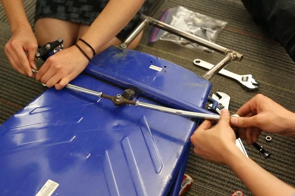

For the front wheels, it was a little more tricky. The new wheels didn’t fit the existing tie rods, so we needed to use the tie rods that came with these wheels. All seemed great until we realized that the new tie rods had a longer leverage point than the old ones, so our original non-adjustable steering rods wouldn’t fit.
We ordered some adjustable steering rods and installed them only to realize that the connection point on the new steering rods and the old steering column now don’t align.
At this point we were running up against our budget and couldn’t spend anymore, so we all huddled together, grabbed a vice, and ever so slightly bent the steering rods until they fit perfectly. Sometimes a hack is all you need!

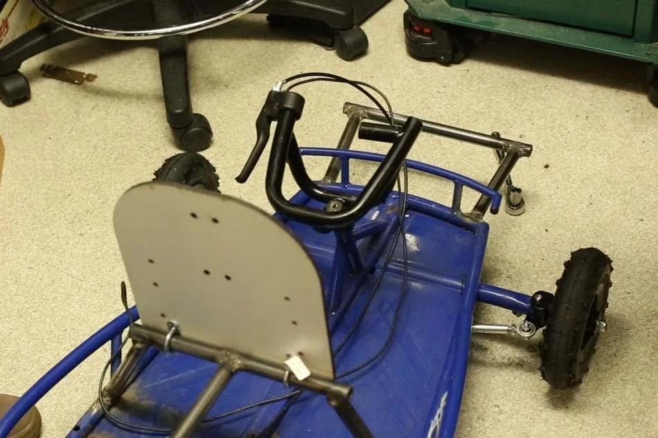

With steering in place, it was time to install the seat. We had previously already welded a seat frame on the car so that we could sneak the batteries below the driver. We knew the seat had to hinge up and down, so we used some U-clamps to hold the seat down and also allow it to rotate over the front support bar.
