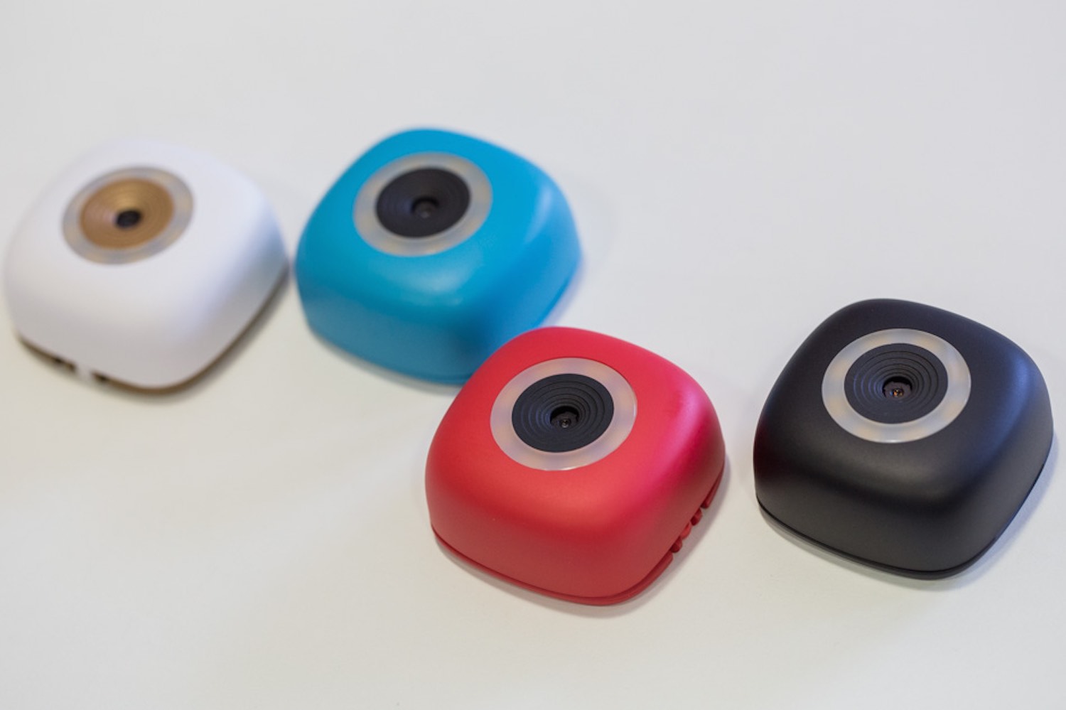

And that’s what the team focused on: making the selfie work for more than the one person, with a lot more convenience. All of the design and functionality choices the Podo team made for their new camera were about user friendliness.
Your peeps feeling too self-conscious in front of the camera? You can decide when to take the shot via your smartphone, instead of standing behind the camera and making everyone say “cheese” with those pasted-on smiles.
Tripods too heavy or awkward to carry around?  Podo has a hinged flap that lets you angle it just right, and a sticky pad that makes it possible to attach it to virtually any surface—wood, plastic, metal, brick.
Too many buttons/icons to tap on your smartphone? Podo has no buttons. You tap the camera case anywhere, and it turns on.

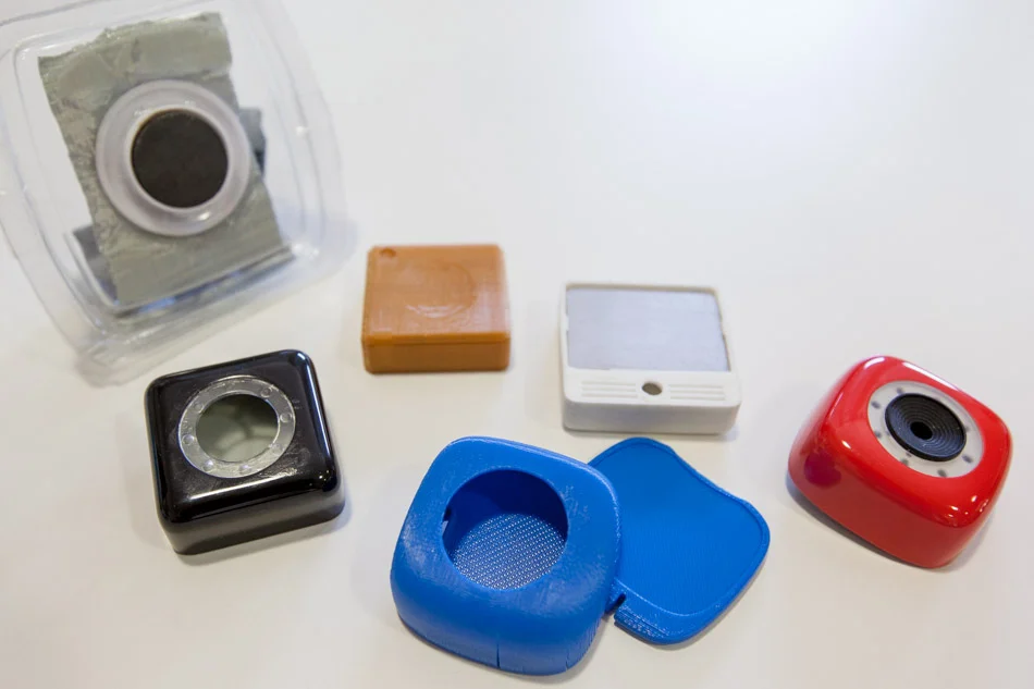

The joys and pains of Podo-typing

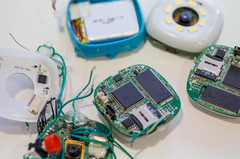

The first physical incarnation of Podo was an unwieldy mess, as Eddie tells it.
“We had a case concept that was 3D-printed, and we had this ginormous circuit board and we couldn’t fit it into the case. The batteries were attached to the camera with masking tape. It looked like a bomb. We thought we’d get kicked out of a TechCrunch networking event.”
On the positive side, Eddie says, they were able to get a viable image feed from the camera, but “…we couldn’t beta test with this first prototype. We couldn’t give someone that huge circuit board and say, ‘OK, pretend you’re sticking it on the wall!’”
There was another challenge—the sheer amount of time and cost involved.
“It took approximately a year and a half to put it all together,” shares Eddie. “In terms of the form factor, it was unacceptable to have a prototype that wasn’t 90% the real finished Podo. And we didn’t want to pass on any unnecessary costs to the consumer.”

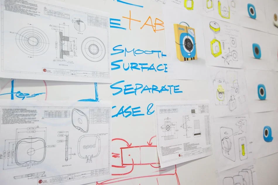

The first camera designs were all square—a logical design choice for a camera. But then the team noticed that the name they had chosen for the company and product—“Podo,” which means grape in Korean—has numerous circles in it: two o’s, and the body of the “p” and the “d.”
“So we rounded the corners but didn’t want to make it a full sphere,” says Eddie. “That’d be too much like a security camera. All those concentric circles we have on the front face, yeah, those were a pain for Sam [Pullman, co-founder]. He had to make a ring of LEDs.”

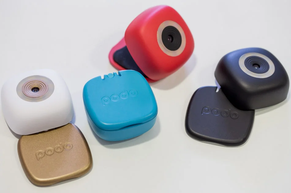

As for materials, the case had to be plastic, both because of weight and cost. That’s true for a lot of consumer products these days, “smart” or not. But what Podo learned they needed to pay particular attention to was the hinge—the hinge linking the camera body with the flap that attaches it to surfaces and lets people angle the camera.
“You can’t have the same types of plastics rubbing against each other in a hinge,” explains Eddie, “because it will squeak and wear itself down. One material needs to be stronger than the other.”
The ball of the hinge is polycarbonate (PC) mixed with Teflon, the back flap is PC only, and the front cover is ABS plastic. The light ring itself is PC mixed with white pearly elements.
