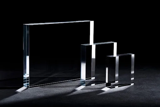

After producing a plastic part from CNC machining, the surface finish is typically semi-smooth or relatively rough depending on the technique used. Even clear acrylic will have a cloudy, matte surface as machined and requires finishing operations to become transparent again.

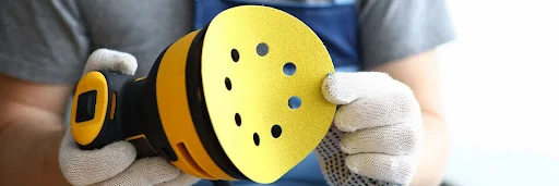

Once the surface is sanded, polishing begins. A polishing compound is applied, then buffed to knock down micro imperfections and sanding marks to produce a high-quality glossy finish. Sanding and polishing of CNC machined acrylic is done commonly done by hand, though there are various equipment and tools used to manually sand and polish CNC machined acrylic parts. Here’s a list of the most common tools:
Belt Sander – An electric motor turns a continuous loop of sandpaperRandom Orbital Sander – A hand-held tool that simultaneously spins and moves the sanding disc in small ellipses to help prevent swirl marks and directional sanding marks

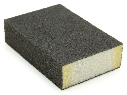

Sanding Block – A hand-held tool that holds sandpaper and allows even pressure for manual sanding as well as limiting hand fatigue from holding the sandpaper

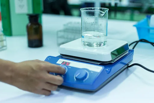

What equipment or machines are needed to vapor polish a part? Depending on the material being polished, it could be as easy as setting up a hot plate, container of solvent, and a method to fixture the part in the vaporized solvent! At Fictiv, we use Weld-on 4 liquid solvent to vapor polish polycarbonate (PC) to a near-clear opacity — making it an ideal process for polishing clear PC.
Simple Hot Plate and Beaker Set-up for Vapor Polishing
