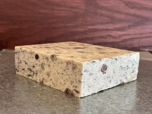

![wire EDM cut granite slab](https://www.fictiv.com/wp-content/uploads/2022/08/wire-EDM-cut-granite-slab.png)
Tips for CNC Machining Hard Materials with EDM
- Choose the appropriate wire for wire EDM. Coating the wire (like zinc coatings) improves the wire stiffness, which in turn improves the cut speed and flushing at the cut surface. Pro-Tip: Use a larger diameter wire to make a rough cut then follow up with a smaller wire to create the finished edge.
- Take a look at the granite block pictured above, which was cut with wire EDM for my own home remodel. Granite is almost as hard as it gets for effective wire EDM cutting, and you can see that the shop didn’t follow up with a smaller wire diameter cut to smooth out the edge on the right.
- Utilize adaptive controls, where possible, to reduce the re-cast layer and heat-affected zone volumes.
- Change out dielectric fluid and tooling more often for sinker EDM applications, as the tooling tends to wear at a more rapid rate when harder materials are used.

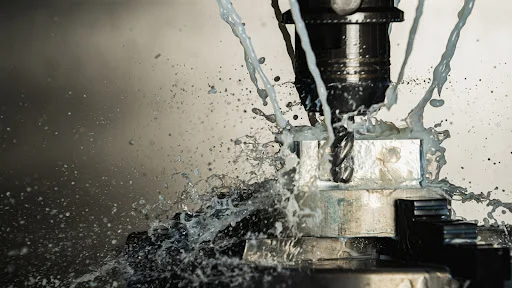

Tips for CNC Milling Hard Materials
- Choose the right tool type for cutting through hard materials. Ball end mills are optimal because they help to dissipate heat from cutting while reducing the risk of deforming the workpiece.
- Choose the right tool material. Harder materials such as solid carbide and ceramics are good for CNC cutting parts from hard materials.
- Hold off until parts have been heat treated, if possible.
- Use the correct type and amount of coolant or lubricant to help to dissipate heat generated during the CNC cutting process. Spindle cooling systems offer excellent heat dissipation.
- Ensure radial step-over distance is ~10-20% of the tooling diameter.
- Reduce runout by using high-quality tool holders. These also reduce vibration, which provides higher precision cuts — dovetail holders are typically a good start.

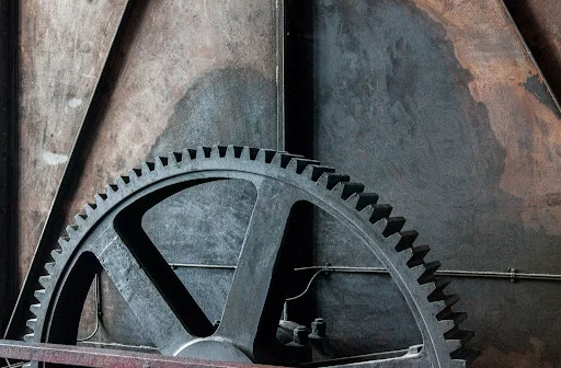

Gear Hobbing
We all remember from our early mechanics courses in school that gears, while relatively simple, are extremely valuable and versatile for transferring or changing the direction of movement. And gear hobbing is a specialty CNC machining process that is used to create — you guessed it — a wide variety of gear shapes on both metal and non-metal parts and is one of the most popular gear manufacturing methods for gear production.
With gear hobbing, the gear teeth (or splines) are progressively cut into a cylindrical piece of material by a cutting tool called a hob. Hobbing is excellent for achieving complex gear shapes and sizes such as spur gears, worm gears and bevel gears. Although gear hobbing can be used for prototyping small quantities, this process is best suited for higher volume production.
