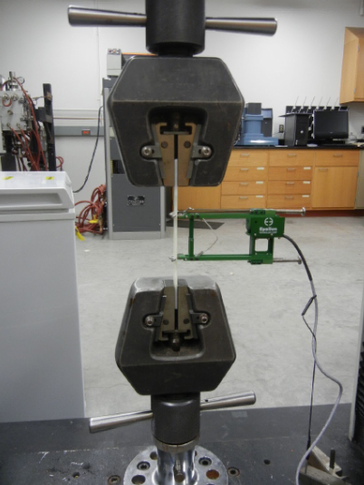

In order to gather a comprehensive data set, the researchers created an .STL file modeled after the ASTM D638, which is the standard test method for measuring the tensile properties of plastics. They then printed 10 pieces based on the same .STL file on a wide range of RepRap printers, including a Mendel, Prusa, Lulzbot, and a custom MOST printer.
The researchers also used a variety of slicing software, including Skeinforge Slic3r, and Cura, and a variety of settings. Since RepRaps and other maker-built 3D printers are highly customizable, each require unique settings in order to print the best parts possible.
For consistency, all pieces were printed with a setting of 100% infill in the x-y plane, which aligned the filament with the direction of the loading with the least number of layers.
Finally, testing was performed on an Instron 4468 load frame controlled and measured using Bluehill Software on a Windows PC.
The tests proved the following results:
For comparison, Stratasys’ ABSplus material printed on a Fortus printer, a mid-grade commercial machine, has a tensile strength of 33 MPa and elastic modulus of 2200 MPa.
These numbers show that the PLA and ABS parts printed on RepRap printers are relatively comparable to parts printed on commercial-grade 3D printers and therefore mechanically functional for tensile application.
