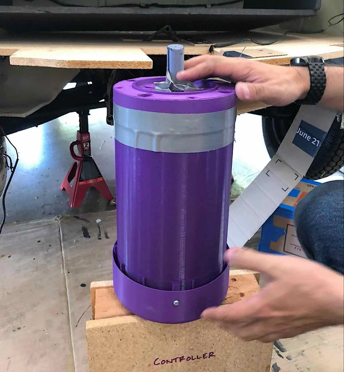

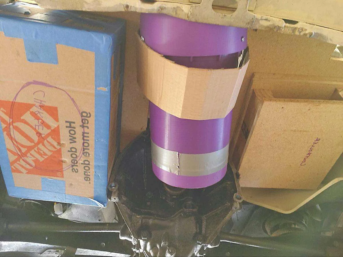

No matter which option we chose, a major lesson learned from this project was the importance of prototyping. Even simple prototyping is helpful and effective. You can learn a lot by just mocking up the size and shape of a part, which is why we used a LOT of cardboard, foam-core, particleboard, duct tape, and hot glue as we worked out our final designs.
image of a purple, 3d printed mockup of an electric motor with cardboard mockups of controller and charger in a fiat 500 rear trunk
A fit check of the motor, controller, and charger in the trunk
We found that these simple, lightweight prototypes were easy to move around and manipulate, which was critical to figuring out how everything would fit in the car. We even used the 3D printed motor prototype long after we ordered and received the actual motor — it was so much easier to move around, and there was no risk of damaging the real thing.
purple 3d printed mockup of an electric motor
Our lovely purple 3D printed motor prototype
In addition to the motor mockup, we also 3D printed the coupler to do fit checks and test how much space it required.
