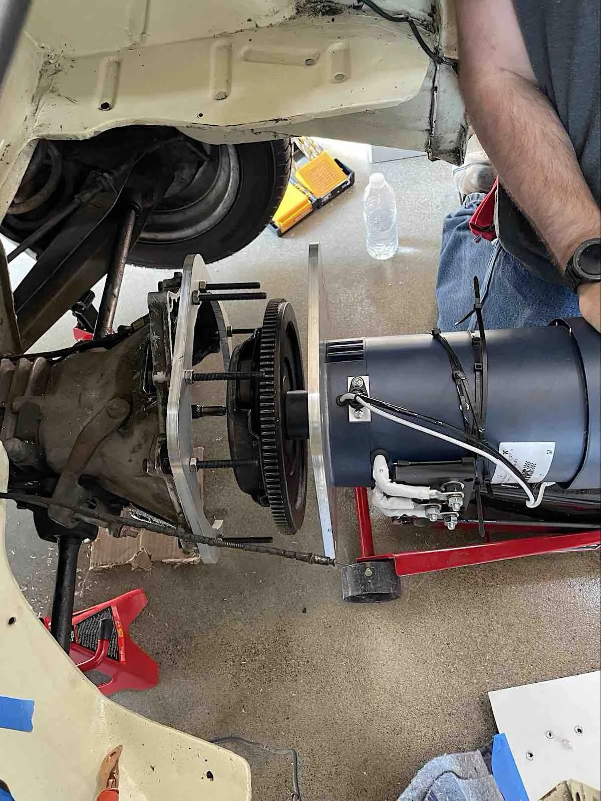

The bell housing plate for the motor, however, was quite difficult to model. The bell housing is part of the transmission that covers the flywheel and clutch of the original car’s drivetrain. One set of holes on the plate was fastened to the mounting holes on the motor, while another set of holes was fastened to the bell housing.
Because we couldn’t find documentation for the car, we had to measure the specific hole pattern on the bell housing by hand. First, we tried shading the holes on a piece of paper that we laid on the bell housing with a pencil to make a tracing of the holes. Then we took pictures of the bell housing, measured the number of pixels, and equated those values to inches to find the measurements. In the end, those efforts combined with oversizing the holes for extra clearance were sufficient to create a bell housing plate model.

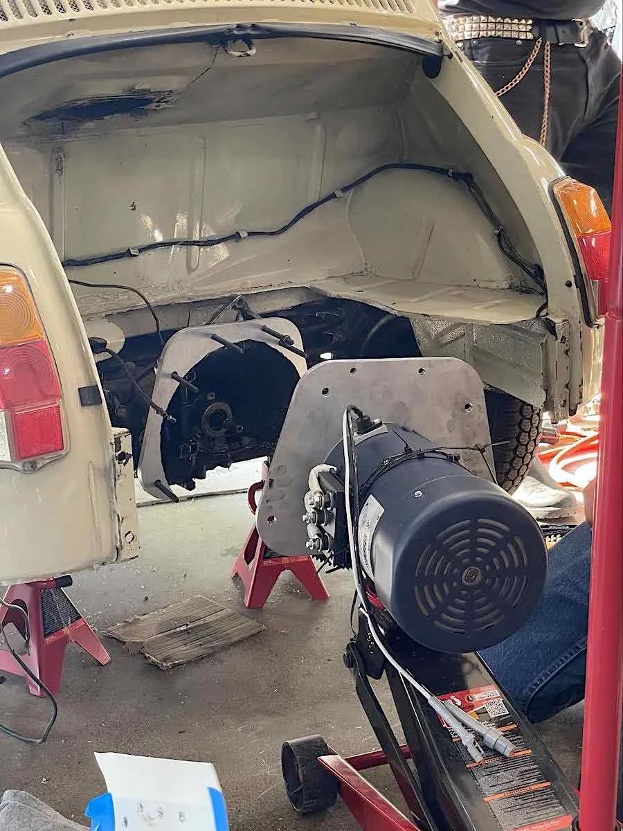

Getting back to the layout, the assembly feature in OnShape was useful in determining the orientation of the parts. However, it’s important to remember that just because you can do something in CAD doesn’t mean that it will be easy, or even possible, in real life. We were reminded of this lesson the hard way when trying to fit the engine mounting plate in the trunk — in CAD it worked, but in reality, the plate was too big to fit through the opening of the trunk!
So, we had to cut the plate in half and create mending plates to join them back together. While the large plate was made out of aluminum, the mechanical team decided that steel would be better for the mending plates to avoid creating a structural weak point along the split. And that mounting plate was a part we outsourced, using one of Fictiv’s manufacturing partners to machine it for us.

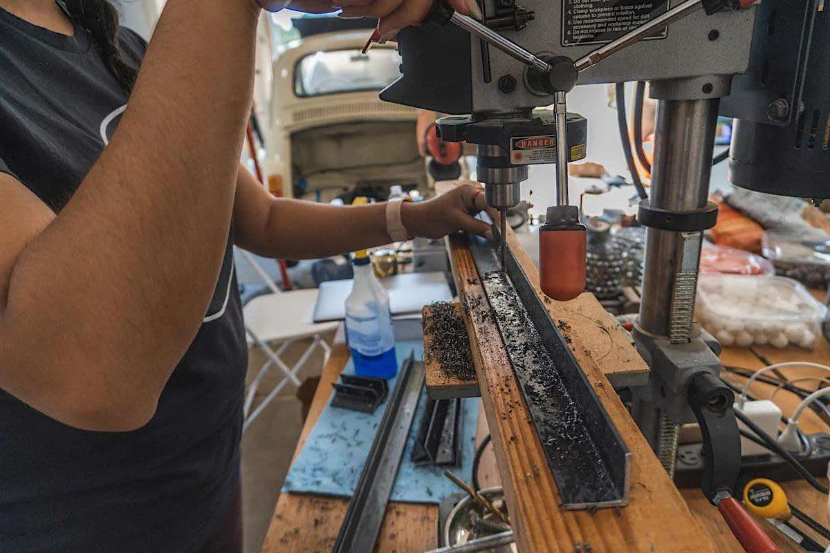

On the other hand, we built the battery boxes ourselves (you can read more on that decision in another article). We wanted to make cheap boxes that were both easy to seal (with silicone around the edges to make it waterproof) and strong. What we came up with was a two-layer box design with steel angle bar on the corners to connect the plastic faces. We made 2 boxes: 1 larger box to hold two batteries in the trunk, and one smaller box to hold one battery in the frunk.
The steel bar made these boxes extremely heavy. The mechanical team decided that this was appropriate because the boxes would be supporting a significant load and contain a high-value part of the car. However, it was still important to be aware of where we used steel, not just for the additional overall weight, but also to maintain safe and efficient weight distribution.

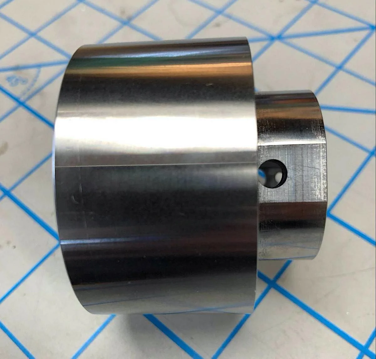

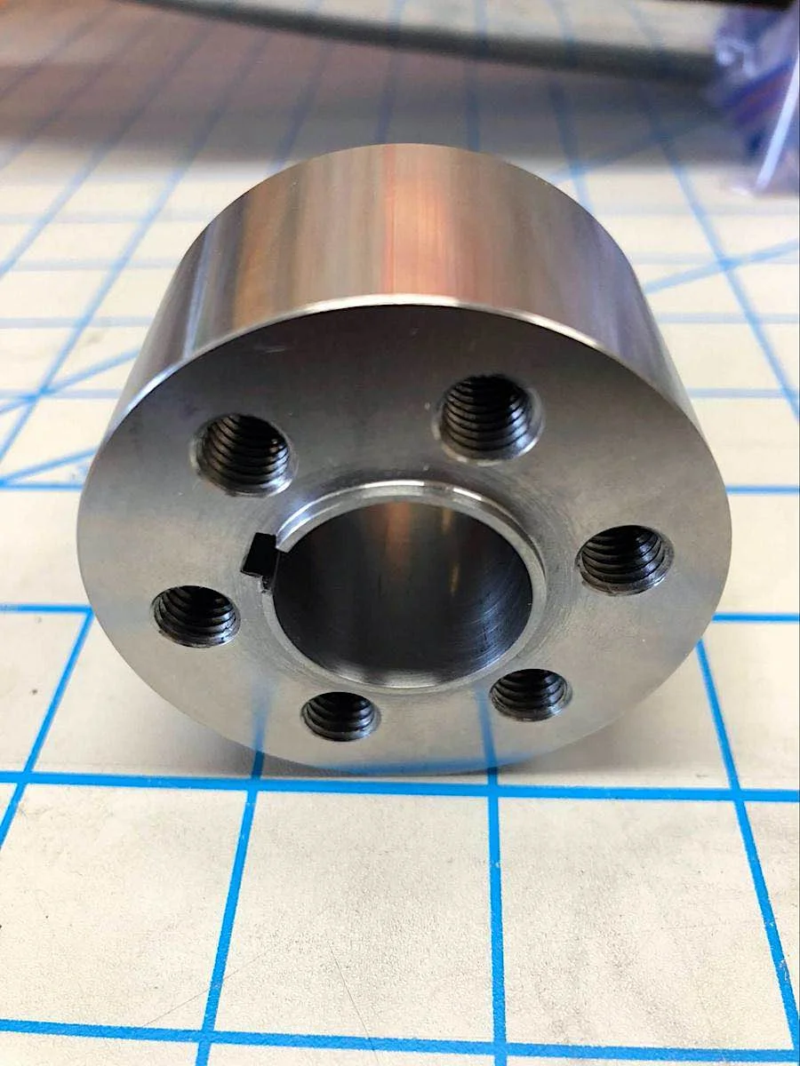

Another important part that we designed was the coupler that fits over the motor shaft and mates with the transaxle shaft. With all of these different parts interfacing, tolerances were critical, so we used ISO 2768 tolerances unless otherwise specified. For the coupler, we used a key from McMaster to fit into a keyway that needed a precise fit, so tighter tolerances were required.
Connecting the motor to the transaxle
Once the components were constructed it was time to tackle mounting them. The inside of Butterball has precious little space structurally capable of serving as a mounting point. Although there’s plenty of sheet metal in the engine bay, it’s not structural and certainly not strong enough to support a 120-pound battery. So, we had to use the actual chassis of the car, which required extra attention to detail. For stability, we used lock nuts where we could and aircraft cable instead of simple wire to hold the battery box in the frunk.
