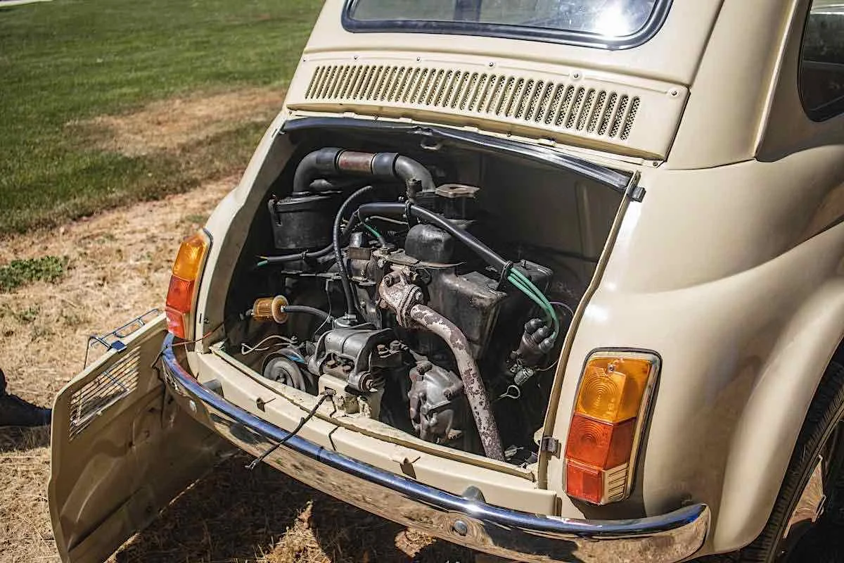

Our first big task was to remove the engine — an important step, because as an electric vehicle, Butterball wouldn’t be needing its combustion engine any longer. Pulling the power plant also helped us better understand the internal operations of the car, and figure out where to mount and connect the electric drive components.
![image of the rear of a 1966 fiat 500 with the rear trunk lid removed so you can see the engine](https://www.fictiv.com/wp-content/uploads/2021/12/fictiv3image3.jpg)
As an older car, the Fiat’s drivetrain and systems are relatively simple and straightforward. There are no computers to program and plenty of space because there’s little else than the drivetrain, seats, radio, and analog gauges inside.
The electrical system is also relatively uncomplicated. However, because this car hasn’t been being mass-produced in decades, finding replacement parts was a challenge. Even documentation to figure out what was going on inside the car was hard to come by. We were lucky to have the full manual that came with the car, but outside of that, we had to resort to other hobbyists (or this episode of Vintage Voltage) to learn how the car’s systems work.

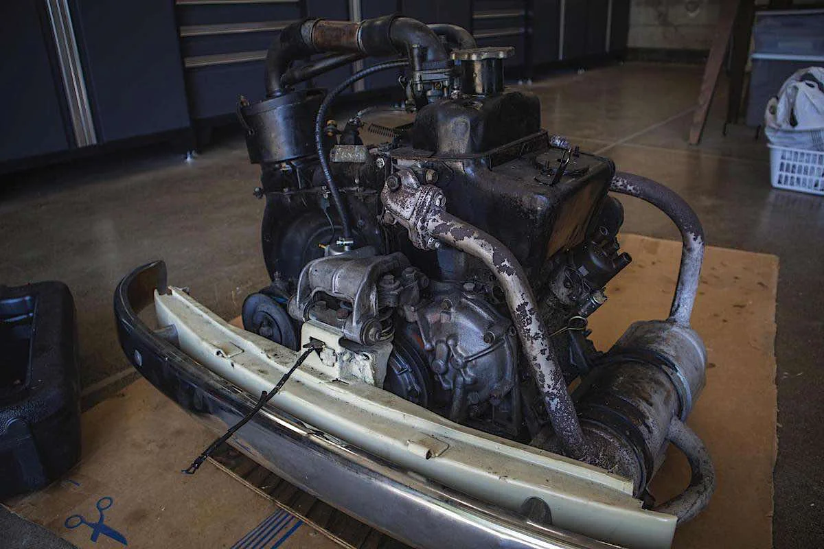

One of the biggest initial challenges we faced was how to connect the motor shaft to the transaxle shaft. This is not a trivial problem; if the motor is running but can’t turn the wheels, Butterball won’t be much of a car, will it?
Our first idea was to create a coupler to connect the motor shaft directly to the transaxle shaft and eliminate the clutch. This configuration would lock the transmission into gear while the car was moving, and could only be changed when stopped — so, you would be stuck in either 3rd gear (best for city driving), 4th gear (for highway driving), or reverse.
![image of 1966 fiat 500 engine with bumper attached sitting on the floor of a garage](https://www.fictiv.com/wp-content/uploads/2021/12/fictiv4image4.jpg)
However, after doing some fit checks and research, we discovered that the clutch was compatible with our electric motor. All we had to do was design and manufacture a custom coupler, which ended up being simpler than eliminating the clutch.

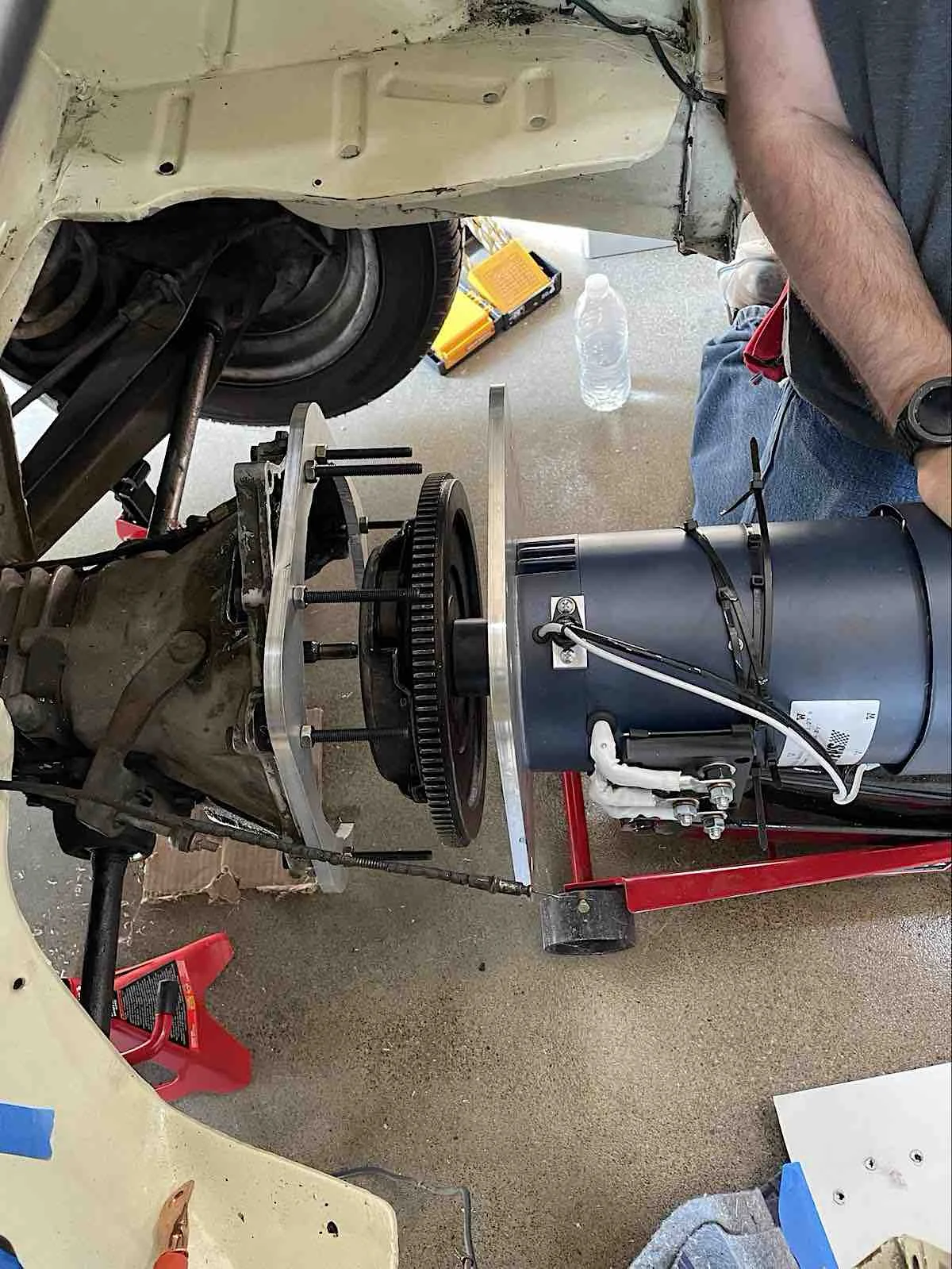

Now we actually had to fit the motor inside the car. At first, we thought the motor would stick out too far and interfere with the bumper. One solution was to remove the transaxle, but this would also mean removing and replacing the differential in order to transfer the power ninety degrees to the wheels. (The differential is what allows the wheels to turn at different speeds on turns.) Removing the differential and transaxle were way beyond the scope for this project, however, so we left it all in.
![image of electric motor, aluminum mounting plate and flywheel being attached to the drivetrain of a 1966 fiat 500](https://www.fictiv.com/wp-content/uploads/2021/12/fictiv1image1.jpg)
Instead, we hollowed out a section of the motor shaft so that it could slip over the unsplined section of the transaxle shaft. This approach worked with our custom coupler to connect everything together, transmit power from the motor, and officially and fully electrify Butterball’s drivetrain!
