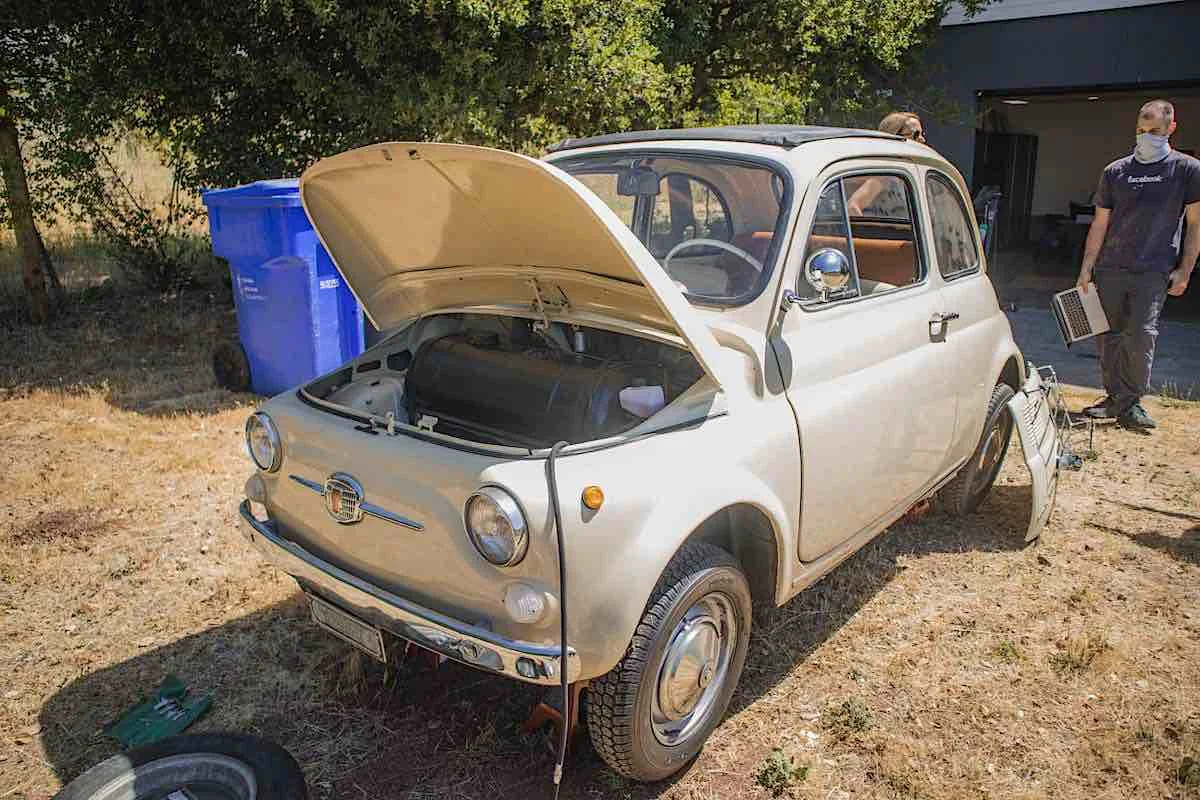

When it comes to an electric vehicle conversion, naturally, designing and installing the electrical system is an indispensable part of the process. It’s in the name, after all! In this article, we’ll discuss how we designed the new electrical system for our EV car conversion project, affectionately known as Butterball. You should also check out our articles on the origin of the project, our mechanical design, and prototyping and part sourcing efforts.
![image of tan colored 1966 fiat 500 on jack stands with the front trunk open](https://www.fictiv.com/wp-content/uploads/2021/12/fictiv1image8.jpg)
When you start with a big engineering project like this, job one is to determine the requirements for both design and testing. For Butterball, we wanted the electric version of the car to have at least 50 miles of range with a top speed of 65 miles per hour.
With these requirements in mind, we went about selecting a motor and battery. The speed requirement informed the mechanical output power required, which made it easier to select the electric motor. The range and drive cycle, or proportion of speeds (100% highway, 50/50 highway/city), would inform the capacity (in kilowatt-hours) of the battery required. Another battery-related constraint we had to consider was space we had to account for how many batteries could actually fit in the car to deliver the voltage for the power output required.

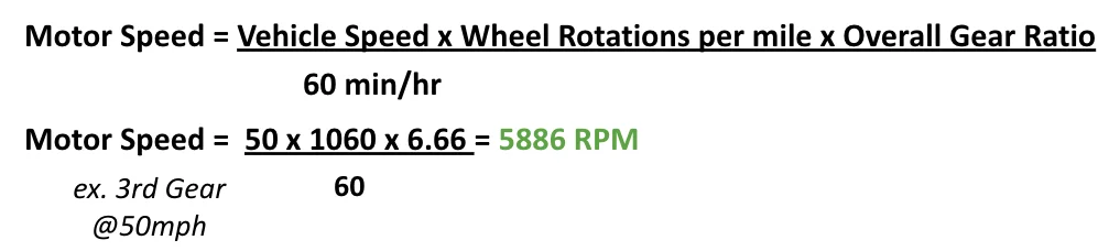

Calculating the Required Motor Speed
First, let’s look at how we calculated the necessary motor speed. This handy equation below uses the vehicle speed (50 mph), wheel rotations per mile (1060, based on the circumference of the wheel), and the overall gear ratio (6.66 in third gear).

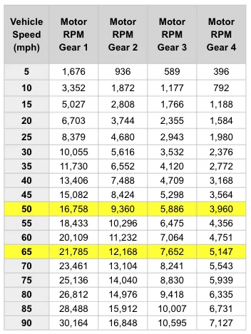

We also used a spreadsheet to calculate this motor speed for a range of vehicle speeds and different gears.

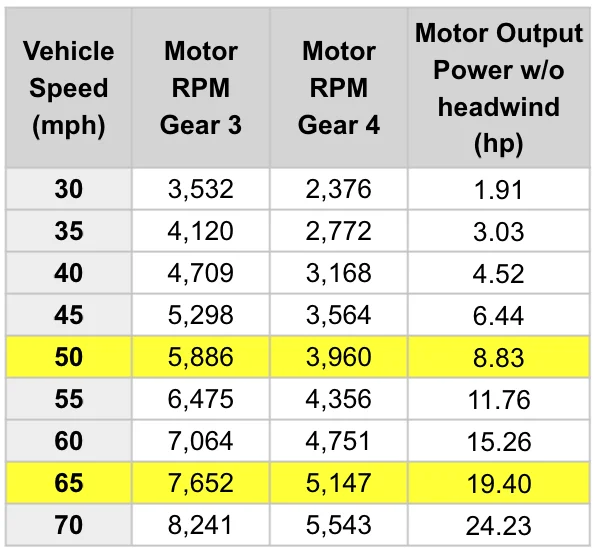

We also used a spreadsheet to calculate the power requirement for different vehicle speeds:
![](https://www.fictiv.com/wp-content/uploads/2021/12/image6.png)
Those formulas told us that in order to go 65 miles per hour on the freeway, we needed 19.5 horsepower. And it so happened that the motor we were considering, the AC20 72V, packs 48hp, more than double what we actually needed — this thing’s going to be quick!
