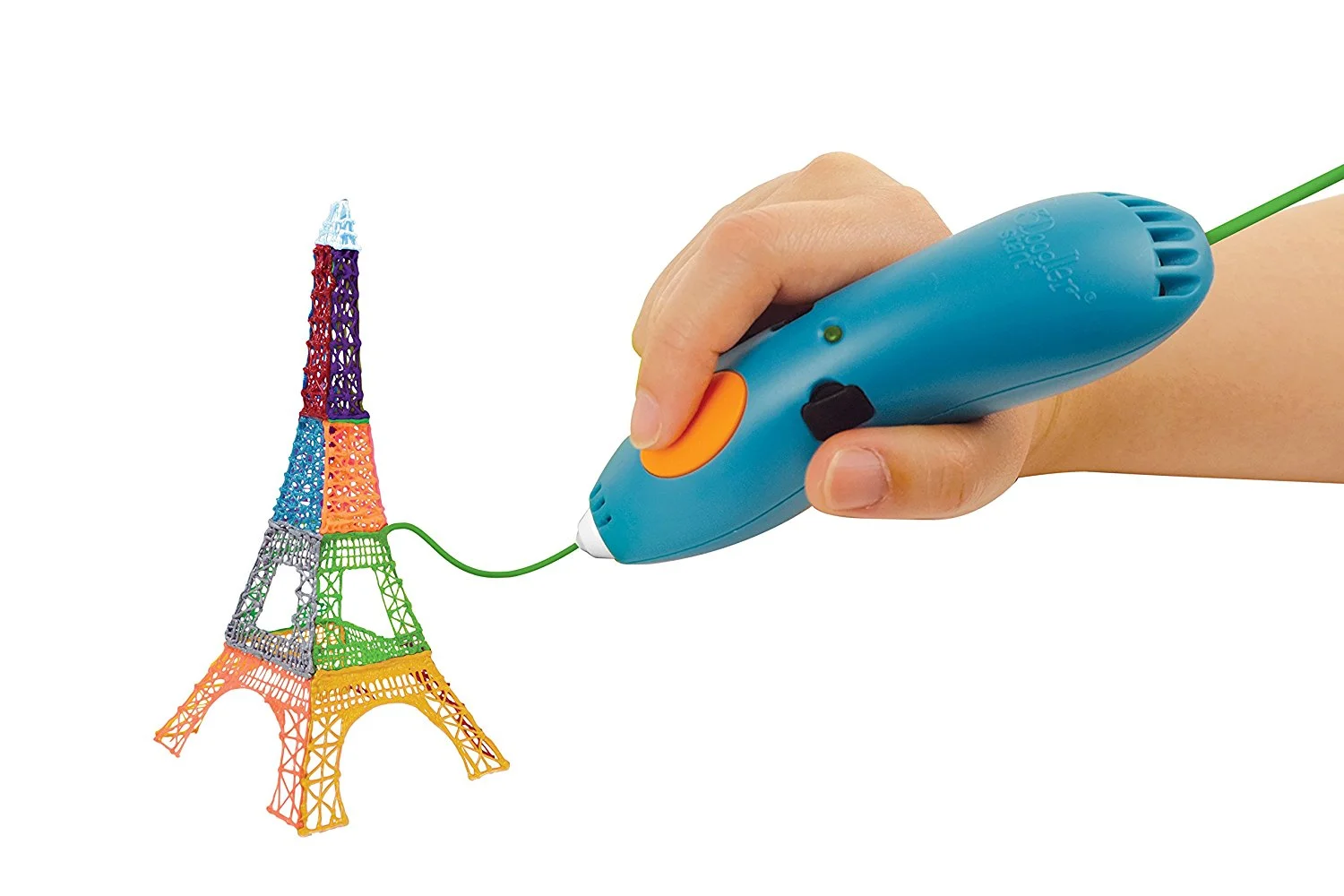

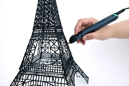

The 3Doodler is “The World’s First 3D Printing Pen” and one of the most successful companies built on the Kickstarter platform. Since then, WobbleWorks, the company behind the pens, has shipped over one million pens. For our teardown, we got our hands on the 3Doodler Create, the 3rd generation of its original pen, and the kid-friendly 3Doodler Start.
Both pens work by extruding heat-softened thermoplastic that cools quickly into a solid, stable structure, allowing for free-hand creation of three-dimensional objects. 3Doodler Create can use ABS, PLA or Flexy (a TPU filament), while 3Doodler Start uses a proprietary home-compostable plastic that melts at a much lower temperature.
Here are some of the key insights we uncovered in the teardown of each pen:
3Doodler Create
3Doodler Create
  • The outer body shell is an aluminum extrusion. Holes for buttons and ports are CNC milled away. The enclosure is finished by bead blasting, type II anodizing and lastly the logo and serial number are laser engraved.
  • The internal plastic chassis is made up of glass filled nylon, which is stiff and heat resistant (up to 260°C), making it ideal for being in an environment that heats up to 180°C.
  • The pen tip sleeve is made of silicone, another heat resistant material commonly used in cookware.
  • The fan motor is mounted away from the pen tip, but the fan blades blow air toward the pen tip regardless.
  • Filament is pushed towards the nozzle via a single worm gear.
3Doodler Start
3Doodler Start
  • Since Start uses a special filament that softens at only 40°C, heat resistant materials are no longer a requirement in this product. Therefore, the outer body enclosure and internal plastic components are made of ABS plastic. Even the extrusion nozzle is plastic.
  • Outer body shells are ultrasonically welded together, making this product much more difficult to take apart (and safer for kids!)
  • Start is much larger than Create because it has 2 LiPo batteries to enable wireless doodling.
  • Compared to the easily-accessible internal components of Create, Start seals away its extrusion mechanisms and motors within an internal chassis.
  • The internal chassis pieces clamp together via snap fits, easy for factory assembly and rework. We heard from the inventor of this pen that there used to be many screws, but they were gradually engineered away during the iterative design process.
