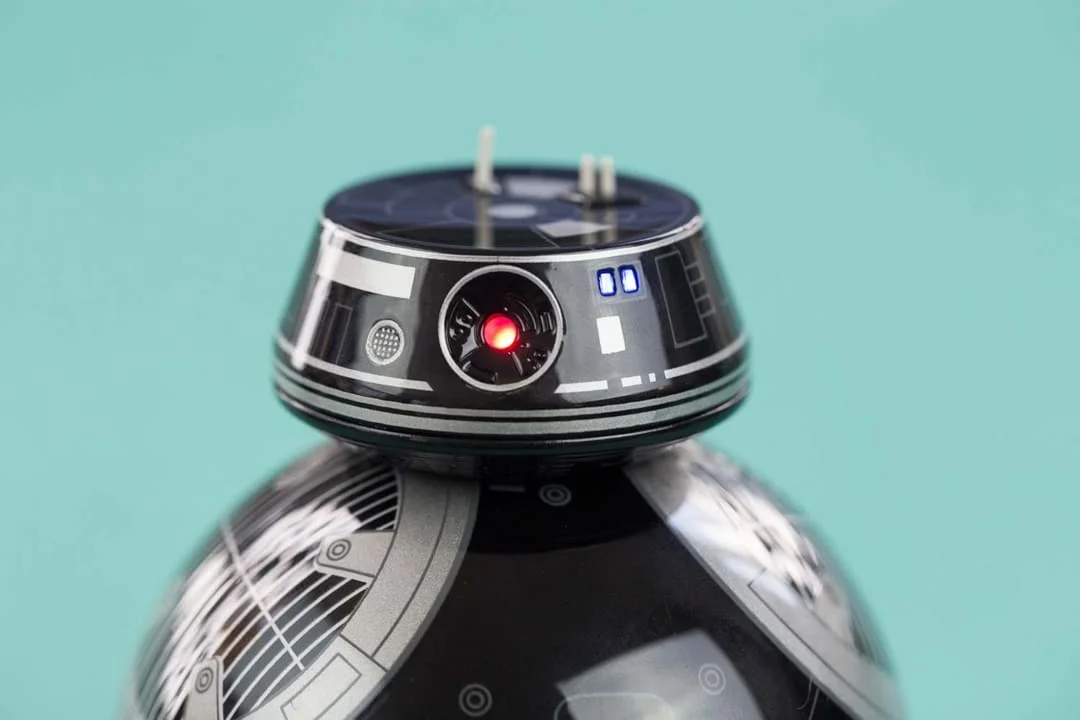

Like many Star Wars fans, Lucasfilm has exacting criteria for character development—the physical product must stay true to the original artwork. For the development of the new BB-9E toy, Disney shared a variety of images and movie props with the Sphero team, but not CAD files, so Sphero’s engineers were tasked with the incredibly challenging problem of constructing the new product’s shape and dimensions from scratch.
“BB-9E’s head is a trapezoid shape, and for the first few prototypes, the shape was off by about ten degrees and looked a bit odd… we spent a lot of time iterating on the shape to make sure it was true to the original design,” shares Judd.
![bb-9e sphero star wars toy](https://www.fictiv.com/wp-content/uploads/2020/08/sphero-starwars-spotlight7.jpg)
So how did the team know when they hit the mark? Lots of back-and-forth with Lucasfilm for approval.
“We would send them our design iterations and each time they might say, ‘This color’s a little off,’ or “This line needs to move this way,” adds Judd. “On BB-9E’s face, blue lights were measured down to a tenth of a millimeter, and we fought to get it as close to perfect as we could. When you scale down, a lot of the details get really tiny and you need to consider if you can even manufacture a 0.05 mm difference easily.”

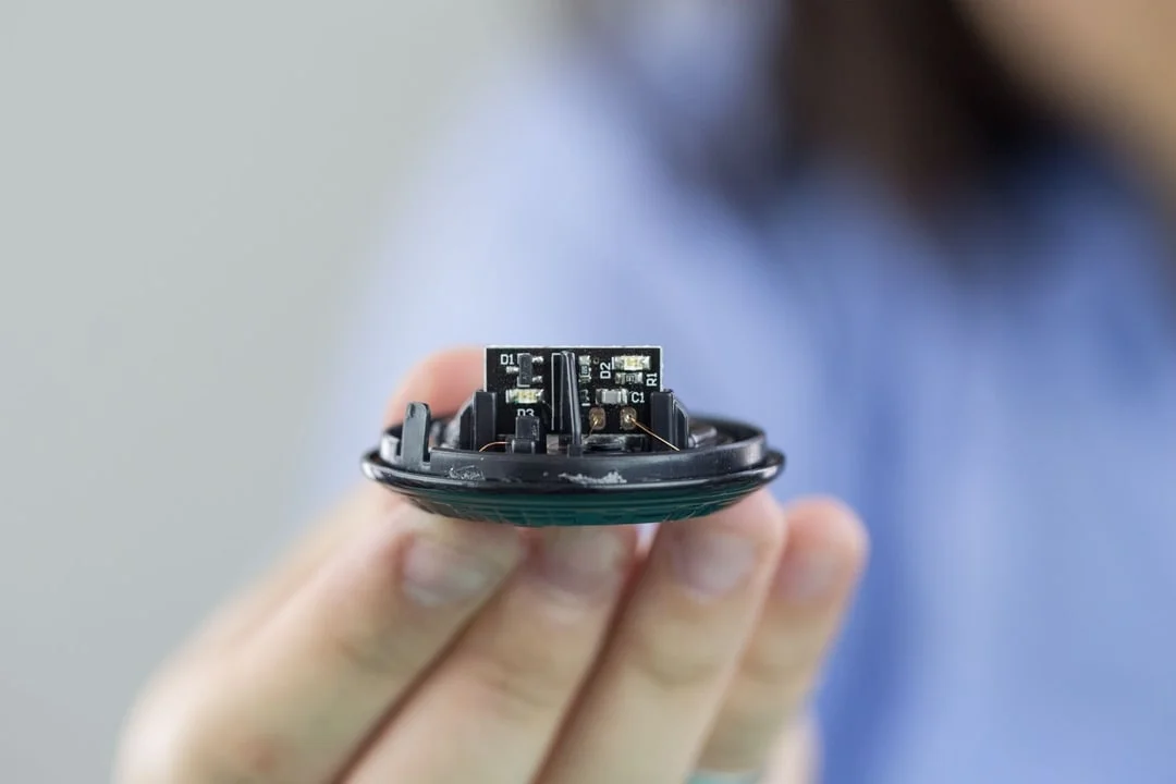

The biggest innovation in the new BB-9E Sphero droid over the original BB-8, is the introduction of inductive charging technology for the lights in the head.
![sphero bb-9e toy lights in the head inductive charging technology](https://www.fictiv.com/wp-content/uploads/2020/08/sphero-starwars-spotlight5.jpg)
Richard, who led the development of this technology, explains his inspiration to place inductive coils in BB-9E’s head:
“When I first began working at Sphero, we were exploring a different iteration of BB-8 with an in-house inductive charging solution. That project never came to fruition, but I had done all this research on a unique inductive charger,” Richard recounts. When Sphero began to work on BB-9E, it was a great opportunity to revisit this proprietary inductive charging solution. “I started playing around with it, and I had always wanted to make his eye an LED since it looks like one, so I thought I could put power in his head.”
![](https://www.fictiv.com/wp-content/uploads/2020/08/sphero-starwars-spotlight6-1.jpg)
Being a team full of creative and ambitious engineers, initial ideas for BB-9E’s technology included infrared, obstacle avoidance, and speakers in the head.
![](https://www.fictiv.com/wp-content/uploads/2020/08/sphero-starwars-spotlight3.jpg)
“Those didn’t work out since we were working against the immovable Force Friday deadline,” Richard notes, “but the lights did, since it’s a very lightweight and low-cost solution, and I proved it could be electrically efficient enough.”

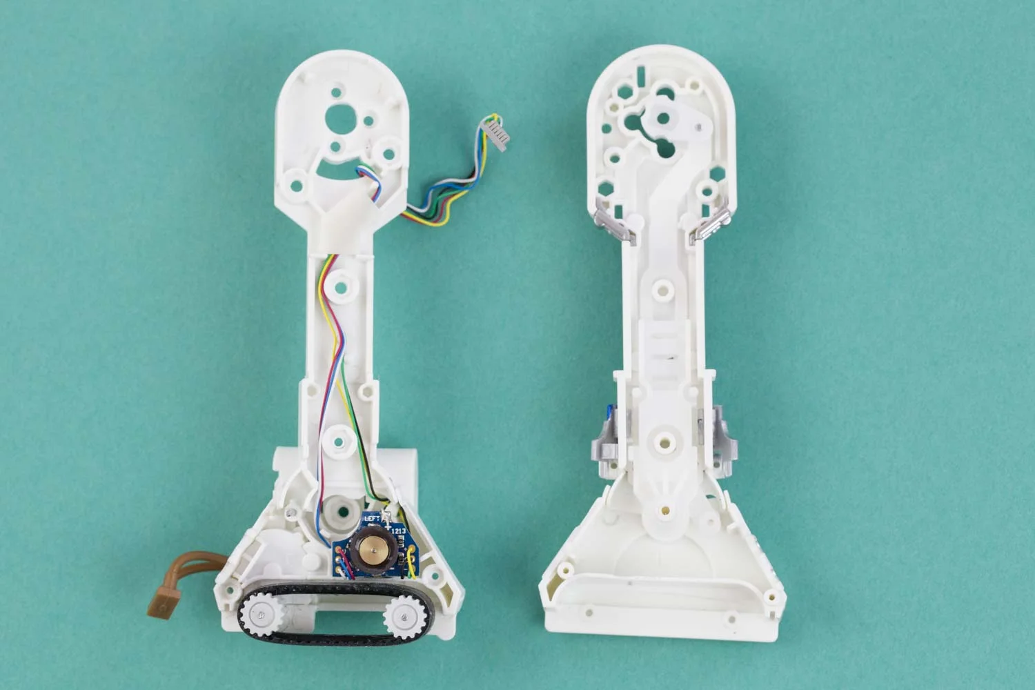

As the company’s first bipedal robot, R2 presented specific development challenges.
“It came down to the bipod-to-tripod transformation and the waddling,” notes Gus, who led mechanical development for R2-D2. “One of the biggest challenges was the mid-leg deployment—we learned people wanted to see it come all the way down, like in the movies.”
To aid in their development, they consulted an expert from the R2-D2 Builders Club to explore how they could ensure that R2’s foot wouldn’t get stuck on carpet, and what a collector would want to see in this new product. Then, the engineers examined the ankle joints and concluded that if they could isolate that motion, they’d be able to animate the waddling motion realistically in their robot.
Controlling four different degrees of movement could involve a lot of motors, but they were able to make it happen with just one.
“It all runs off of one motor connected to individual CAMS,” explains Gus. “On one end, we are in tripod mode, and each of those CAMs goes through his different positions. It was quite the challenge, with just one motor.”
![CAMs and motors inside sphero R2-D2 legs](https://www.fictiv.com/wp-content/uploads/2020/08/sphero-starwars-spotlight8.jpg)
The engineers needed to get a small motor into the robot’s foot that was powerful enough to drive him along the ground, and they also needed to find real estate for a small motor and a gearbox. The ankle box on each foot actually has gears on it, then runs back out to the belt drive, using every available millimeter.
“We have a partner we worked with to source the high-power motors, so we worked with them on the frame size, derived exactly what we needed for torque at a given speed, and then out of that we sourced a custom winding for the motor at that speed,” explains Judd. “We used common motors with a normal package size, but tuned them to our exact parameters and optimized with the custom windings.”
