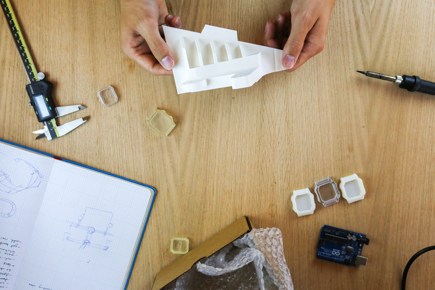

There are a ton of different tools available for prototyping hardware. But how do you know which tool is the right one at any given time?

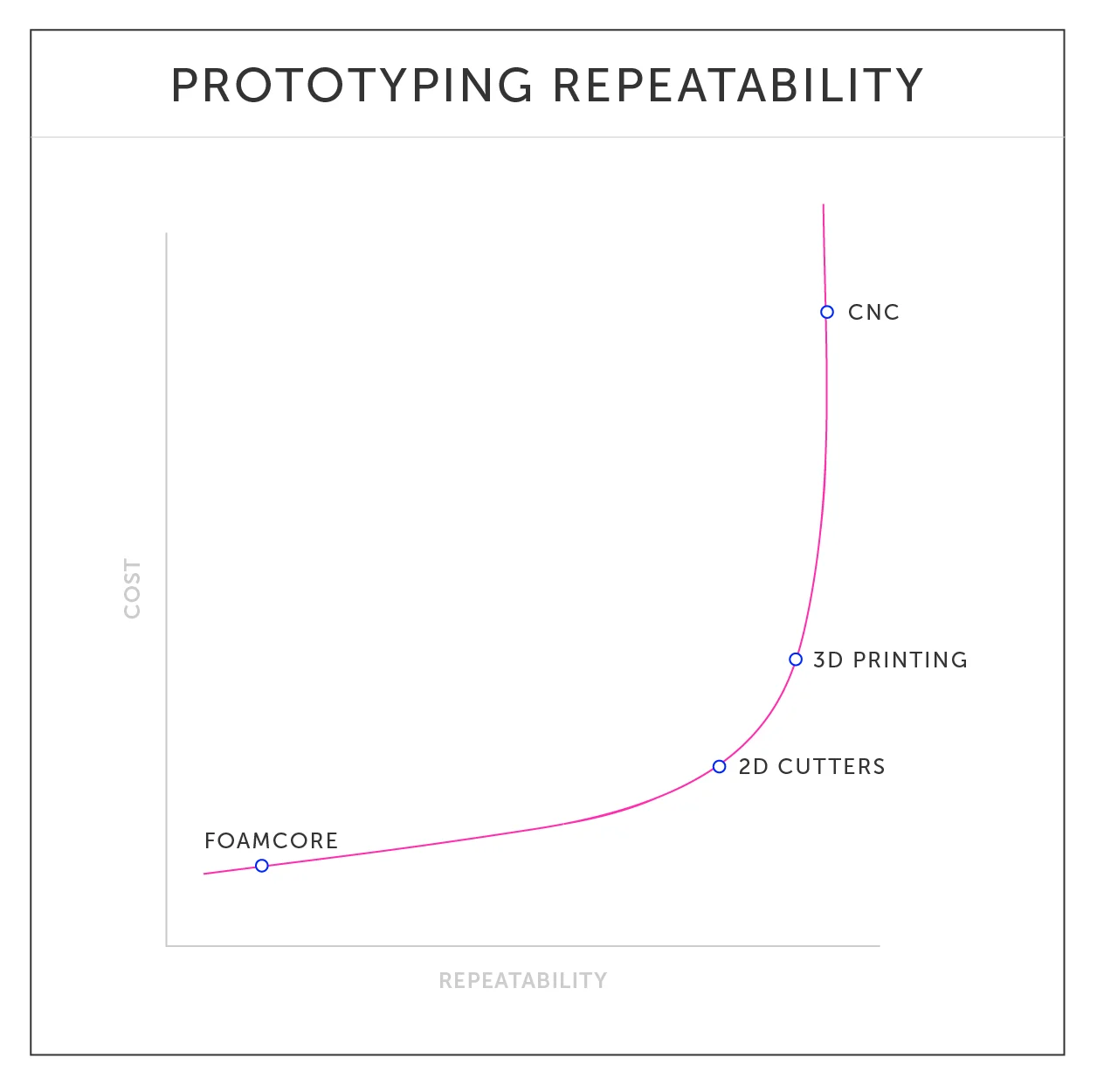

One of the main properties we look at to determine whether or not a tool is appropriate for a given design phase is repeatability. Repeatability refers to the ability of a production method to fabricate in a consistently precise way.
As you can see in the graph above, repeatability is associated with cost, so in the early design phases when you’re not concerned with consistent production, low cost tools are best. On the other hand, when you’re in the late design phases and consistent production is key, it’s time to invest in more expensive processes.
To help you choose the right tool for the job at each stage in the hardware development lifecycle, here’s what we call your “prototyping toolbox.” These are the tools you’ll reach for when you need to create a physical prototype of your design, organized by early, middle, and late design phases.

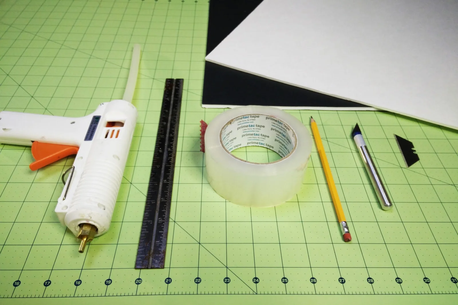

During this phase, repeatability is not a top concern. The goal is to simply make something that represents your design and its form. This can mean going down to your local dollar tree and buying up their plastic sword collection because you’re designing a life-size Iron Throne. I call this the dumb build. You’d be surprised how close you can get to your design by cutting pieces of foamcore and glueing them together.
These are all the tools you need for a foam core prototype!

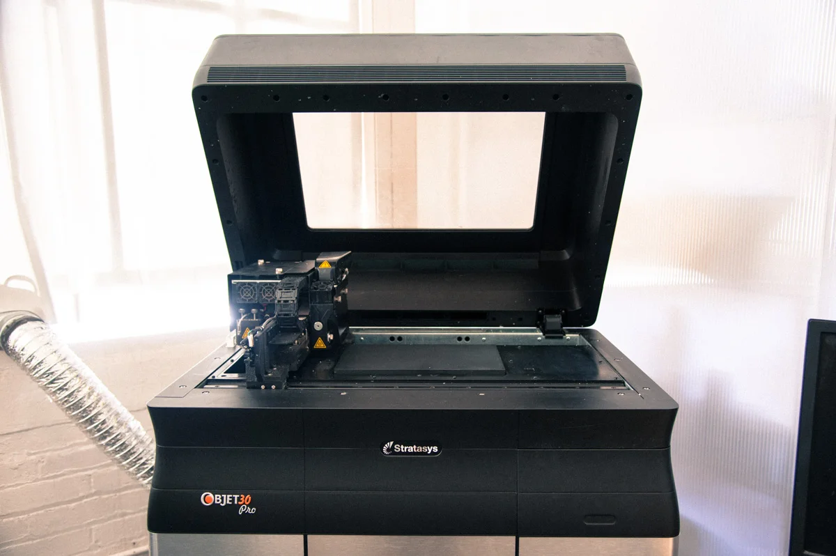

3D Printing
The entrance of 3D printing in the consumer space has allowed many people to quickly and accurately prototype their designs. It has introduced a low-cost option that’s fast and easily repeatable.
Stratasys Objet 30 3D Printer
If you’re considering the purchase of your own 3D printer, first read about the true cost of machine ownership and if you’re ready to start ordering 3D parts, head on over to fictiv.com to create an account.

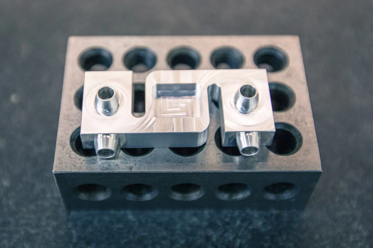

CNC, or Computer Numerical Control, machines have been used for decades to both prototype and manufacture products by hogging out a piece of material until the desired shape is achieved. They are generally used for metal parts but can also be used for wood, plastics, and composite materials.
CNC machined part
CNC machined part
CNC is probably the most expensive of all the prototyping tools mentioned in this article, but offers unparalleled repeatability and the capability of fabricating intricate metal pieces. Because it’s the only way to manufacture a lot of designs, using this method for a prototype may come earlier in the design phase as well.
