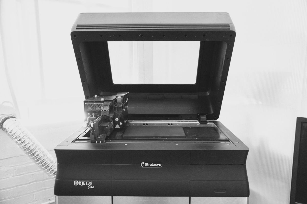

The four core 3D printing technologies can be ranked as follows, by level of resolution, which is really the physical height of each layer of material the printer lays down:
  • PolyJet: 16-micron layer resolution
  • SLA (stereolithography): 25-200 micron layer resolution
  • SLS (selective laser sintering): 60-150 micron layer resolution
  • FDM (fused deposition modeling): 50-300 micron layer resolution
You need to be clear on the purpose of 3D printing for your organization and then choose the quality that corresponds to your needs.

Once you’ve established which type of printer you should purchase, you need to consider the maintenance requirements of that machine.
3D printers require real expertise, especially the higher-end machines. They’re finely tuned performance engines that not just anyone can operate; when it comes to printer operation, the area where I see the greatest lack of expertise and attention to detail is maintenance.
Over time, any printer will start to degrade, like anything with moving parts. The print heads, the build bed, the pumps inside the printer—all those parts and pieces need to be cleaned on a regular basis.
