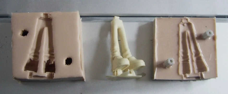

Creating molds was once a two-week process but now can takes less than two days. First, a master part must be created, with the exact geometry of the final parts. In the past, the part was CNC milled, but now the master can be 3D printed. Then, RTV (room temperature vulcanizing—curing without being heated) silicone is poured around the master part and allowed to harden. Finally, the silicone mold is cut into an A and B side, the master is removed, and voila! A mold.
The biggest advantage of this method is that the silicone mold can be reused many times, so urethane casting is used for low-volume production, too. And with all the available urethane compounds, you have a virtually unlimited selection of properties, such as durometer and temperature use.

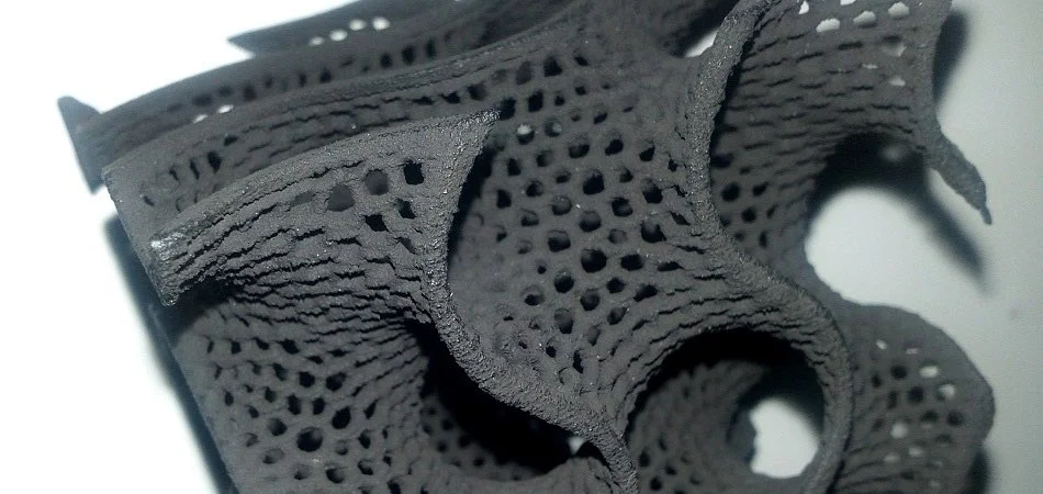

The older method of simulating rubber used selective laser sintering (SLS) with a flexible base, which resulted in an elastic part. However, the parts are still quite stiff, have low stretch, break after repeated flexure, and have a low resolution finish—not ideal for many prototypes. Until recently, this was the best that could be hoped for, but newer materials are making their way into the market.

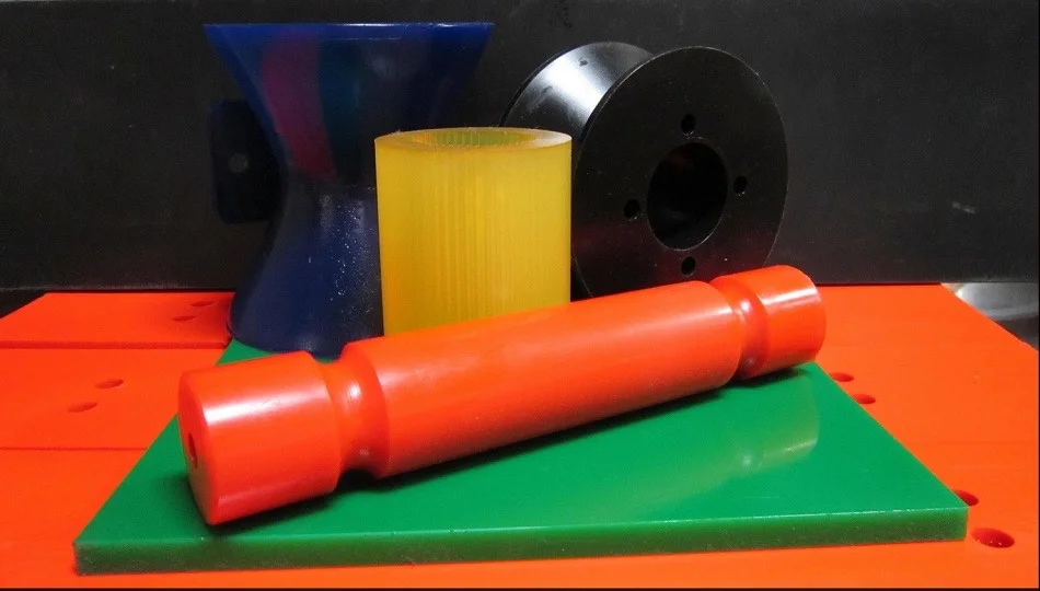

With the requirement of a master part, mold creation, and finally casting the prototype, cast urethane is a costly option, but it’s unparalleled if you’re looking to create many prototype parts. Milling is rarely recommended, but reasonable for low-detail parts in very hard rubbers.
