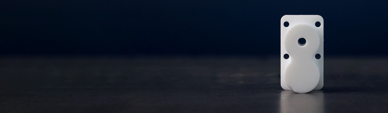

PTFE

Commonly known as Teflon, PTFE resists high temperatures and chemicals/solvents excellently in and is also a great insulator. It is also a very slippery plastic, which makes it a good material for low-friction applications such as bearings.

PTFE comes in an opaque white or black color and has a slippery surface texture. In addition to its overall texture, many different surface finishes can be achieved during machining.
