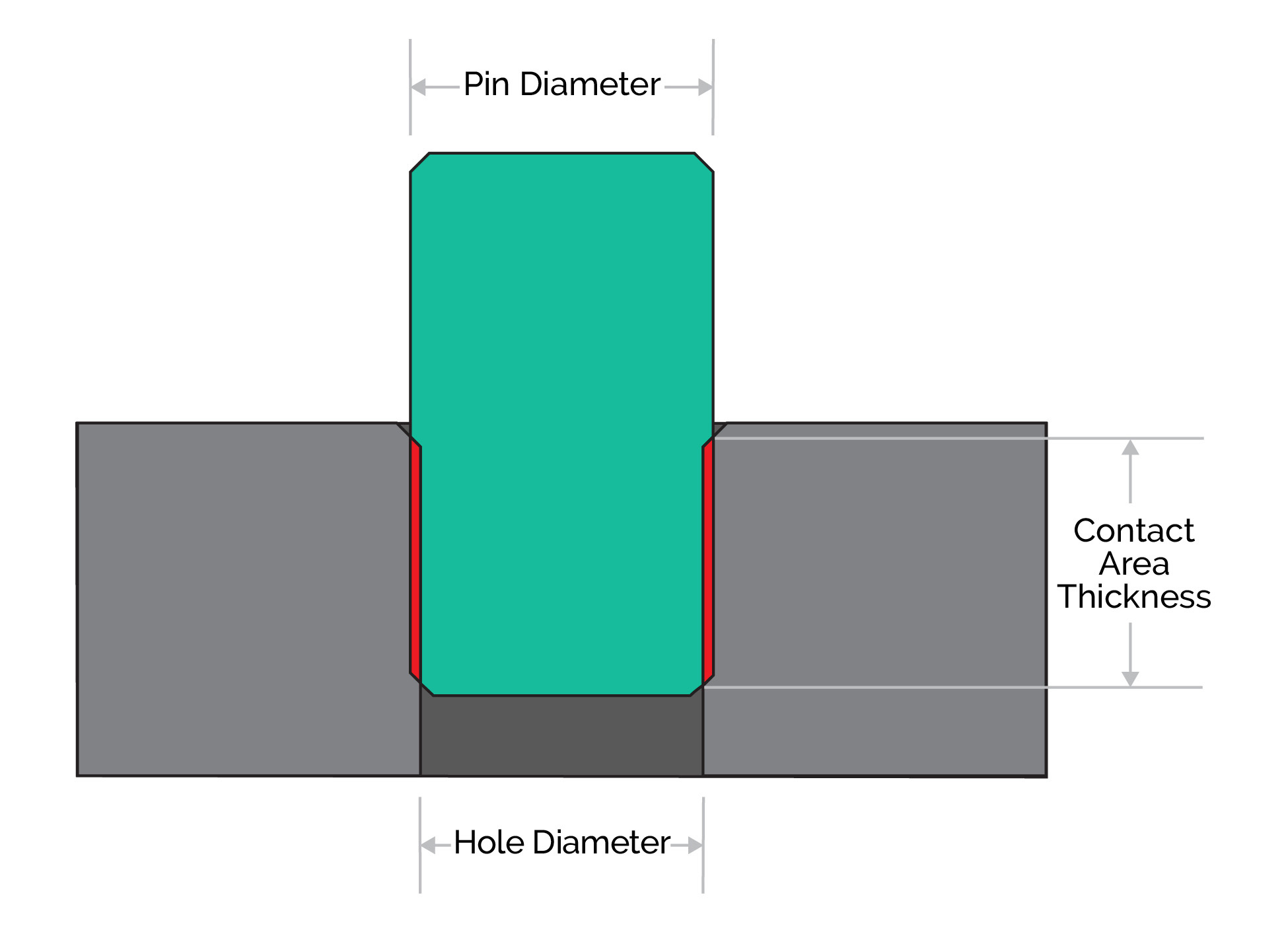

This press fit calculator calculates the amount of mechanical force based on pressure induced due to interference fit of a pin and hole assembly
This formula assumes solid pins into holes with very thick walls (such as in large plates of block). The formulas used and results are listed below:
Calculated Value Reference Formula Result Units
Radial Interference formula radial interference mm
Contact Area formula radial interference   mm2
Axial Force formula radial interference   N
Pressure formula pressure   Mpa
