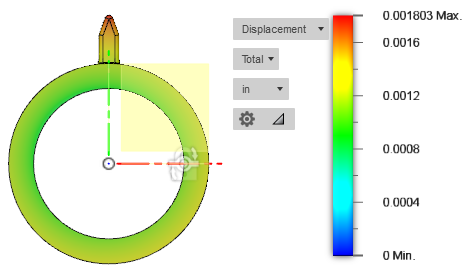

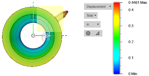

This article will review methods to improve a design’s torsional rigidity. Torsional rigidity is the object’s torsional resistance to twisting as a torque is applied to the component and is dependent on a components geometry. As torsional rigidity increases, the torque required to produce a twist of one-unit angular measurement per one unit length of the shaft, increases. In reference to the previous drive shaft example, if the shaft is twisted too much, unstable performance may result, so choosing a shaft with higher torsional rigidity would result in a more stable mechanical interface. The images below show two shafts that each have 100 ft-lbs of torque acting on them, but their deflection will be different because they have different torsional rigidities.
There is a small “flag” modeled on the outside of the shaft to give a visual of the feature twisting as the torque is applied. The design on the left (Steel) is has a higher torsional rigidity and therefore lower stress than the design on right (HDPE). The next section will walk through the properties that make this possible.

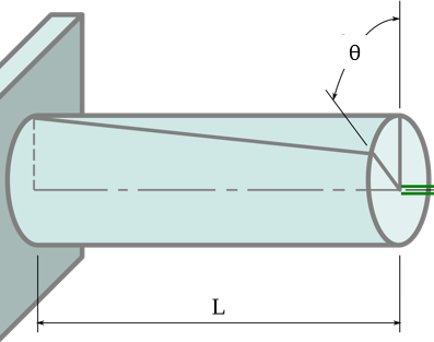

The material properties provide a good foundation to determine the torsional rigidity a component. The angle of twist (θ) in radians, where JG is the torsional rigidity, is given by the following equation:
Where:
- T = Torque applied to the component
- L = Length of the component
- J = Polar Moment of Inertia (Torsion Formula Constant)
- G = Shear Modulus (Modulus of Rigidity)
The image below depicts the angle of twist:

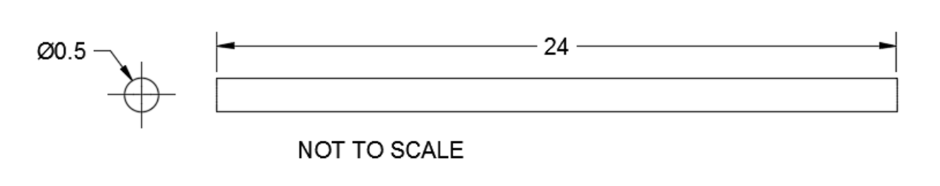

This section will provide examples of how to solve for polar moment of inertia, shear modulus or modulus of rigidity, stiffness, and angle of twist. The equations will start with a simple solid circular shaft, for simplicity’s sake.

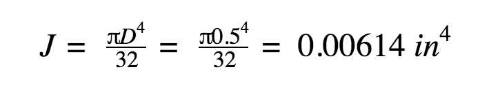

Starting with a shaft that has the following geometry:
Calculating the polar moment of inertia for the defined shaft:
For the purposes of this analysis, the shaft material is aluminum. Aluminum has an elastic modulus of about 10e6 psi and a Poisson’s ratio of 0.33. Calculating the shear modulus or modulus of rigidity gives:

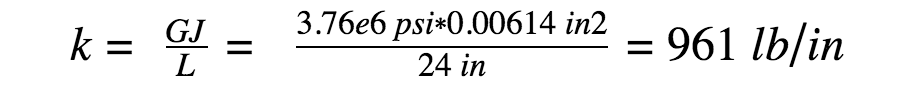

Solving for torsional rigidity or stiffness, gives:
Finally, solving for the radial torsional deflection (angle of twist) with an applied load of 200 in-lb gives:
Changing the material to steel will increase the torsional stiffness by a factor of three. This results one-third of the deflection, or 0.07 rad, for the same applied load. For a situation where the design is very sensitive to positional accuracy, going with a material that has a higher torsional rigidity or stiffness will be beneficial.
If a greater increase in stiffness is needed than can be obtained from a material change alone, increasing the polar moment of inertia will also improve the design. As an example, going from 0.5” to 0.75” brings the polar moment of inertia from 0.00614 in4 all the way up to 0.0311 in4. That means we’re making the part five times as rigid, with only a 50% increase in diameter.
