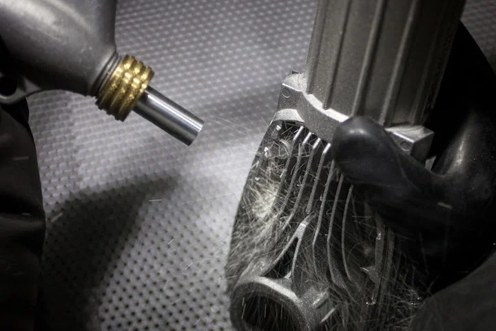

Bead blasting is a mechanical process used to create a desired surface finish or surface texture on parts, whether they are urethane cast, CNC machined, 3D printed, or injection molded. The process of bead blasting is carried out with a machine that propels a stream of media at high speeds onto the part surfaces using compressed air. Typically, an operator directs the flow of media on the part, and parts can be masked so certain surfaces are not impacted by the bead blasting. The resulting finish is controlled by the size and shape of the media, the pressure of the air, and the angle of the nozzle to the part.Â
Bead blasting, or blasting, is also called media blasting because it can use a variety of different media depending on your end goal. Media blasting is typically called out as the name of its media as well — for example, sand blasting, walnut shell blasting, and glass bead blasting.
The process is similar no matter what kind of media is used, and depending on the media, it affects the surface in different ways. Aluminum oxide sandblasting is highly abrasive and can easily strip paint, while shot peening — which utilizes small metal “shot” — results in a work hardened surface that is stronger and more resistant to cracks, fatigue, and corrosion.

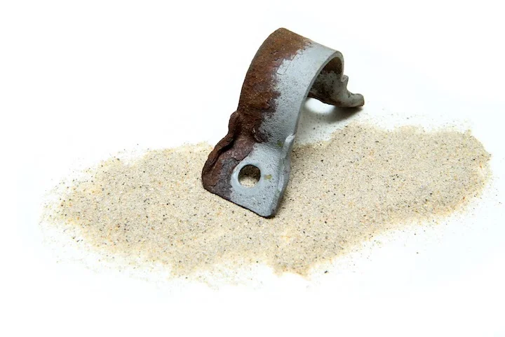

![bead blasting on half of a part shows the impact on rust removal](https://www.fictiv.com/wp-content/uploads/2023/01/bead-blasting-on-half-of-a-part-shows-the-impact-on-rust-removal.jpeg)
Bead blasting is used to quickly remove coatings or corrosion, clean up cosmetic defects, prepare surfaces for coatings, deburr surfaces, modify machined surface finishes, and improve the uniformity of surfaces for cosmetic and mechanical needs. For example, the machining marks from an end-mill can leave unsightly swirl tool marks with scratches and nicks. By bead blasting the surface, you can achieve a satin-like surface that covers up the imperfections and leaves a clean and professional aesthetic finish.

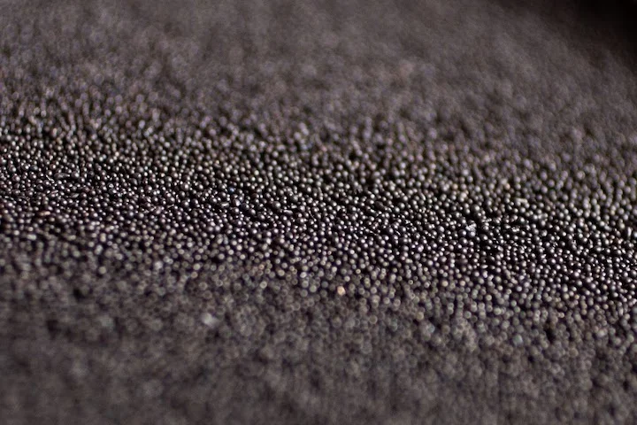

Glass Beads
Glass beads are spherical beads typically manufactured from lead-free, soda-lime glass which allows for non-aggressive cleaning and micro-peening to create a bright satin finish. Glass beads come in a variety of grain sizes depending upon the starting condition of the part, and the aggressiveness required to achieve the desired finish. Glass beads are easy to re-use and can be recycled.

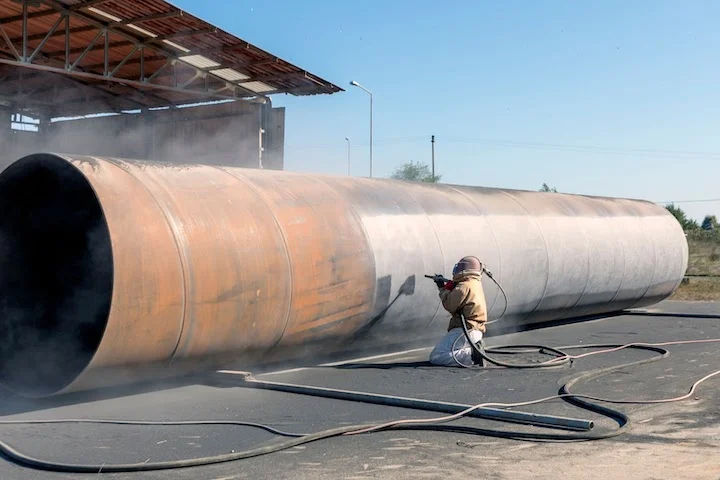

Sand
The typical sandblasting material is small particles of aluminum oxide, which have sharp and angular edges that result in an aggressive material removal. Sandblasting is typically aggressive enough to cause dimensional distortion and material removal, if you’re not careful. This method is typically used to remove contaminants embedded in surfaces, corrosion, paint, and other coatings, and make as-machined surfaces uniform. Sand media is also highly recyclable, though contamination in the media is common due to the high material removal rate.
Pro-Tip: Don’t allow cross-contamination of media for different metal families. For example, do not use media that came into contact with stainless steel on aluminum parts and vice-versa. Cross-contamination may cause issues such as intergranular corrosion, issues with plating adhesion, or loss of integrity in metal joining practices such as welding or brazing.

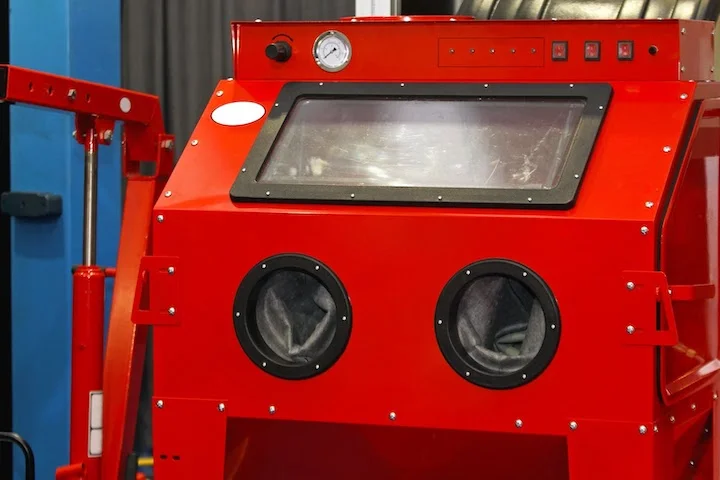

Equipment
![bead blasting cabinet](https://www.fictiv.com/wp-content/uploads/2023/01/bead-blasting-cabinet.jpeg)
The equipment required for blasting is fairly straightforward. In the most simple set up, you need an air compressor to provide the high-pressure air to shoot the media and a nozzle to direct the media at the part. Other items can improve the process, such as a blast cabinet to contain the blast media and moisture traps to remove water that can contaminate the media.
Personal protective equipment (PPE) is essential for operators, as the media can easily remove skin or get into your nose, eyes, and lungs. A respirator, gloves, safety goggles, and thick clothing are the minimum protection necessary to prevent short and long term health issues.

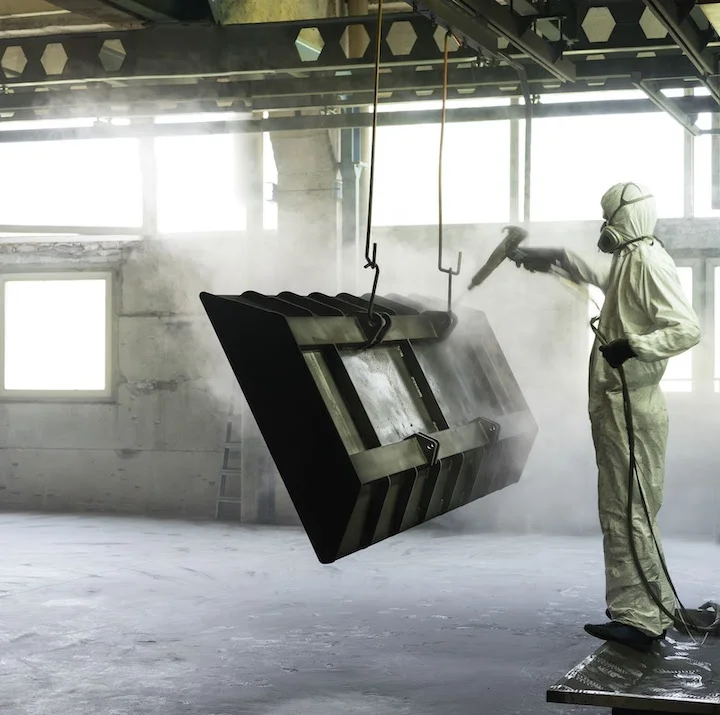

![abrasive blasting for an industrial cleaning application](https://www.fictiv.com/wp-content/uploads/2023/01/abrasive-blasting-for-an-industrial-cleaning-application.jpeg)
There are a wide range of uses for a bead blasting finish, and the most common ones are listed below:

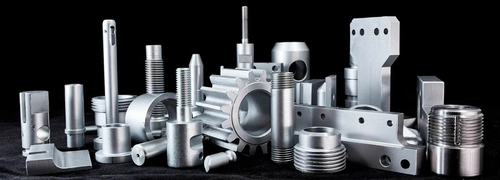

The pros for bead blasting typically outweigh the cons. Bead blasting is a relatively cheap and fast process that removes minimal material, the media can be re-used quite a few times before needing to be replaced (depending on the media), it’s eco-friendly, and can cover a large surface area very efficiently. And bead blasting is ideal for a wide variety of materials, including aluminum, steel, titanium, brass, copper, and various plastics.
On the other hand, bead blasting relies on access to the material via line-of-sight, which means it has a tough time fully covering highly detailed parts with small pockets, internal cavities, and undercut features. Also, if your product has tight tolerances, the material removal can cause dimensional issues. So, it’s a good idea to analyze your part’s tolerances using our free Tolerance Analysis Calculator before blasting. It’s also advisable to mask threaded features to avoid compromising the thread profile.
![industrial parts with a smooth finish](https://www.fictiv.com/wp-content/uploads/2023/01/industrial-parts-with-a-smooth-finish.jpeg)
For products requiring repeatable finishes, a skilled operator, special fixturing jigs, or automated systems may also be required — and there are different techniques and media choices, which means using a trial-and-error process to figure out your finish can get expensive. It’s better to contact an expert, like those at Fictiv, to develop and recommend solutions for your particular application quickly and efficiently.
