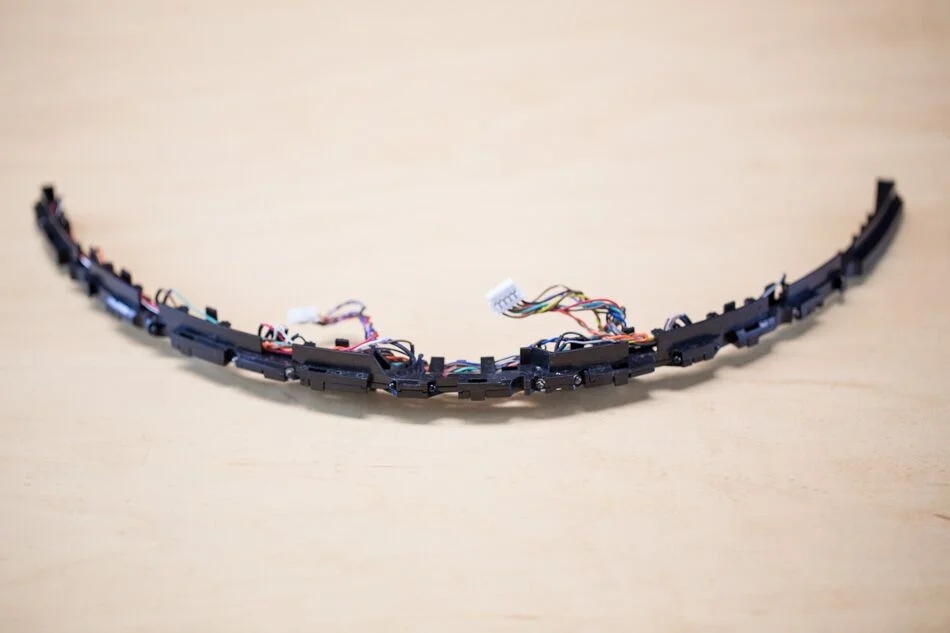

There are also wall sensors, which are IR LED-receiver pairs that allow the Roomba to “see” walls and furniture. The navigation algorithm uses the signals from these sensors to follow walls closely without touching them. Sometimes, Roomba will slow down before coming in light contact with objects—that’s thanks to these sensors as well. There are six of these pairs, neatly mounted onto a subassembly bracket.

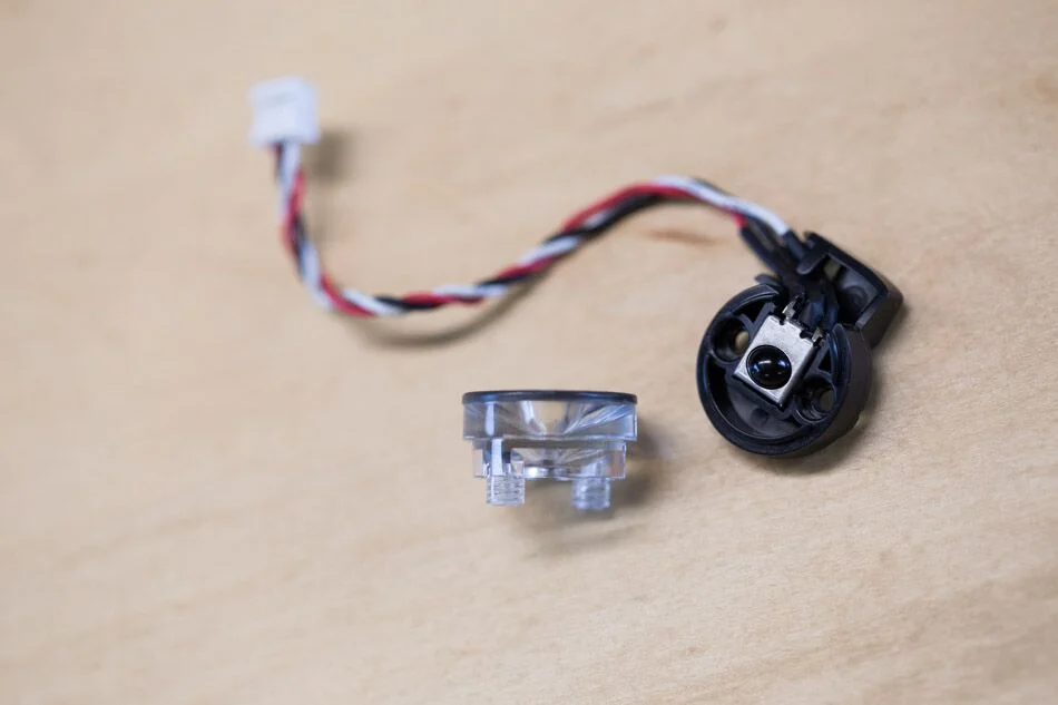

Last but not least is an IR sensor on top of the Roomba, which helps the Roomba “see” far ahead, to identify the locations of lighthouse accessories and the charging dock. The light guide covering the IR sensor is super cool — it can detect light coming from all 360 degrees.

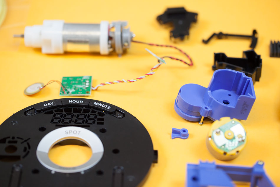

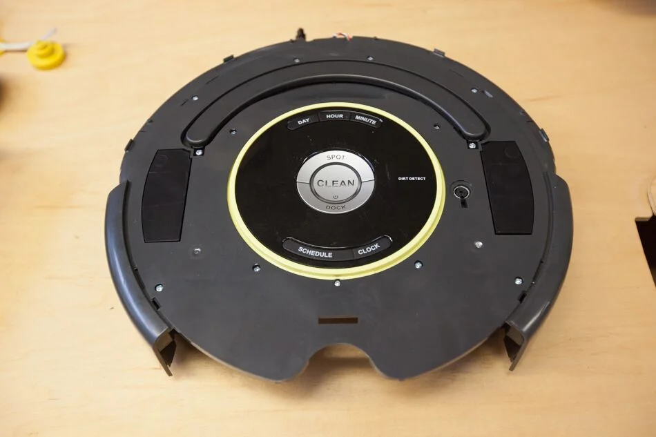

We still haven’t found the Roomba’s brain, after all this time. We rip the ugly beige faceplate off, which is held on by snaps. Underneath…more screw fasteners!
![](https://www.fictiv.com/wp-content/uploads/2020/07/pasted-image-0-2-1.png)
While unscrewing the faceplate, we felt what we thought were stripped screws. Turns out, a few screw bosses underneath the top cover have broken off. Judging by the damage, this is not evidence of user abuse; it’s more likely that the assembly workers over-torqued the screws during assembly. Remember, on an assembly line, powered torque screwdrivers are your friend!
![](https://www.fictiv.com/wp-content/uploads/2020/07/pasted-image-0-3-1.png)

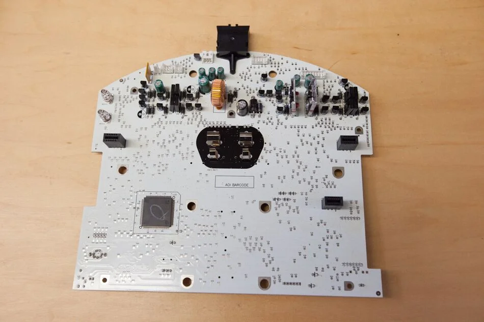

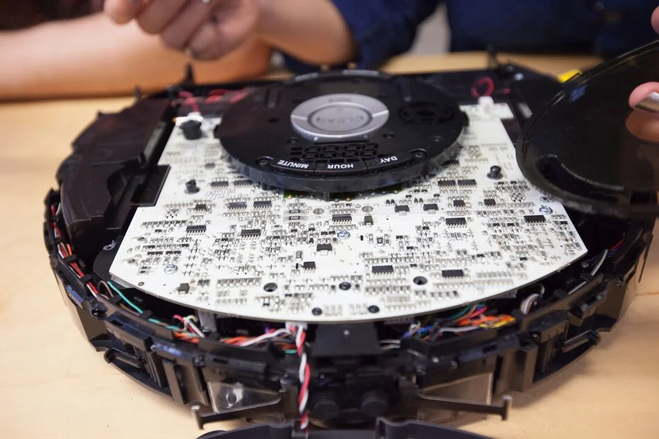

Finally, we have sighting of the main PCBA, the brain of the Roomba!
![](https://www.fictiv.com/wp-content/uploads/2020/07/pasted-image-0-4-1.png)

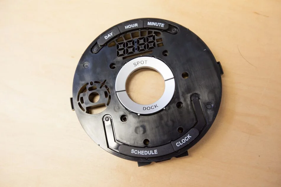

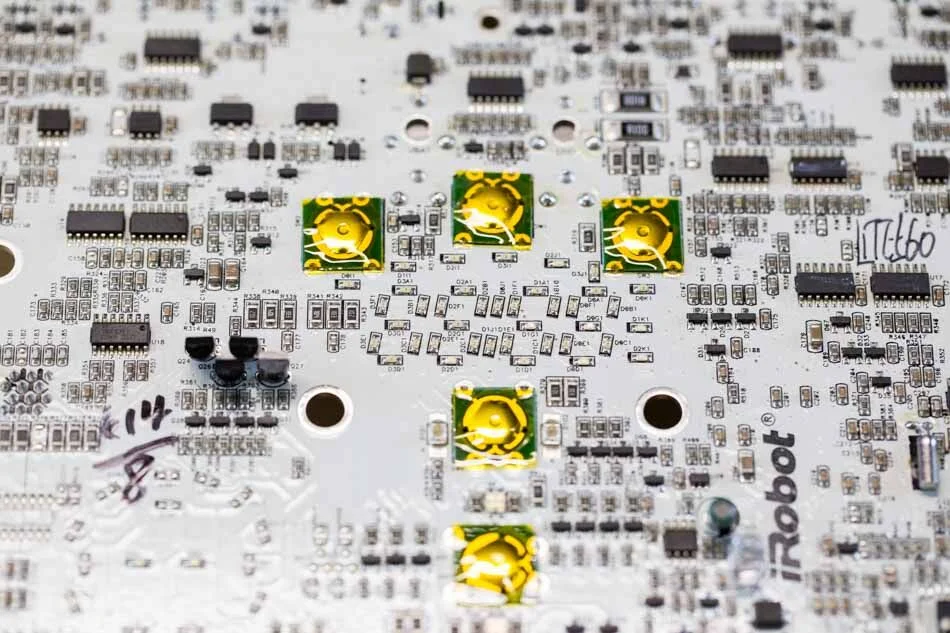

What are those “8”s on the button console? The Roomba doesn’t have an LCD-display, like we thought…
![](https://www.fictiv.com/wp-content/uploads/2020/07/pasted-image-0-5.png)
The “display” effect is created with clever placement and masking of onboard LEDs! This is certainly a creative way to cut BOM cost.
![](https://www.fictiv.com/wp-content/uploads/2020/07/pasted-image-0-6.png)
On the reverse side of the board, we find some big capacitors, a huge inductor, and a very large microprocessor. In addition, we finally see the edge connector receptacles and spring contacts in their entirety. They are surface soldered to the main PCBA. The lack of peripheral boards and wires make this assembly so clean and elegant.
![](https://www.fictiv.com/wp-content/uploads/2020/07/pasted-image-0-7.png)
