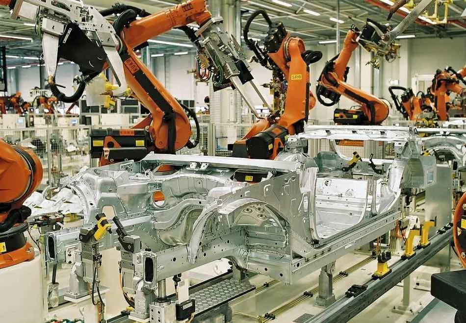

Manufacturing is all about efficiency. This is achieved through specialization—the more dedicated a tool or process is, the better and faster it generally is. Generally speaking, versatility comes at the cost of specialization. Humans, being very versatile creatures, are usually not the best factory workers: We take time to train; we’re slow; we need breaks; and we make mistakes. That’s why we turn to customized machinery to replace human labor—it’s overwhelmingly faster, more precise, and longer-lasting.
automotive plant
Highly automated automotive plant (source)

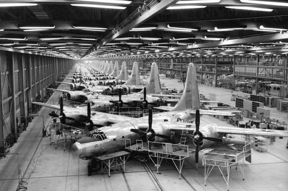

Of course, creating dedicated tooling and machinery requires up-front human labor. The cost of custom tooling must be weighed against its long-term gains. This is why it can be useful to amortize tooling cost into a “piece price” (price per unit) in the pursuit of calculating the time it takes to achieve ROI (return on investment). Naturally, production volumes are central to this equation—if you’re going to crank out millions of widgets a year, your customized tooling will pay for itself. This is common in the automotive industry. On the other hand, manual manufacturing processes can make more sense than customized tooling for low-volume production. For example, sailboat and airplanes are largely assembled by hand. These are all commercial decisions driven by the free market. Designers and engineers must have their company’s financial abilities and expectations clearly communicated, so that they’re able to make prudent manufacturing decisions.

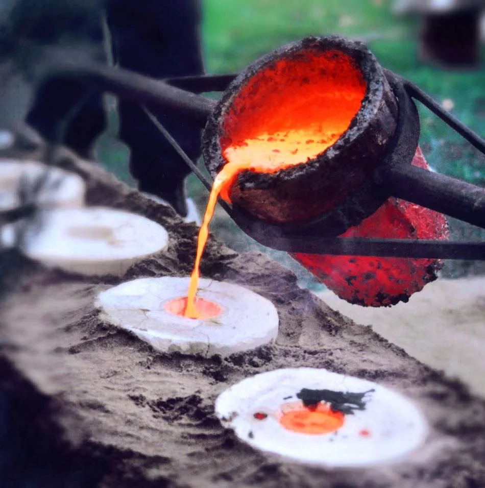

Casting involves the liquid pouring or injection of hot materials into a mold. This process is often used for making very complex shapes. Casting creates a “rough” shape and is a somewhat imprecise process. That’s OK, though, because precision is not always needed. Casting is a versatile process that can produce many different materials, from metals to plastic. This method is extremely popular and is used everywhere from automotive housings (transmission, engine, etc.) to toys. Molds and their associated tooling are expensive and complex; they’re often the best method to achieving many general, three-dimensional shapes with a larger volume/surface area ratio.

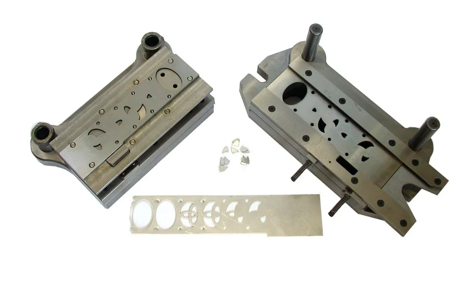

Sheet metal forming, a sub-process of cold-forming (as opposed to the hot-forming of casting) is a process used to create thin metal enclosures that don’t need to be pretty or watertight. For thin, complex shapes, forming makes more sense than casting because of the difficulty of forcing a molten material around tight corners and into long, thin channels. It also takes much less energy to deform a thin piece of metal than it does to melt the metal into a liquid state. Stamping is a forming process that uses dies under massive load to crush metal into a desired shape, and is extremely common for automotive outer parts (hood, door panels, etc.). Electrical boxes are made by stamping a blanket sheet to add cuts and holes, and then bending to form the box into its final shape.

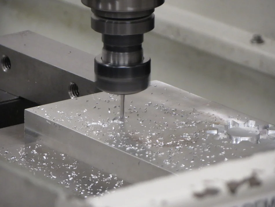

Machining, whether CNC or manual, is the process of removing material from an object, usually with rotating cutters or drills. The machining process can achieve extreme precision and is often used to place accurate holes and make smooth, flat planes. The more axes (no lumberjack) of a CNC machine, the more versatility it has. Machining is an expensive process and should only be used when the necessary precision (location, size, surface finish) of features cannot be achieved any other way. EDM is another machining method that removes material via electrical discharge (sparks). It’s great for extremely small, delicate features that a cutting tool would have difficulty achieving. However, EDM is also slow and expensive.
