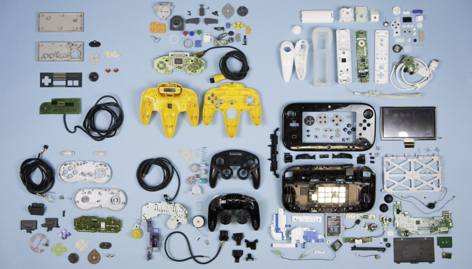

In Part 1 of this teardown, we ventured inside 3 of Nintendo’s first controllers: the NES, Super Nintendo, and (our favorite) the N64. Now we’re making our way towards the present with Part 2, looking at the Gamecube, Wii Mote and finally the latest Wii U Gamepad.
(Honorable mentions go out to the Virtual Boy controller and the Power Glove, which didn’t make it into this teardown as some of Nintendo’s more… eccentric ideas.)
At the end of Part 1, we saw huge leaps on both the design and engineering fronts from the Super Nintendo controller to the N64 so let’s see how these next 3 controllers stack up.
