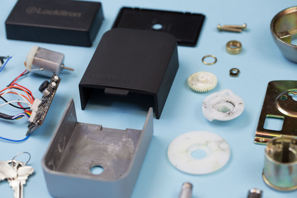

We removed the backplate to find the gear train that turns the deadbolt latch.
![](https://www.fictiv.com/wp-content/uploads/2020/09/db6.jpg)
The “cross” you see in the photo is the backside of the thumb turn. The tailpiece that comes out of the outside cylinder goes through the a similar cross on the deadbolt latch and inserts into this cross.
![](https://www.fictiv.com/wp-content/uploads/2020/09/db7.png)
When Bolt sets out to open the door, the DC motor spins to set off the unlock motion. The worm gear attached to the motor shaft drives a reduction gear, which in turn rotates the big gear.
![](https://www.fictiv.com/wp-content/uploads/2020/09/db8.jpg)
The big gear and the switch pusher are concentric, but they’re not both mounted to the thumb turn shaft—only the switch pusher is. Opposing leaf springs slotted into the big gear snugly pinch an almond-shaped boss on the switch pusher.
![](https://www.fictiv.com/wp-content/uploads/2020/09/db9.png)
When the motor sets the gear train in motion, the big gear takes switch pusher and thumb turn for a spin. However, when you manually rotate the thumb turn from the inside, the switch pusher’s square corners overpower the leaf springs to open/close the latch. The big gear and reduction gear don’t move at all when this happens.
![](https://www.fictiv.com/wp-content/uploads/2020/09/db10.gif)
Remember, the worm gear cannot be back-driven, so without this clever mechanism, you wouldn’t be able to open or close the door manually.

Lockitron Bolt has a lot of moving parts; however, lock components like the cylinder assembly, cylinder cover, and deadbolt are all off the shelf, sourced from conventional lock manufacturers.
The fewer custom parts you need, the less you have to pay for tooling. For a new product with low production volume, it makes sense to go mostly off the shelf and make as few custom parts as possible.
There are just ten custom parts in Bolt:
- ABS main housing
- ABS battery cover
- Delrin switch pusher
- Delrin worm gear
- Delrin big gear
- Hytrel reduction gear
- Cast aluminum housing
- Cast aluminum thumb turn
- Stamped steel mounting plate
- PCBA
Parts 1-6 are all injection molded.
The gears are helical and made with twist-off molds, which is more expensive than conventional straight-pull molds. However, this is the only way to mass-produce helical gears, which makes the gear train quieter.
![](https://www.fictiv.com/wp-content/uploads/2020/09/db15.png)
On the other hand, the main housing and battery cover pieces are much simpler. Although the parts are large, they are simple and require few side-actions. The battery cover is a cosmetic component, and it gets a special coat of soft touch paint.
The cast aluminum parts are finished with CNC machining, bead blasting, and anodizing.
The steel mounting plate has a yellow zinc coating, also known as zinc-chromate conversion coating. This adds corrosion resistance and is ubiquitous in home hardware.
