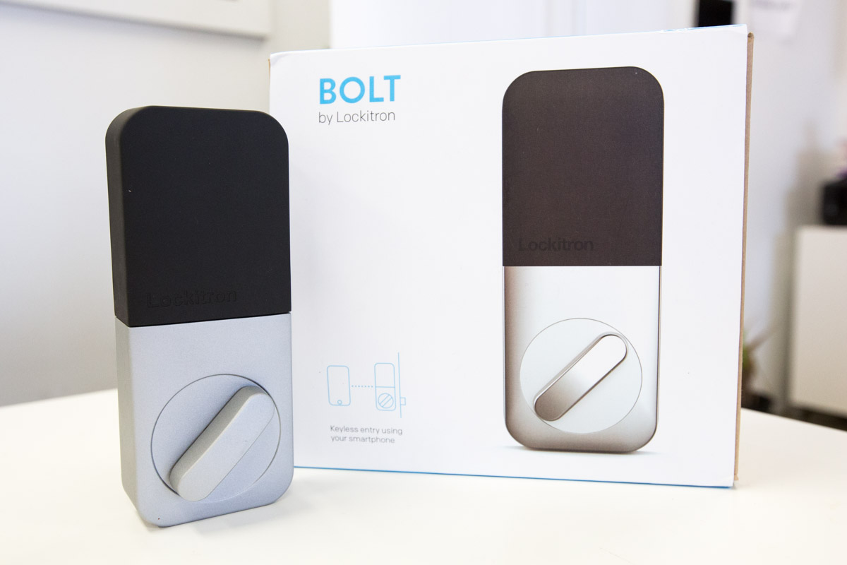

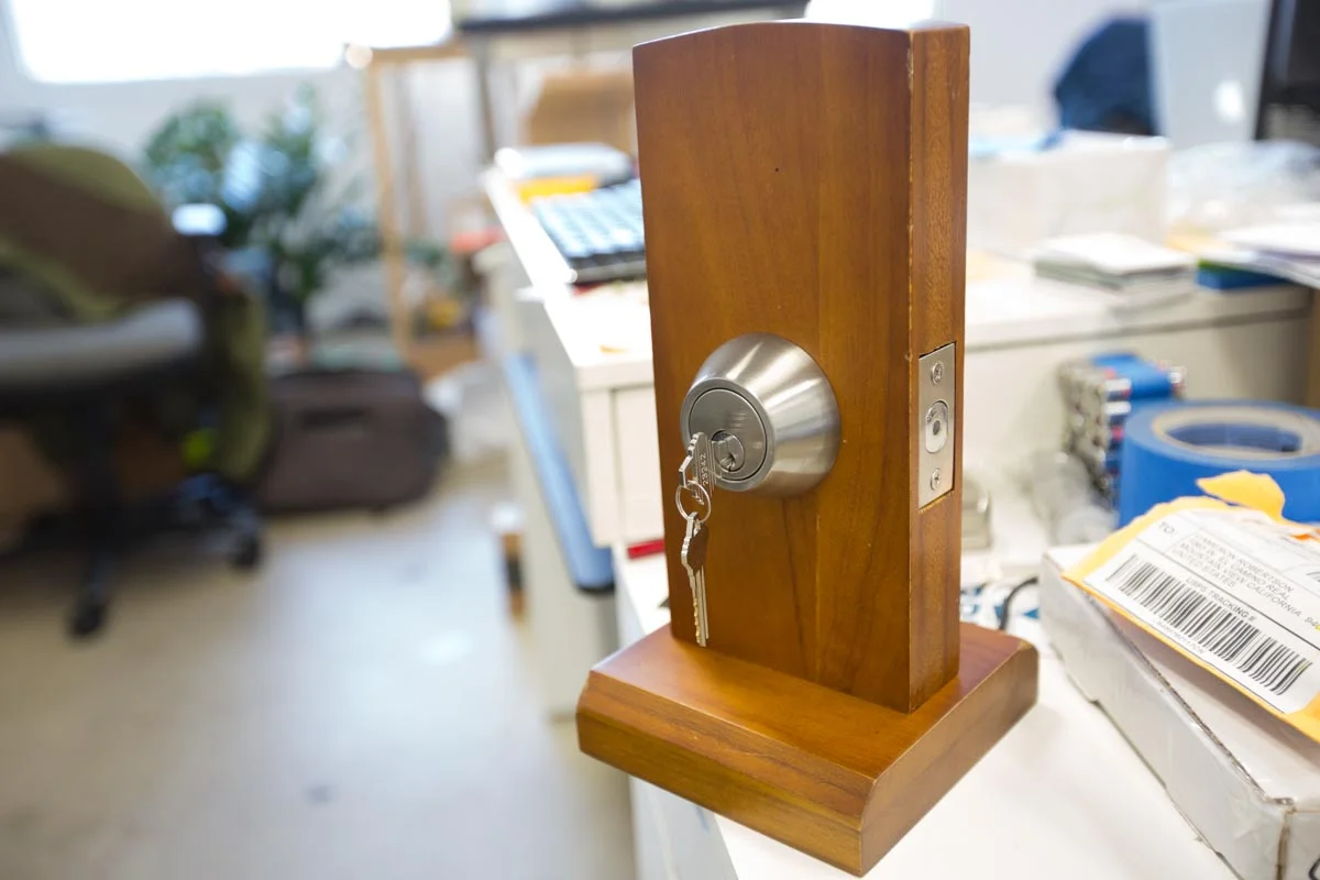

Their eye on “better,” Lockitron based Bolt on the same mechanical platform as their V1 product, and dropped all of the mechanics from V2. They designed a full replacement lock that replaces the outside and the inside mechanism, but still fits within that standard door hole. Mechanically, this approach made Bolt smaller and a lot simpler than its predecessor because “you’re working with a known set of restraints,” explains Paul. “We got rid of the knock sensor and put the Wi-Fi onto an external device we call ‘Bridge’ that plugs into the wall.”
Bolt’s design is not only appealing, it’s highly functional: the top half of the device is black plastic to give the Bluetooth radio frequency better signal strength (metal cuts the range down). Bluetooth stayed in the new design because it’s built into smartphones.
Another detail other smart lock manufacturers typically overlook are the internal gears. You may not see them, but they do have an impact on the customer experience: you may not want to actually hear your door mechanism whirring itself locked. Traditional plastic gears are made with delrin polymer, but Lockitron opted for a polymer called hytrel, which is a softer plastic. In addition, the teeth of the gears are not straight up-and-down vertical, they’re angled ever so slightly in a helical design, which is incredibly challenging to tool. But those two factors make the gears significantly quieter; so much so that Paul says with complete confidence, “We have the quietest gears on the market.”

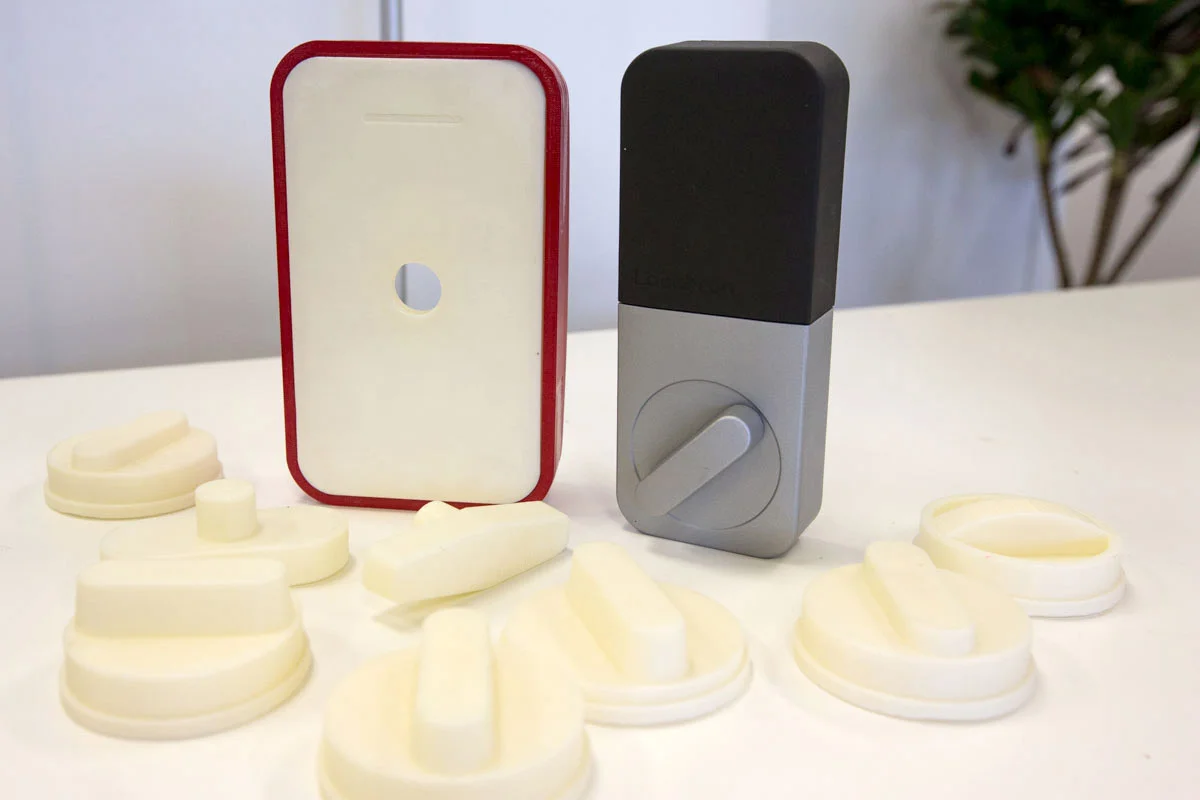

As for the knob, that ubiquitous functionality, that part of the lock with which we come into direct physical contact the most—and which you’ll also notice in the company’s logo—Lockitron went through a total of sixty designs. “We used 3D printing for figuring out the best knob ergonomics. For those tactile parts of a product, it’s not good enough to sketch it out. You gotta feel it. 3D printing is critical for rapid iterations, and enabled us to go through 20 designs in a single day. So we finalized the knob design within a week.”

“We went from 50 custom-made parts to 10,” says Paul. “Simplicity is great for two things: expense and reliability.”
