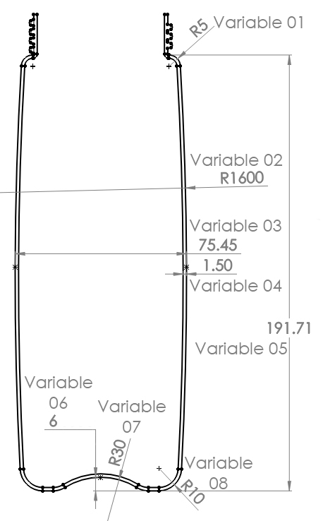

Tip #5: Think of Each Prototype as an Experiment
Most people design a product, and when they think the design is “ready,” they have a prototype made. It’s important to note that a given design is actually a combination of many variables—if you aren’t sure what I mean by variables, I urge you to consider every dimension you used in your design as its own variable. All together, they make up your design.
When you prototype revision 01 of your part or product, what you’re really doing is testing whether the current combination of variables works or doesn’t work. Due to the fact that there are a lot of variables in your design, and you’re just testing whether the combination works or doesn’t work, you’re likely setting yourself up for failure. Chances are high that the combination will not meet ALL of your requirements—worse yet, it may not be obvious which variables/dimensions need to be adjusted or by how much.
You have to make your best guess at adjusting those variables/dimensions, before you can make another prototype and see if that revision completely solves your problem or not. Odds are that the changes get you closer to your goal, but still don’t completely solve your problem.
