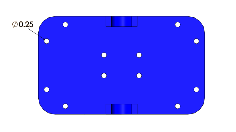

A 3D printed part with 0.25″ mounting holes
  • You have a 3D printed part with a dozen 0.25” mounting holes (see images above for reference). 200 parts need to be shipped out within 1 week.
  • It takes 1 person 6 minutes to drill out all of the holes on the part so that the fasteners fit properly. To get the parts ready by the end of the week, the person will need to spend 1200 minutes or 20 hours drilling parts to hit the deadline.
  • Alternatively, an engineer spends 4 hours of work prepping a CNC machine tool path to drill out the parts. The CNC machine can drill out all holes in 2 minutes, cutting the overall post-processing time from 20 hours to under 7 hours. All in all, the CNC post-processing workflow takes under 11 hours vs. the 20 hour manual post-processing, making for a far quicker and more efficient production process.
