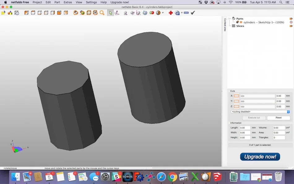

Issue #2: Tessellation
While a contour may appear smooth in the CAD, depending on approximation settings, the surface might actually be approximated.
Let’s compare two designs side by side in netfabb:
![SketchUp CAD model](https://www.fictiv.com/wp-content/uploads/2016/06/SketchUp-CAD-model.jpg)
The cylinder on the left has some tessellation, so during print the surface might not appear as smooth. The cylinder on the right is much smoother.
(Note that for actual printing, make sure to separate the parts into different files. These two files are combined just for side-by-side comparison!)

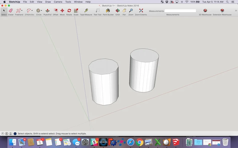

Solution: In SketchUp, if you select <view> then check <hidden geometry>, you can see the approximation occurring for the curve. Change the number of segments on the curved surface to better approximate the contours.
Going back to SketchUp, we can see how these cylinders were designed:
![another SketchUp CAD model](https://www.fictiv.com/wp-content/uploads/2016/05/another-SketchUp-CAD-model.jpg)
The cylinder on the left has 12 segments, while that on the right has 24.
In SketchUp, you will need to change the number of segments on a surface before any extruding or push/pull. To do so, draw the curve, then type “24s” for 24 segments, or “20s” for 20 segments.
When printing in lower resolution FDM, the surfacing issues might not be as apparent and thus might not matter as much. It will matter however when printing in high resolution materials such as VeroWhite, where the tessellations are something you should be aware of!
