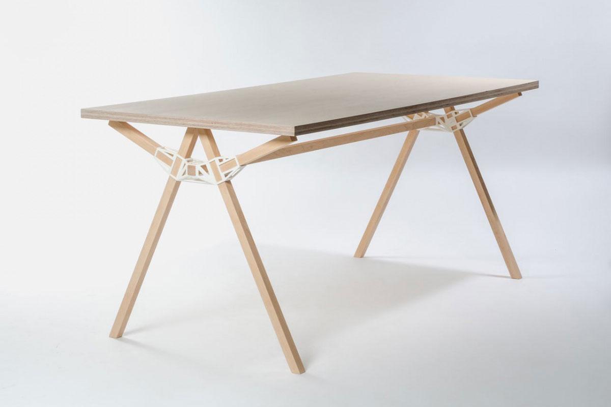

A novel way that additive manufacturing has become a valuable tool for creating original furniture products is in the idea of 3D-printed panel joints that may be used to join flat plywood or flexible panels into creative shelving or work-surface solutions. By creating unique sets of custom joints for a project, furniture designers are able to create contemporary pieces of furniture without any traditional fasteners or adhesives.
The relatively small joints can be designed to position the panels at any required angle, and multiple copies of each component can be used as necessary to build a complete piece. This type of design lends itself to open-source furniture – if joints break or wear out over time, new parts can be printed from any machine, as long as the models are still available.
Designs for these types of plastic joints may be also ultimately produced using injection molding for increased mechanical strength, however 3D-printed parts may suffice as-is for low-volume, lower-load bearing pieces of furniture.
Check out this example from Design Boom for inspiration on how to 3D print furniture joints.
