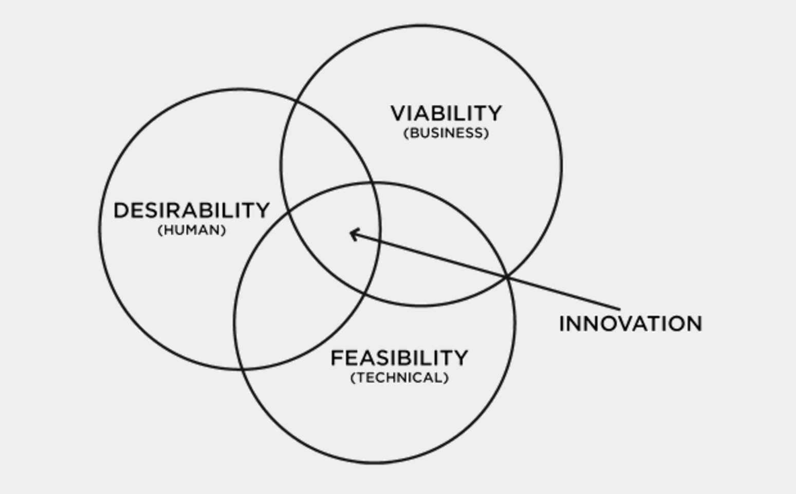

Over time, this methodology has come to be known as Human Centered Design (HCD). In this article, we’ll be taking a look at the various components involved in HCD, as well as how you can leverage the process to develop marketable products that provide a lasting impact.

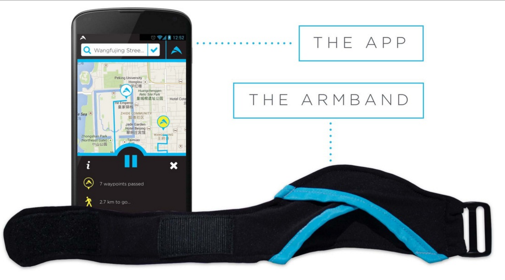

In this course, my team was tasked with creating a “wearable artifact that augments and extends the capabilities of [humans].” The result was a haptic (touch-based) navigation wearable for pedestrians, called Romu.

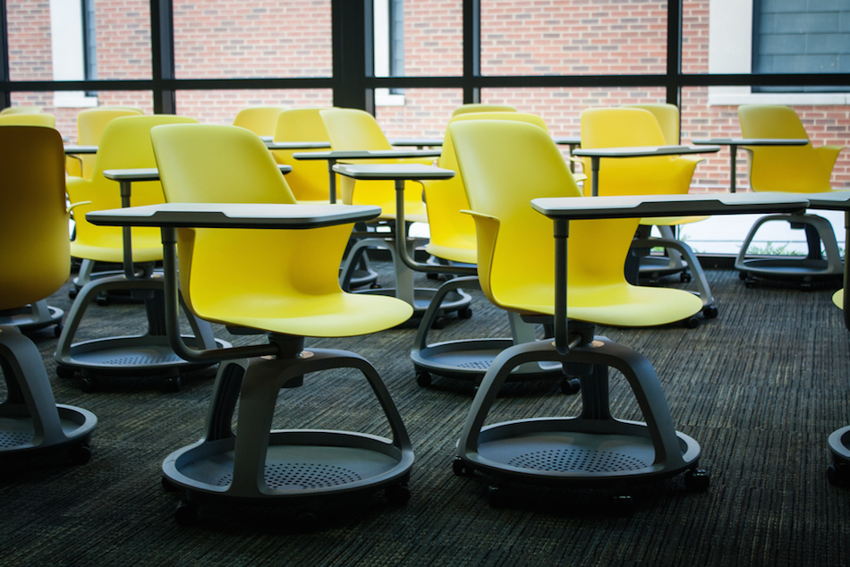

The Node chair (by IDEO and Steelcase) is a product with design elements clearly informed by the needs of today’s dynamic classroom environments. From its ergonomic shape and storage features that offer comfort and convenience, to its swivel and roller mechanisms that allow ultimate flexibility between personal and group activities, the Node is the answer to many woes that were previously commonplace in the academic world.

The persona that led to Romu was a young urban professional (most of our needfinding was in cities) who travels often to new areas for work or for fun and is eager and willing to adopt new technology.

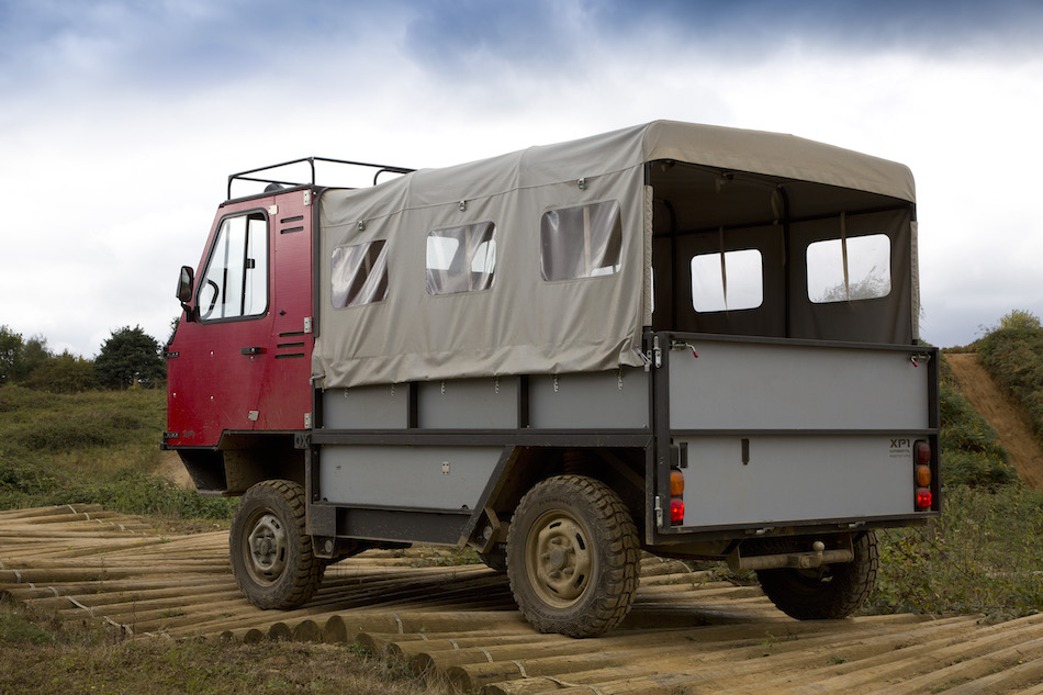

Let’s look at how proper benchmarking led to Ox, a flat-pack all-terrain vehicle that can be shipped worldwide and assembled by three people in about twelve hours (with huge humanitarian and logistics implications for remote areas, like those in Africa). It was designed by a former Formula One designer with a deep knowledge of existing materials and technologies and decades of experience implementing design principles like robust, lightweight construction. Simultaneously, the Ox draws inspiration from furniture designers like Ikea, as exemplified by its easy, out-of-the-box assembly.

In an ideal scenario, we’d fulfill all the human needs and solve all the pain points observed through research. However, in a business setting, we have limited resources and time, and the best path forward should be sustainable for the business, feasible to implement, and desired by the user.
Using the insights found in the field and through prototyping, we can better engage stakeholders, guide product development, and boil down the list of specs into the most essential set.

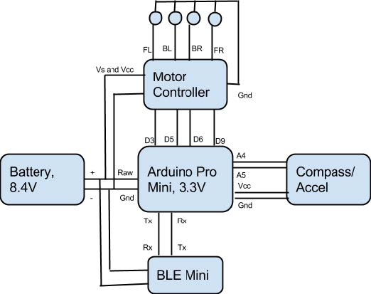

Romu’s first completed subsystem was the vibration motor array and software navigation protocols. If people couldn’t use the haptic cues to navigate a foreign area turn-by-turn, our product was dead in the water. After this feature was complete, we moved on to the other subsystems—armband, electronics enclosure, app, Google Maps and Bluetooth integration, and power supply.

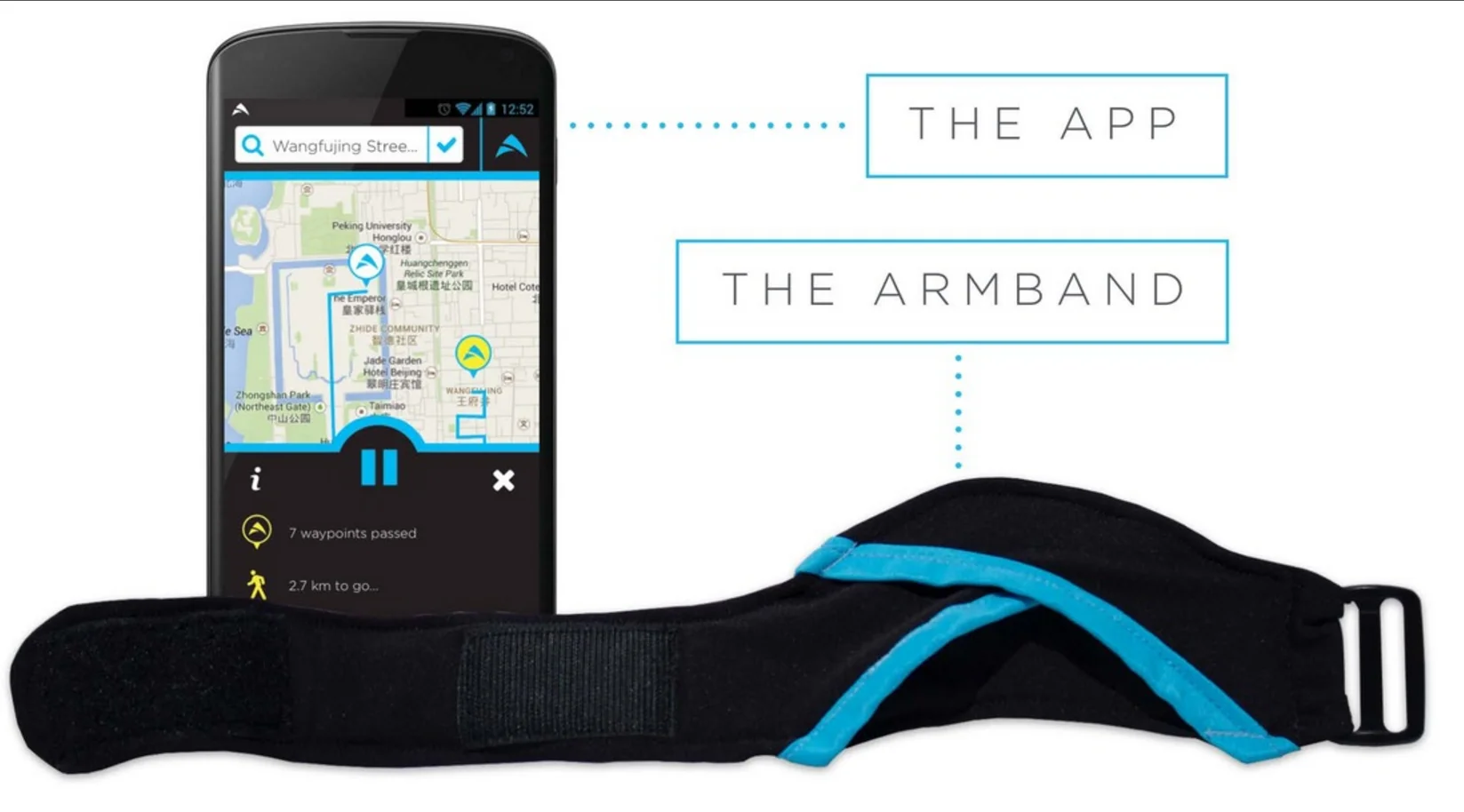

Once our product is assembled, functioning, and looking pretty, we get to show it off to the world! Whether this is a polished prototype being pitched as a business idea, or a shelf-ready product, if we’ve followed the HCD methodology, hopefully we have something with elegant design and true utility.
Again, remember the emphasis on user needs at this time. Engineers tend to list out all the technological features and functionalities of the product, which tempts the audience to ask, “So what?” Instead, think back to some of the users you encountered during development, and tell the story of the product as if they were the ones using it. This helps the audience relate and invites clearer feedback from stakeholders.
