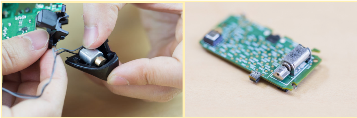

The tradeoffs come through the size, since they’re not usually as compact as the coin form factor. Additionally, you need to consider how to securely mount the cylindrical form factor within your device (especially since you have a free spinning mass whipping around, you’ll want to make sure the motor is bolted down, and there’s no interference for the spinning mass).
Mounting a vibration motorMounting techniques include fabricating and incorporating a housing to fasten down the motor.” data-entity-type=”file” data-entity-uuid=”bbf4d528-6ebf-4295-bcac-4679ba77fa50″>

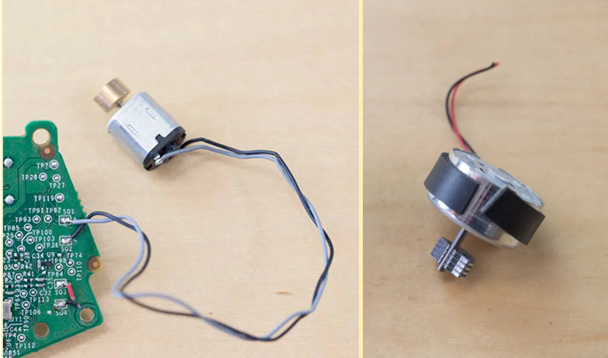

Compact coin vibration motors operate via ERM mechanismCoin vibration motors operate via ERM mechanism, but are often more compact!” data-entity-type=”file” data-entity-uuid=”dbd8b401-8146-4df0-b55c-4afa4ebcb5db”>
In addition to the cylindrical ERM vibration motors, the other form factor we have are coin vibration motors. These are flat, “pancake” (a common nickname) components.
Coin vibration motors also employ a rotating offset mass, only in a flat and smaller form factor that is fully enclosed, rather than exposed. Instead of a longer cylindrical shaft with a long axle and offset mass, the shaft is very short, and the interior contains a flat mass that is offset from the center of rotation (so that it can fit in the coin shape). Thus they are categorically also ERM motors by mechanism; however, it’s common industry practice for the exposed cylindrical vibration motors to be called ERM vibration motors and the coin form factor to be called Coin, or Pancake, vibration motors.

Vibration motors often sit on/within an enclosure or directly on PCBs. You can easily 3D print an enclosure to house the vibration motor and to mount it. If mounting onto a PCB, there are often options for soldering via through-hole pins. In the case of Coin and LRAs, you can just use the adhesive backing.
mounting an ERM vibration motor directly on the PCBTechniques for mounting an ERM vibration motor include creating a housing (left) or securing directly on the PCB (right).” data-entity-type=”file” data-entity-uuid=”5ad3b2f7-c2ed-4a6b-b547-777f1bfdb429″>

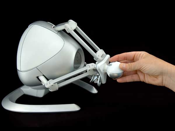

The Novint FalconThe Novint Falcon (announced 2007) was a controller that simulated texture, weight, and movement for a realistic virtual experience.” data-entity-type=”file” data-entity-uuid=”9eaa11f2-52fb-49fb-b910-b97001f0d5d2″>
We’re only scratching the surface of haptic feedback in this article. Vibration motors are one method of providing feedback. We can go much simpler—think using a dome switch for actual physical buttons—or much more complex—think new virtual reality controls that use shear forces—to fine-tune the type and profile of haptic response.
