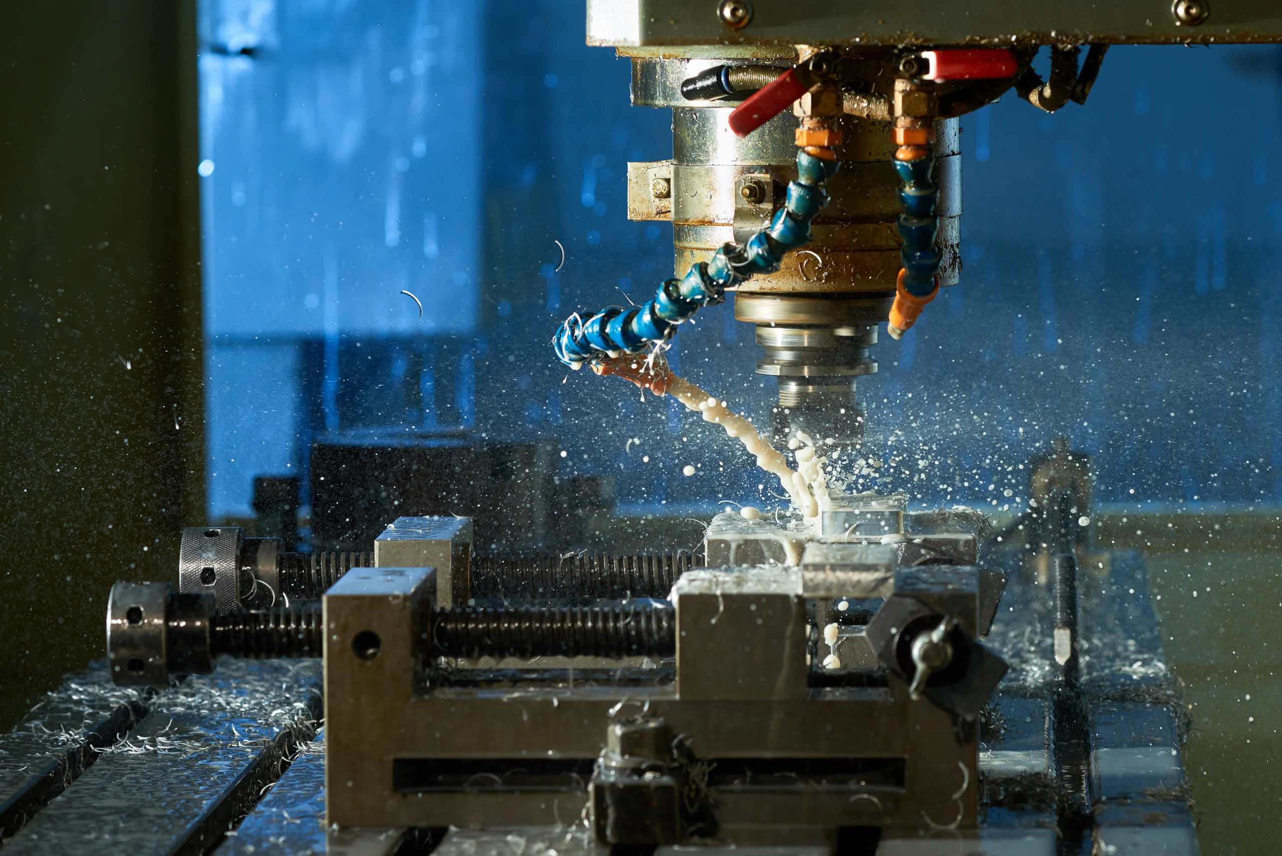

CNC Machining with a Vertical CNC Mill
CNC vertical milling machines are advantageous because they can provide quick processing times along with the precision and accuracy you need for even the most complex machining jobs.

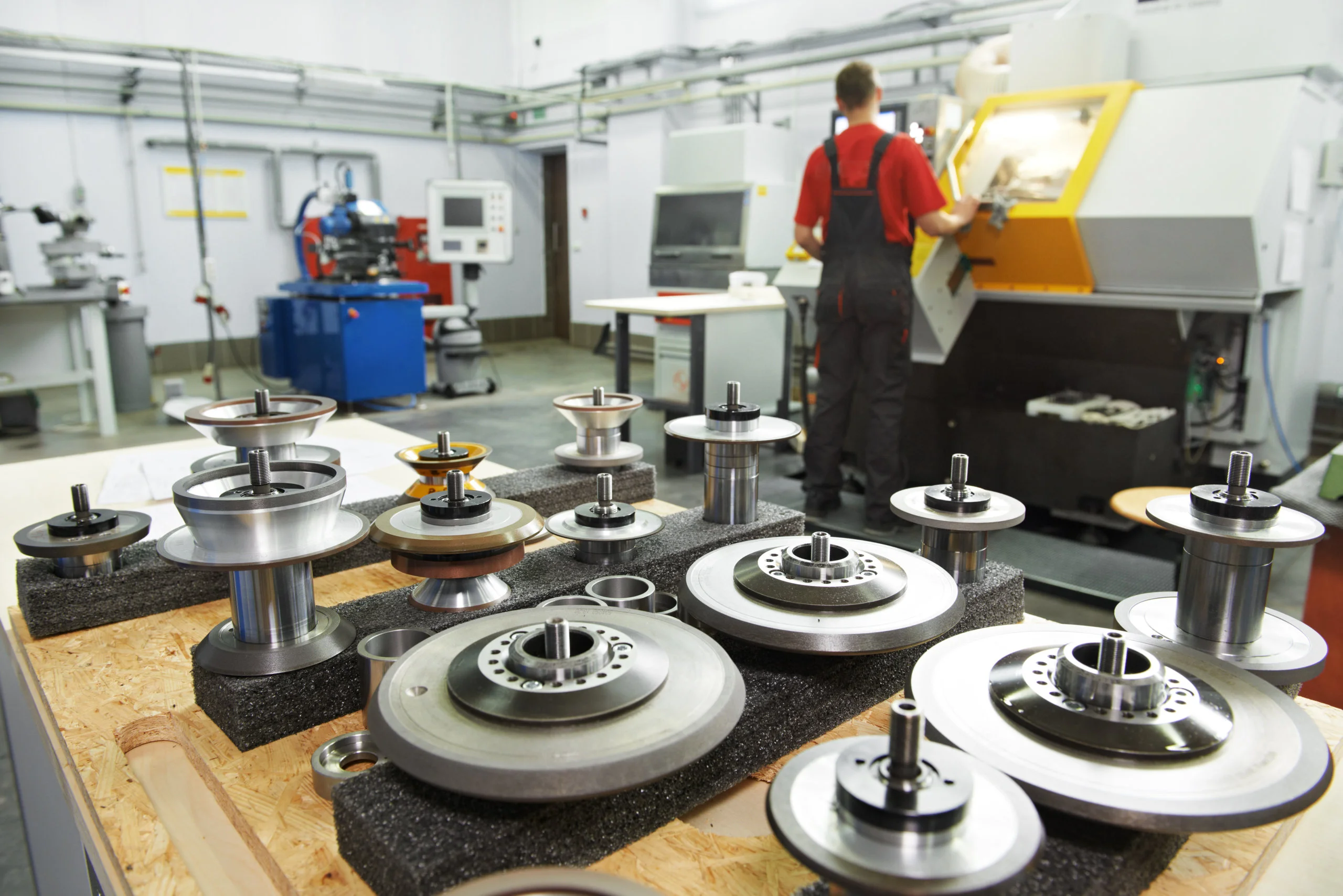

CNC Vertical Toolroom Mill
industrial cutting tools for cnc machining
A toolroom mill is classified as such because they are typically found in – and you’re not gonna believe this – toolrooms. A toolroom is typically a place where machinists make tooling for other CNC machines, including production CNC machinery. Of course, such mills can also be found in labs, teaching environments, and schools.
As precision, tight tolerances, and accuracy are critical for production tooling, a CNC vertical toolroom mill tends to be more precise. This type of CNC mill is typically smaller and requires more (or all) manual operator control and manual tool changes as well. Vertical toolroom mills also typically have a reduced number (2 or 3) of operational axes. Some CNC vertical toolroom mills have the option to be run completely manually or with CNC controls.

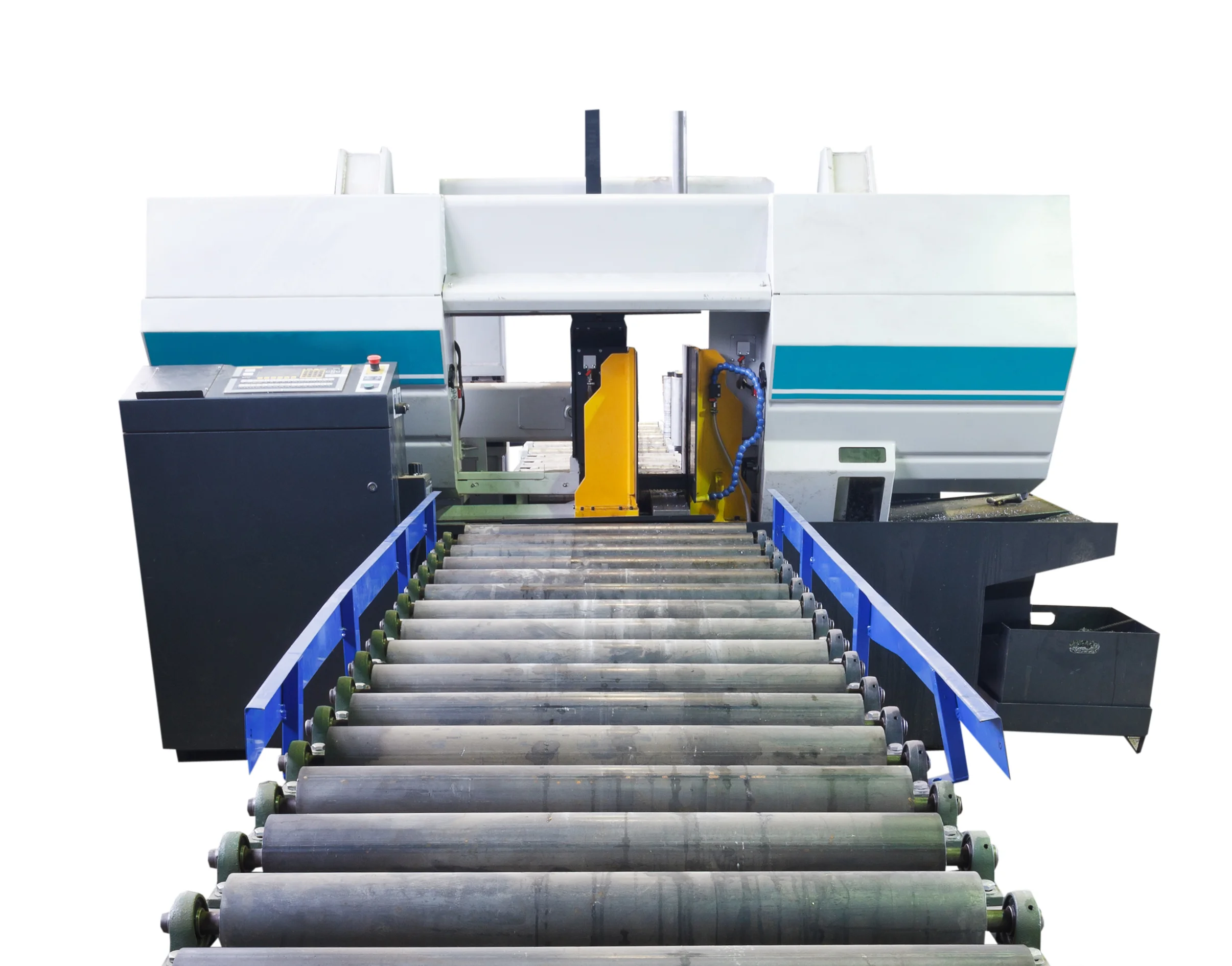

CNC Vertical Column Mill
a CNC vertical column milling machine
A CNC vertical column mill offers ultra-high efficiency. A vertical column mill style machining center has a fixed table and a vertical column where all the X, Y, and Z axis movement occurs. As the name implies, a vertical column mill consists of a vertical column with the spindle attached. The column also houses the mechanism which provides the drive functionality to the spindle.
There are also double column mills that provide extra stability, precision, and accuracy. The large table, which moves longitudinally, allows for manufacturing productivity gains because you can load a multitude of parts on a table at one time — reducing the need for single part loading and unloading. The large table also allows for the machining of otherwise difficult-to-machine large or heavy pieces (similar to gantry-style mills).
