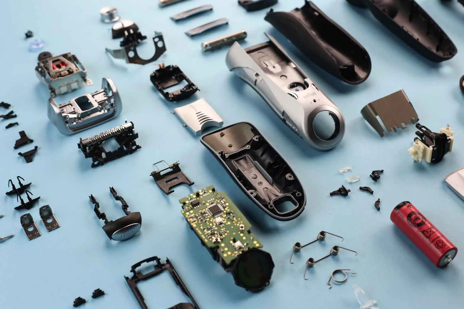

In what will become a trend in this teardown, the Braun Series 7 electric shaver is similar to the Norelco, just more involved.
It chiefly makes use of injection molded parts, with overmolding, insert molding, painted parts, and clear optical parts. However, the Series 7 also makes use of heat staking and glue to hold itself together. It also has a wider mix of materials, and makes more use of stiffer-but-harder-to-mold glass filled plastics.
The Series 7 also has a much higher count of metal components, including more screws; riveted brackets; compression AND custom torsion springs; and some relatively heavy plates and brackets that add some heft to the overall product.
In addition to all the snap fits, there are several places in the head of the shaver where metal parts are bent to actually capture plastic parts, making a self-contained, yet movable, assembly.
The motor for this shaver is actually a custom linear oscillating motor, which is held together with rivets and lots of tiny welds, which are not seen as commonly in consumer electronics.

The Braun Series 7 electric shaver is, surprisingly, one of the more complex things we’ve torn down. Just looking at the bill of materials, the Series 7 has a much higher part count than the Norelco, particularly when you include all the springs, pins, and fasteners on top of the IM parts. The motion mechanisms in the head use pressed in steel pins, slots, and tabs to constrain the moving parts and make sure they move tightly along one axis.
The PCBA is much more complex, with a removable battery that connects to some bent copper plates rather than standard wires, and a flexible area to allow the display to be angled relative to the rest of the board. The linear motor used is also much more complex than a standard stepper motor, due to its more custom nature.

Given all the detail that went into the Braun Series 7 electric shaver, it’s no surprise that they all add up to a well polished product. The use of steel pins and plastic bearings on all the motions make for a very smooth, strong feel.
The use of spring loaded cams ensures that everything locks into place in a satisfying way, whether it’s locking the head in place or slapping in a new blade and foil cartridge. There are two steel plates added into the shaver, just for the sake of adding weight, which makes the product feel more substantial.
Speaking of weight, the larger lithium ion battery also adds more weight and is technically removable, so if it dies, it’s possible to keep the shaver alive (just make sure you put the battery back in correctly!).
The use of an actual LCD display, enclosed under a protective plastic dome, makes the shaver feel more like an electrical tool.
Most importantly, the Series 7 includes a flip-out trimmer, so you can actually get your beard to a length where the cutting head is useful!
