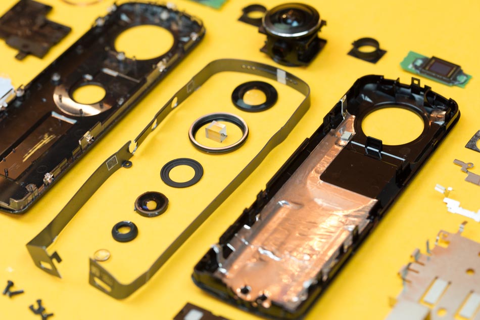

The camera’s front and back enclosures are plastic with soft-touch paint. Soft-touch paint feels good, but it’s a huge fingerprint magnet and scratches easily. The convex lenses could easily get damaged, too, since they stick out of the body so much. There’s no lens cap, but the Theta S does come with a fitted neoprene pouch for some protection.
There are no visible screws on the outside of the device; an aluminum sheet metal trim wraps all the way around the body. We peel this trim back to reveal how the two halves are actually held together: by eight snap fits.
We’re actually able to take a few screw tabs off the aluminum trim by forcefully peeling the trim off the body. During assembly, the aluminum trip would be fastened to one enclosure half by screws, and then the other enclosure half snaps on. There’s no clean way to reverse this process: If you want to repair Theta S, it won’t be easy.
After we get the “front” cover off, we find a 1350mAh Lithium-Ion battery and a thermal pad that’s almost as large in area.
We’re surprised by the battery’s form factor: It’s a removeable type, but it’s not intended to be user-removable. Perhaps this battery is being used in another Ricoh product that allows battery swaps, so it made sense to reuse an existing component.
After removing the battery and thermal pad, we find a large sheet metal bracket standing in our way.
The cnc aluminum bracket is fastened to the enclosure via small screws. It has quite a few spring features to hold down other components, like more thermal pads!
There are four thermal pads in total. These PCBAs must get really hot for such serious thermal management.
Despite the small form factor of the camera, Ricoh engineers somehow managed to cram five rigid PCBAs inside. This is the WiFi board, featuring a Marvell 88W8801 WiFi system-on-a-chip under a shield.

The most unique and interesting part of this camera is no doubt the optics, where two fisheye lenses are stacked back to back to take 360 degree photos and video.
In conventional cameras, the imaging sensor (CMOS, or less commonly, CCD) is mounted directly behind the lens. To minimize the camera’s thickness, Ricoh’s ingenious optical engineers moved the CMOS sensors onto the side of the optical train.
We remove the imaging sensor PCBAs to get deeper into the optical train. There is a twelve-megapixel, 1/2.3” CMOS sensor on the imaging PCBA.
With the imaging PCBA removed, you can see another lens orthogonal to the fisheye lens. This small lens focuses light onto the CMOS sensor.
How is the image “seen” by the fisheye lens? There are two prisms in the center of the optical assembly that “bend” the direction of light.
Each side of the assembly features seven elements in six groups. If this sounds like a lot, it’s actually not: The iPhone 6S has a five-element lens, and a 3x optical zoom lens can have ten elements.
