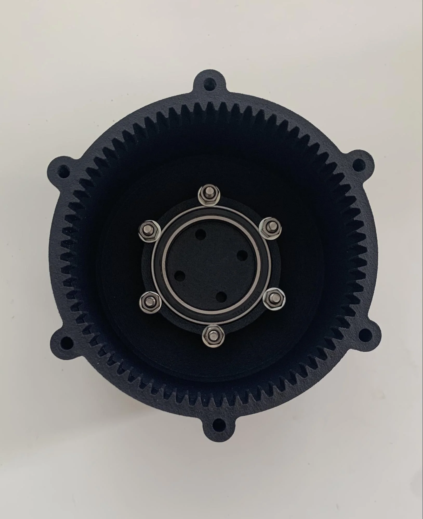

The circular spline is like the flexspline, but larger, because it is the outer piece of the gear system. A crucial requirement of the circular spline is for it to have two more gear teeth than the flexspline. It also has the gear teeth on the inside of the open end, so that they come in contact with those from the flexspline.

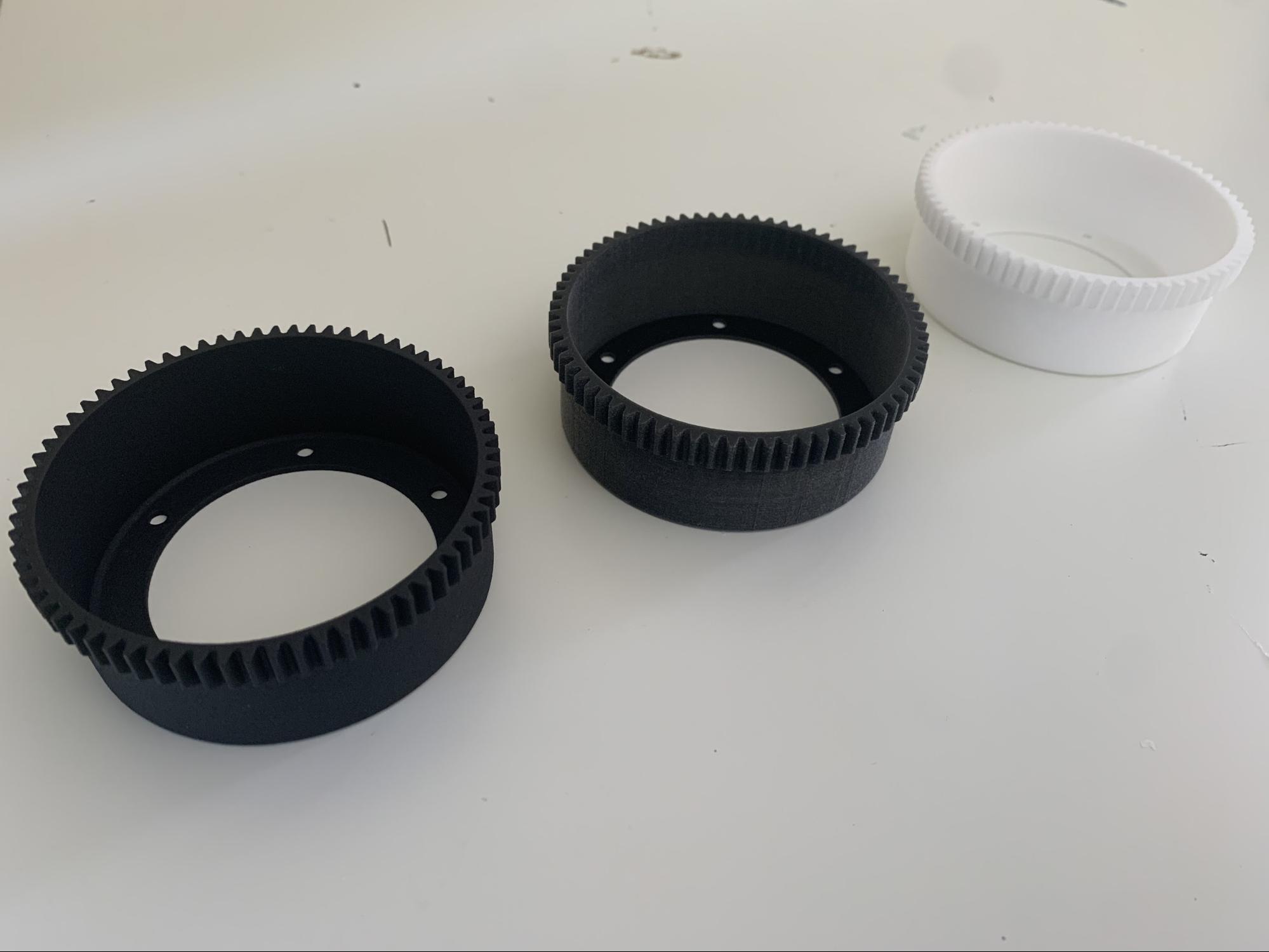

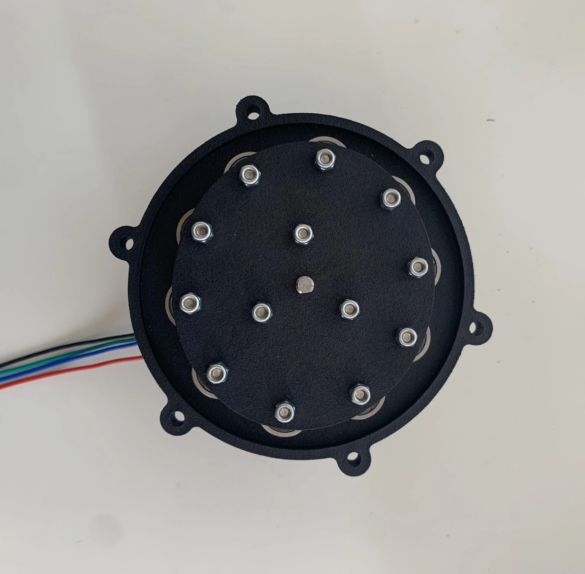

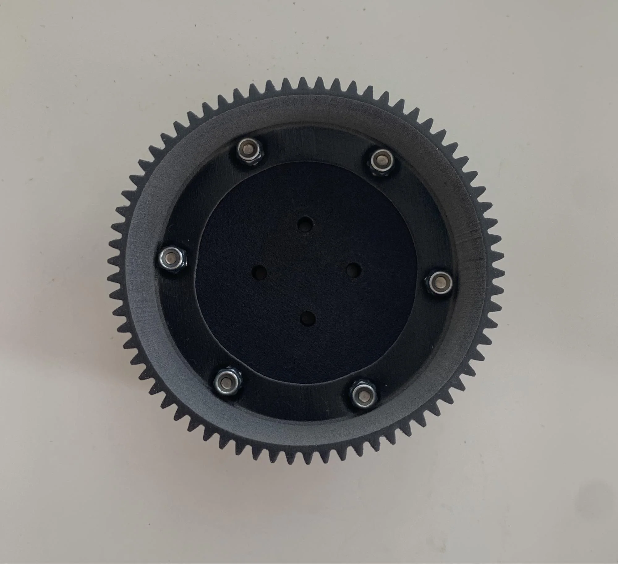

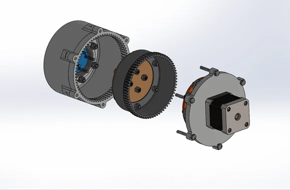

Our process consisted of testing three different flexsplines: a Multi Jet Fusion one, a Polyjet one, and a Selective Laser Sintering one. The rest of the harmonic drive parts were made from Multi Jet Fusion. It was assembled using off the shelf components and powered with a stepper motor. We tested it at low speeds (~100 rpm) and then at higher speeds (~500 rpm) to see how the flexsplines would perform.
3 different flexsplines: a Multi Jet Fusion one, a Polyjet one, and a Selective Laser Sintering one

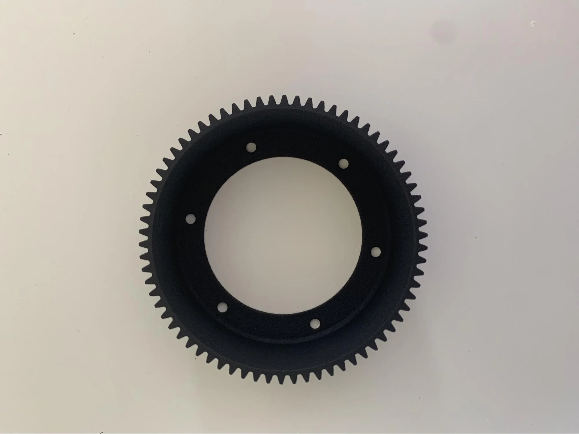

Multi-Jet Fusion
First, we tested the Multi Jet Fusion (MJF) flexspline. MJF is a newer technology and uses a nylon powder as the base material.
HP claims their tech is well suited for gear teeth. It looked great and had a smooth texture, which helped reduce friction.
Overall, it worked very well, both at low and high speeds. It has a bit of backlash, but that can be fixed in the actual design process. MJF is great, both very rigid and a bit elastic, making it a great 3D process for the flexspline.

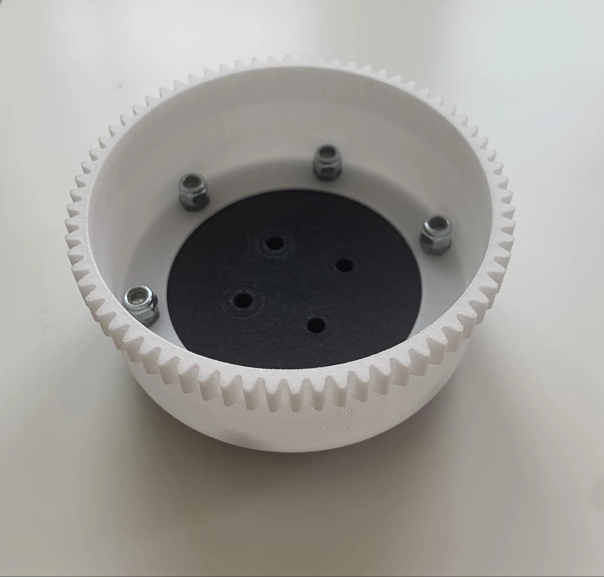

Polyjet
Second, we tested the Polyjet process, using the rubber 90A shore hardness material, with the intention of replicating the results of an off the shelf rubber drive belt. That proved to be far more flexible than intended and lacking rigidity. This was not an issue at low speeds (below 100 rpm), and it worked relatively well.
But when the wave generator turned on at high speeds, the flexspline would start working then get stuck for a long time. This process may have been better suited if there was a hard plastic backing behind the gear teeth, but the material alone caused too much friction and was extremely flexible. While adjustments could be made to fix these issues and improve performance, the Polyjet flexspline was ineffective for this test trial.

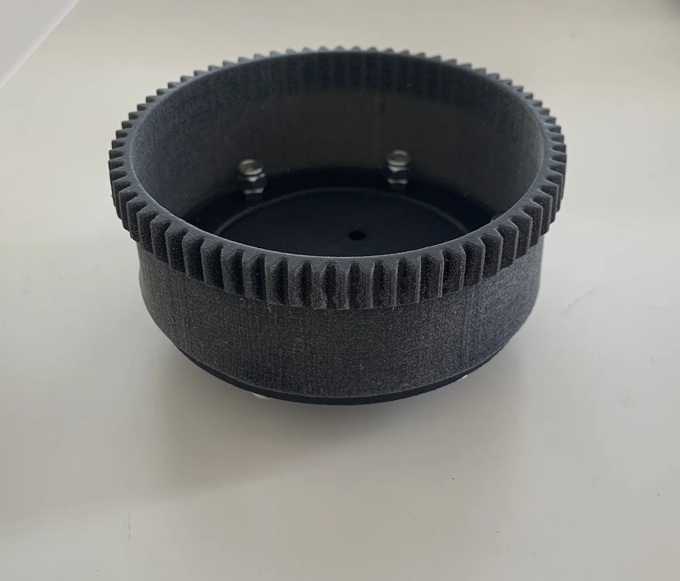

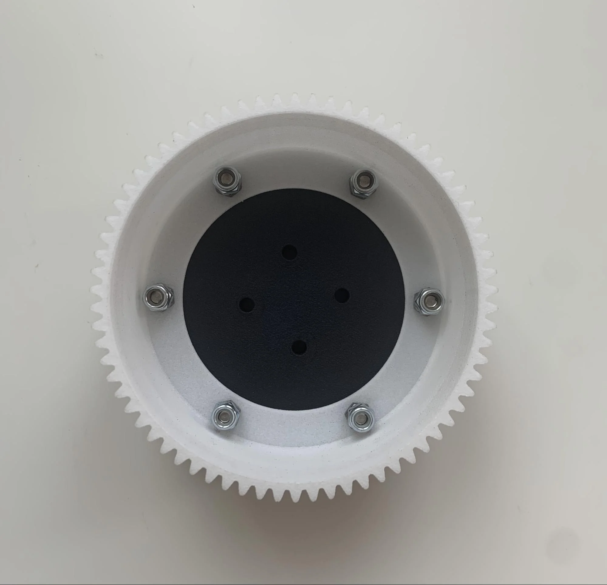

Third, we used a Selective Laser Sintering (SLS) flexspline made out of nylon. It was stiffer than both the previous materials, which ended up being the problem, in this case. Like the Polyjet, the SLS flexspline didn’t work well at high speeds (greater than 200 rpm). In fact, it didn’t work at all after it got stuck, but it was better than the Polyjet flexspline.

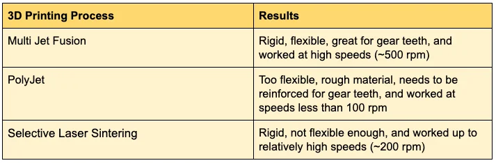

Main Takeaways
Multi Jet Fusion turned out to be the best process for a very rigid, yet slightly elastic material. It was great for the gear teeth, running the most smoothly out of all the flexsplines.
Polyjet was the most flexible, but flexibility was not the only thing we should’ve considered. While possibly useful for other applications, it isn’t practical for gear teeth without modifying the gear rigidity first.
The SLS flexspline was good for low speeds, but the material was inconvenient at higher speeds. Of course, these are only the results from our observations, but MJF is still highly recommended for gears if one doesn’t want to alter the material.
