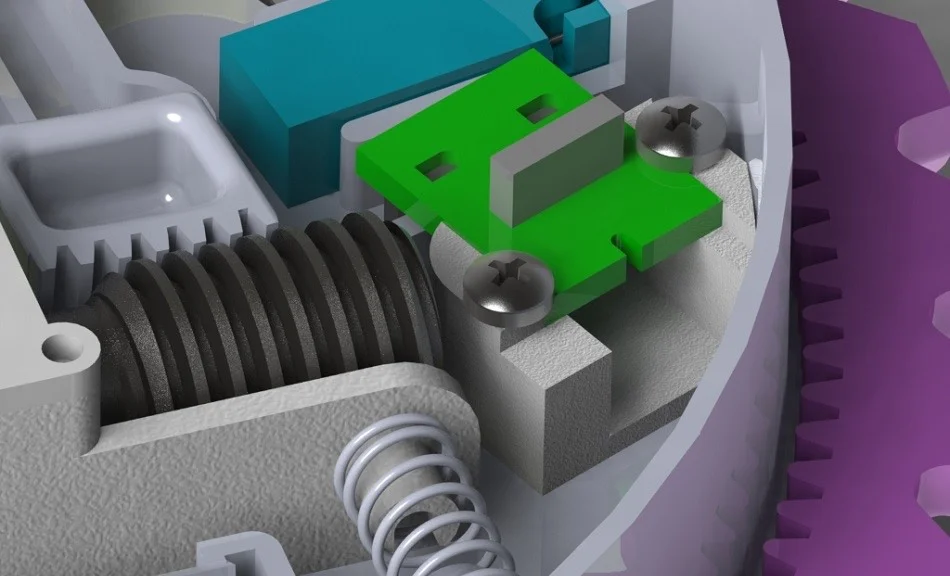

swingarm optic sensor alignment
<em>Swingarm optic sensor alignment drawing<em>
Worm gears are a little more flexible: When a worm interacts with a spur gear, it can be a very effective reducer (worm gears commonly act as a single-tooth gear, with just one long “tooth” wrapped around the shaft, so you get phenomenal reductions in a single step, eliminating a complex gearbox). But worms are also commonly used in linear actuators, where the worm (or screw) has a nut moving along its length, translating rotary motor motion into a low-backlash linear movement.

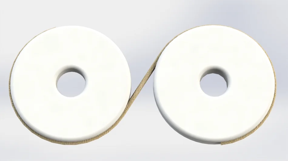

Imagine that instead of gears you have two posts, and a string is wound around one post many times and also wrapped around a second post. As we wind more string onto the second post, the first post will rotate; and more importantly, the rotation and power transfer between these two posts will be smooth and constant. Involute gear design imitates this ideal scenario by shaping the teeth of the gears in the shape of the string unwinding.
involute design string
<em>Involute design string<em>
And this is where we need to think about pressure angle again. If the two pulleys or posts are in contact, then the pressure angle would be zero degrees, and there would be no room for our gear teeth.
The further apart we place the two base circles—the two circles representing the perfect pulleys—the higher our pitch angle. High pitch angles become more efficient for power transmission, but at the expense of space and quietness; a 20-degree pressure angle is typical in most gearing systems for a good balance of properties.

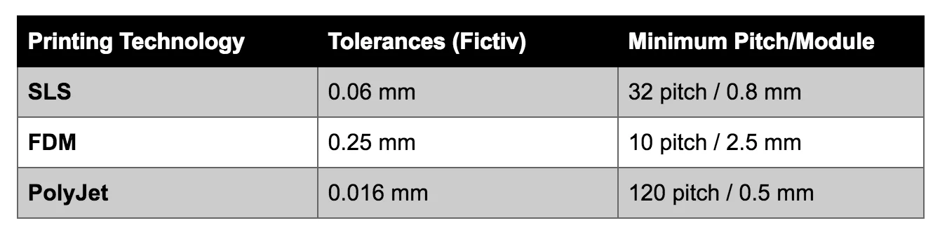

As with any manufacturing method, in order to get a good final product, you need to look at the reasonable tolerances for how your design is being produced, and this is especially important for 3D printed gears.
With a machined metal gear on a good CNC machine, it’s easy to produce gears with tolerances of as little as 0.005 inches. This means that you can expect good-quality gears all the way down to about 64 pitch with no problem at all, and can even produce 128-pitch gears if needed. But with some 3D printing methods, your tolerances may be as much as 0.020”—four times the size—and you’ll want to scale up the gears accordingly.
How small is too small?
For my designs, I use the 10x rule of thumb: the pitch should be ten times the size of the tolerance. That means that a minimum tooth size for an FDM printed gear with 0.020” tolerance would be 0.20”—basically, you can have 5-pitch gears easily printed. If you’re willing to do a little sanding on the final product, then you can lower that to a 5X design rule, but I would recommend going for a finer-tolerance process, such as SLS, instead, which, with its 0.010” tolerance, can easily create gears in the 10-pitch range.
The table below shows recommended printing methods for different gear pitches. Though it’s only a guide, this has worked well for my robotics designs in the past, and I would recommend following it until you have more experience.
Recommended printing methods for different gear pitches
<em>Recommended printing methods for different gear pitches<em>

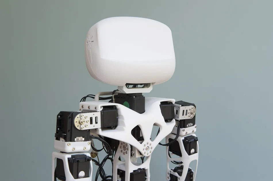

open source 3D printed Poppy humanoid robot
<em>Poppy an open source 3D printed humanoid robot<em>
