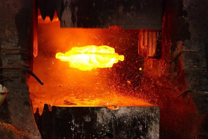

Hot forging, or hot working, includes shaping metal at raised temperatures, usually between 700°C and 1,200°C. The metal is heated to provide flexibility and make it more bendable.
Hot Forging Process
- Heating: The metal workpiece is heated in a furnace until it is malleable — the temperature differs depending on the material.
- Deformation: The heated material is then positioned in a die or mold, and a compressive force is applied via a press or sledge that deforms the material into the desired shape.
- Cooling: After the forging process, the workpiece is cooled — frequently in controlled conditions — to prevent issues related to cooling the material too quickly.
