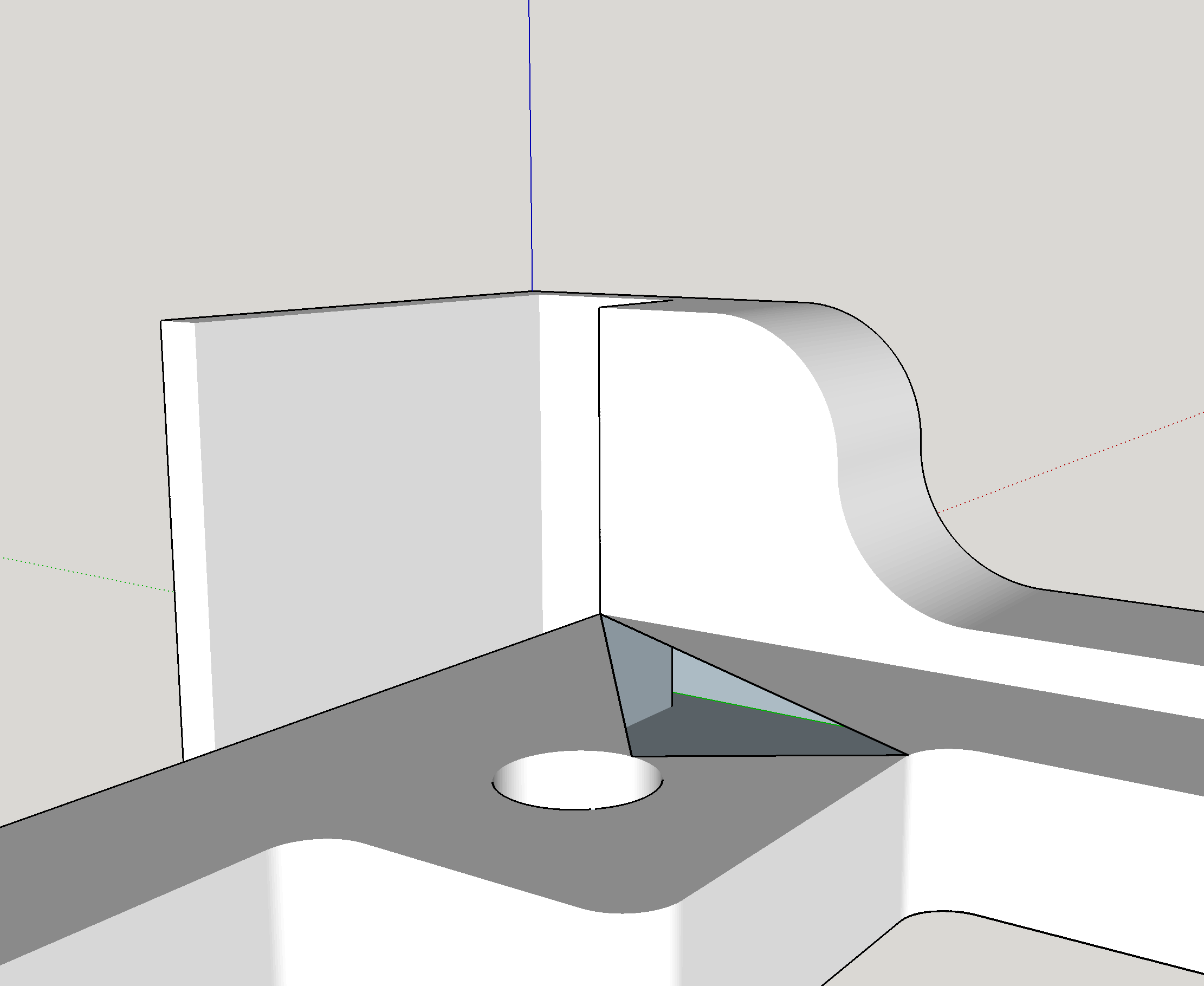

Above is an example of a part with a missing facet. In many cases, the missing facet is much smaller than this one. You can see the inside of the part. If it was real, the part, well, wouldn’t hold water.
Because of these holes, Fictiv can’t properly make sense of what the entire shape is because pieces are missing or improperly defined in the model.
