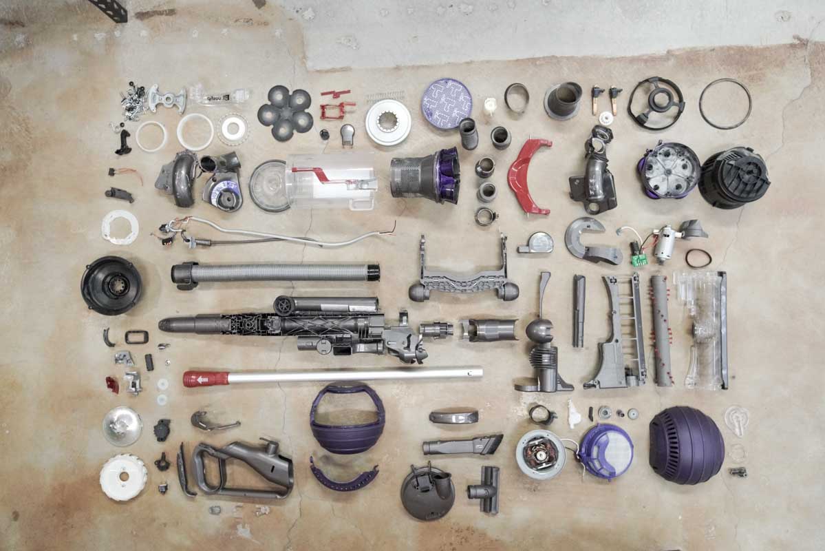

By the Numbers:
  • 167 parts
  • 74 fasteners
  • 7 types of plastics
  • 1 PCB
  • 2 mechanical switches
We’ve long been fans of the innovative work of Dyson. Their products are immensely creative, beautifully designed, and mechanically impressive. And on top of that, we love Dyson’s transparency and willingness to share just how their products are made.
So we got our hands on one of the classic Dyson Ball Vacuums to venture inside and see for ourselves the mechanics that make up one of their flagship products.
There are 5 main systems that make up this awesome vacuum cleaner:
  1. Motor
  2. Vacuum Head
  3. Cyclone
  4. Handle
  5. Tube/body
We’re going to take a look at each of these systems to investigate the inner-workings of Dyson’s technological innovation. Onward!
