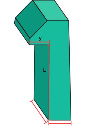

Cantilever snap fit
Strain check uses a classical cantilever approximation:ε = 1.5 . y . t / L 2. Reports outcome: elastic vs permanent set vs fracture - likely.
Root to hook (mm or in).
In bending direction.
Out-of-plane width.
Tip travel during snap.
