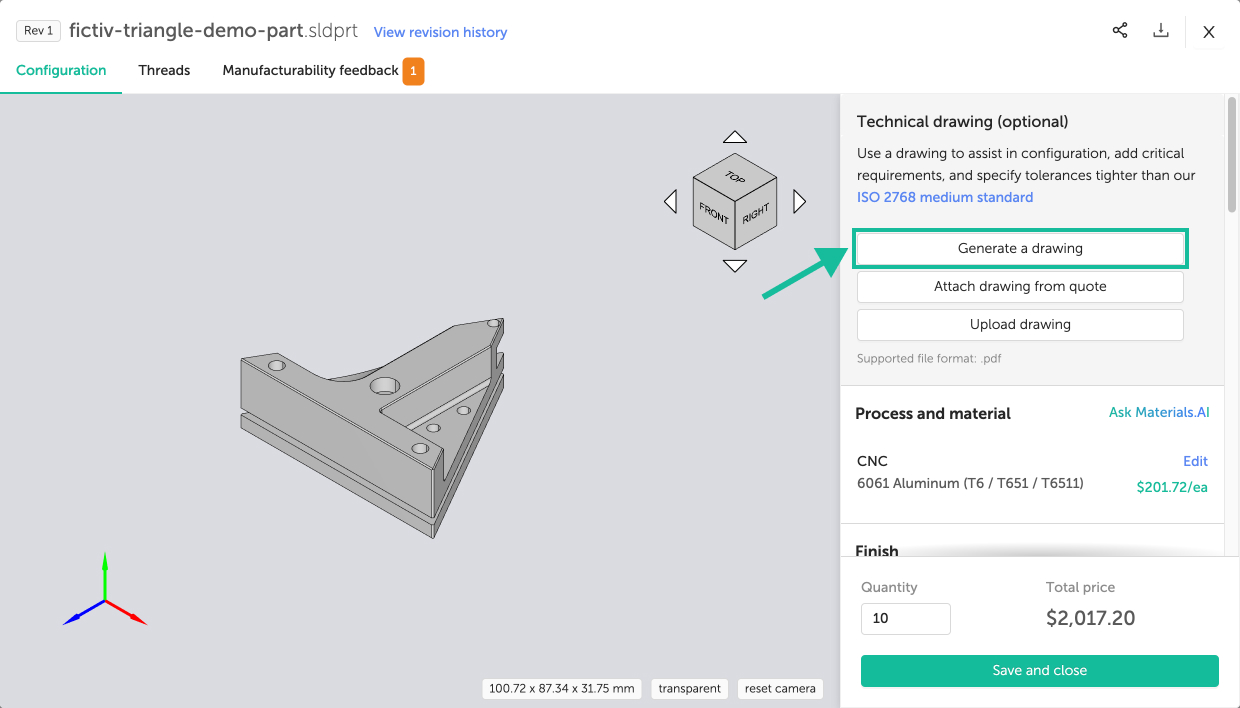

  3. On the right-sidebar, click the “Generate a drawing” button under the Technical Drawing header
  4. Select “Generate a 2D Drawing” [Fig. 1]
Fig 1

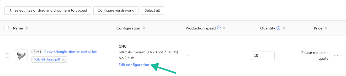

  1. Select “Edit Configuration” from the quote [Fig. 3]

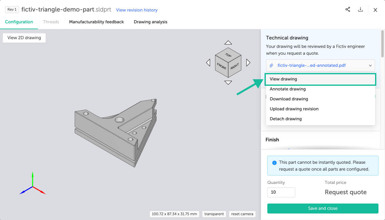

  2. Hover over the PDF link on the right-sidebar and select “View drawing” in the dropdown [Fig. 4]
Fig 3
Fig 4

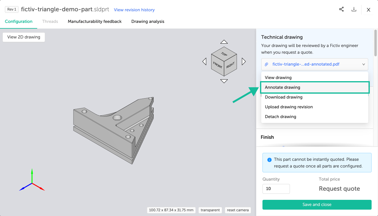

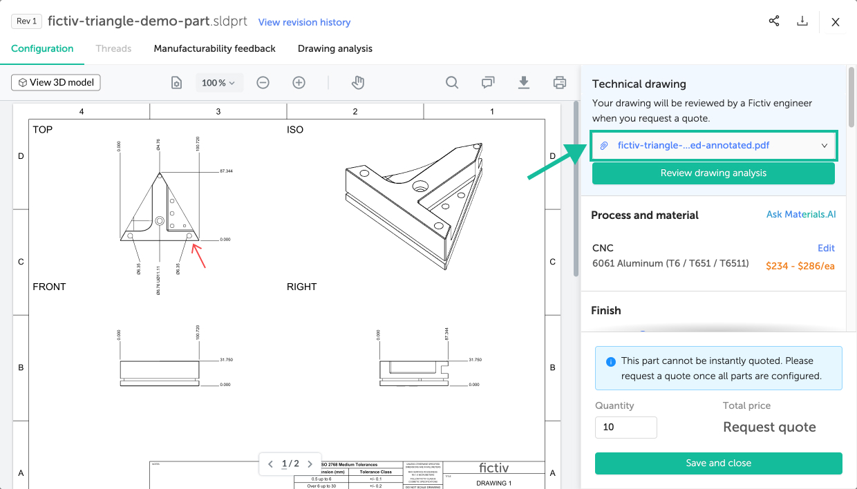

Users also have the ability to annotate any PDF drawing that is linked to a model, regardless of whether it is an existing drawing or one that was generated in the Fictiv platform. You will be given the option to annotate a Fictiv drawing once it has been created [Fig. 6].
Fig 6

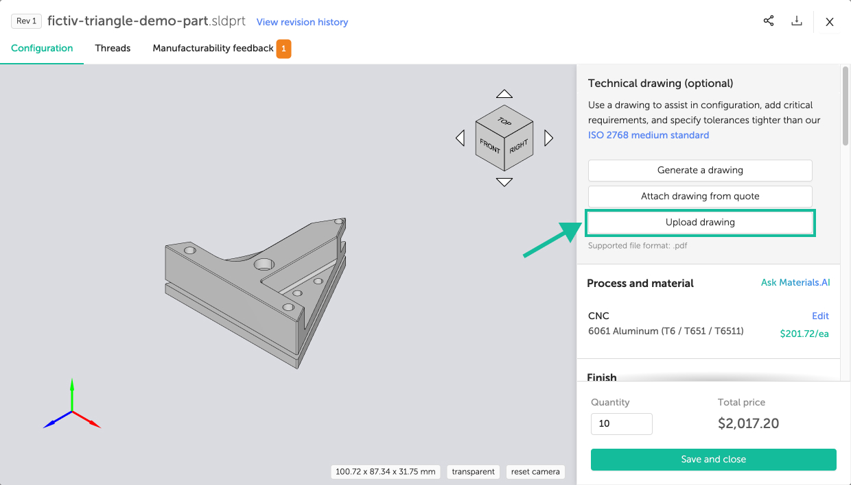

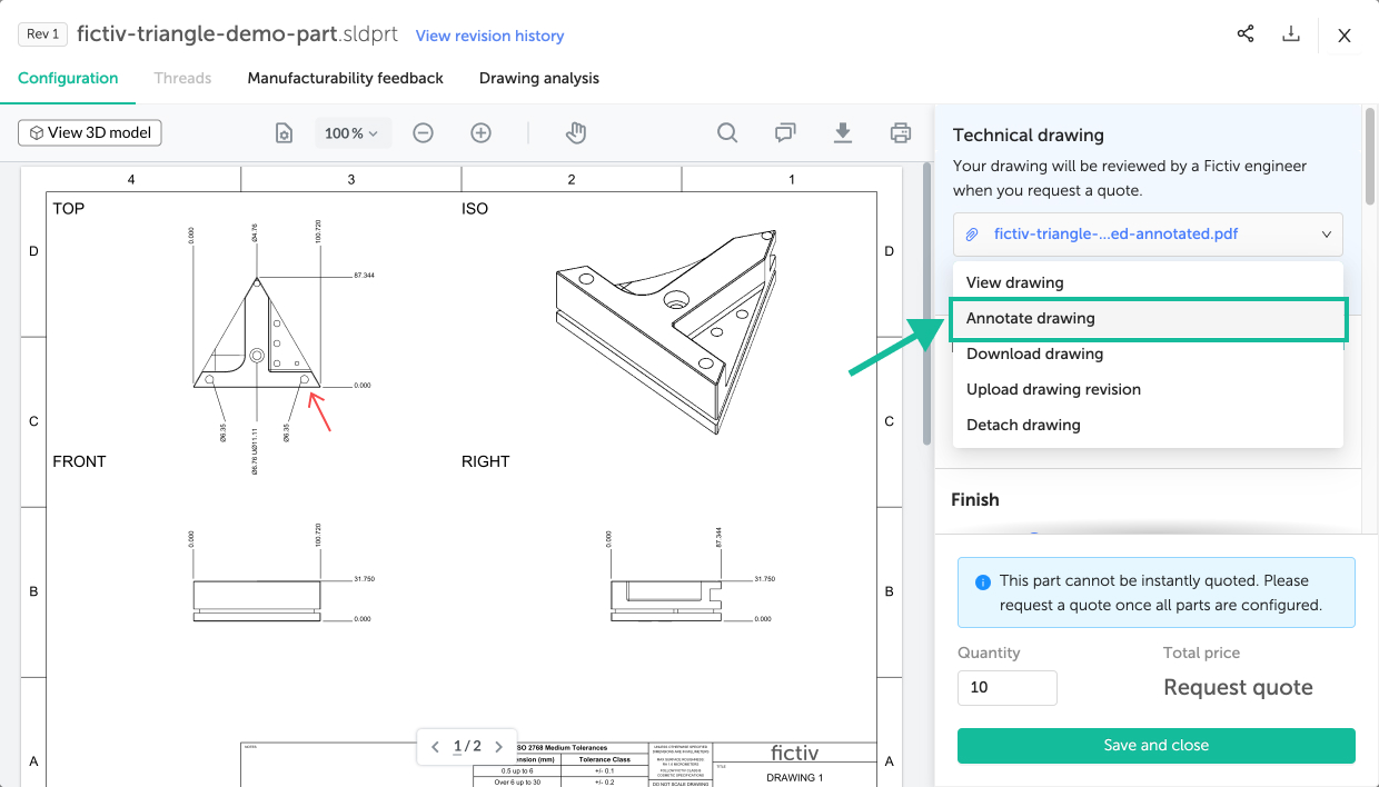

To annotate a pre-existing drawing, first attach the PDF to the CAD file by clicking “Upload drawing” in the part configuration window [Fig. 7]. Once the PDF has been uploaded, hover over the drawing link [Fig. 8] and select “Annotate drawing” from the dropdown [Fig. 9]. This will bring up the annotation window from which you can make changes.
Fig 7
Fig 8
Fig 9
Once you are in the editing window, you can add text annotations (when you need to add or change manufacturing requirements) or use the strikeout tool (to omit existing requirements) [Fig. 10]. You will also have the ability to export and share your drawing.
Fig 10
