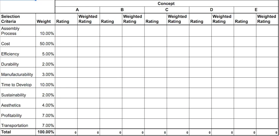

Filtering your Ideas – Concept Scoring
Concept scoring is a method through which ideas can be compared in a quantitative manner. It is not, however, a method to determine which single idea is the best. The final decision should not be chosen through this exercise, but rather by understanding what the rankings imply about your ideas.
Our suggested method to help whittle down the number of ideas is a concept scoring chart. This process provides a path to eliminating ideas that are objectively the least effective. To begin, think of all the important aspects that your design must contain. These are categorical criteria. For example, your solution might need to be cost-effective, manufacturable, safe to use, and maintainable. Try to choose no more than eight criteria. The criteria are listed vertically on the leftmost column of the chart.
Concept scoring chart
Once the criteria are listed, they can be ranked. Give each criteria a ranking of importance, each rank being a percentage of 100. If cost is the most important factor of your design, and eco-friendliness is the least important, they may get ranked 40% and 5%, respectively. This step is not crucial if all factors are the same significance; however, it can help differentiate your ideas a little more.
Next, go through each idea and give it a score of 0-5 in each category (0 = does not satisfy the criteria, 5 = completely satisfies the criteria). Then multiply the score by the weight of that category to get that idea’s score. Lastly, add up each idea’s score in each category to get the total score for each idea.
Although this process may seem to give a clear idea of which idea is the most useful, do not automatically jump to the idea with the highest score. While this process is a great indicator of low-ranking ideas, it can’t function as the sole determining factor of the single best idea. That decision requires consideration of context.
