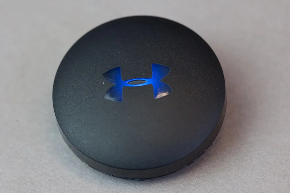

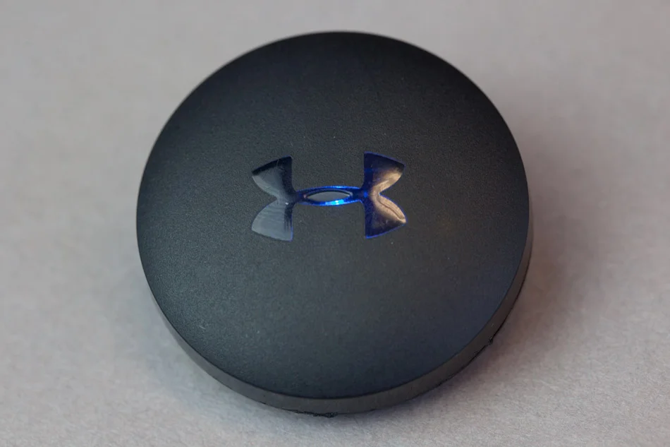

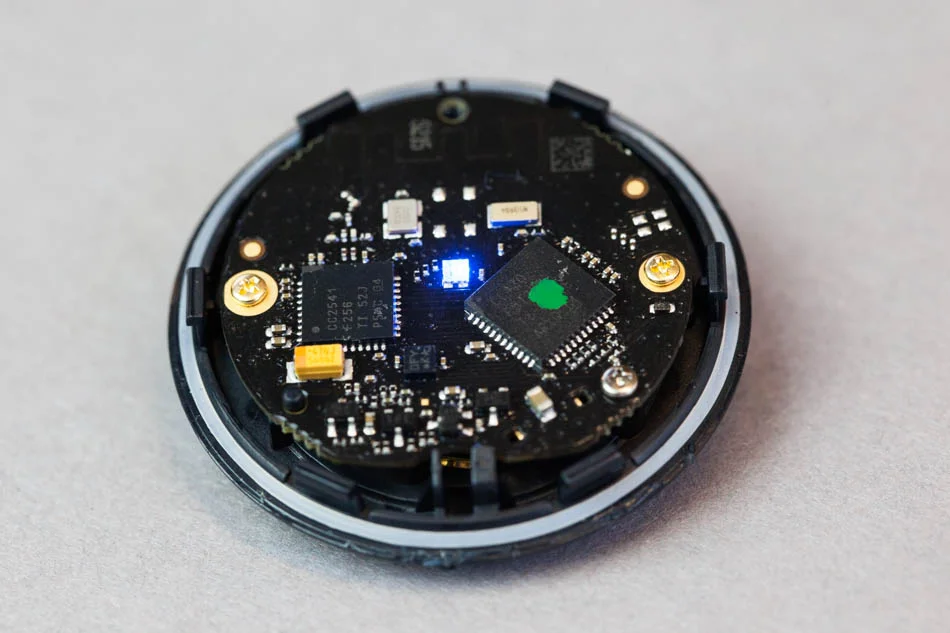

Example 1: Illuminated Logo of Under Armour Heart Rate Monitor
The UA heart rate monitor’s front cover features a sizeable logo. The engineers behind this product managed to light up this logo evenly, with just one tiny top-firing LED at the center of the main PCBA. This LED doesn’t have much reach by itself.
Under Armour LED
Enter the light pipe: It’s made of a milky plastic that could be polycarbonate resin (normally transparent) with added titanium dioxide. The more titanium dioxide that’s added, the more milky the plastic, which improves diffusion.
The cone-shaped cavity feature at the center of the light pipe is designed to match the LED; the angular wall of the cone helps to direct the emitted light into the light pipe.
The cone is the entry point of the light pipe, and the entry point should always be placed as close to the light source as possible, to minimize loss.
light pipe diffuser
Let’s see the actual effect of the light pipe:
  1. Without the light pipe, there is a strong hot spot in the center of the logo and not much light elsewhere.
  2. With the light pipe, the light emitted by the LED is spread out more evenly and the extreme hot spot is gone.
Under Armour LED without light pipe
Under Armour LED with light pipe

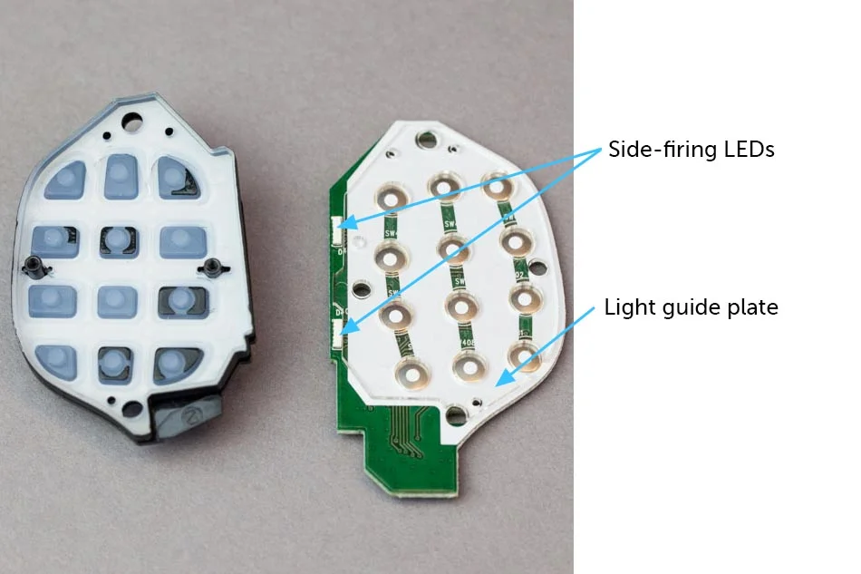

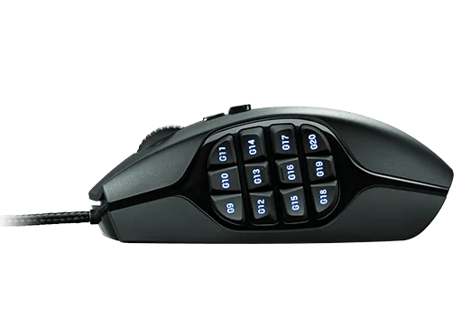

Example 2: Illuminated Thumb Pad of Logitech G600 MMO Mouse
The Logitech G600 MMO mouse has a twelve-button thumb pad. Each key is backlit, and the user can customize the light’s color. How many LEDs do you think are used to light up all these keys?
illuminated thumb pad
The answer is TWO! Isn’t that surprising? What wizardry!
The secret is side-firing LEDs that emit light directly into a flat plate of a light pipe. Notice how close the entry point of the light pipe is to the LEDs. You can’t afford losses when the lights have a long way to go to their exit points.
side-firing LEDs
Notice how the opposing elastomer thumb pad part has black paint spots on some keys, but not others? These black spots are close to the LED, likely to mask hot spots.
Also note that the light pipe plate is super glossy, and the surfaces encapsulating the light pipe’s top and bottom sides are both white. Both of these features help maximize the total internal reflection and improve color mixing.

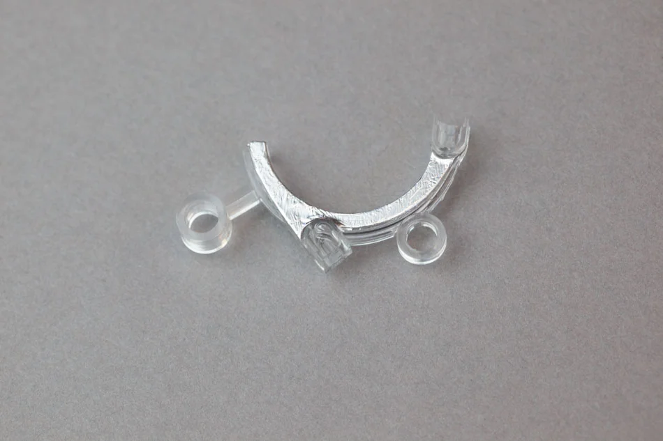

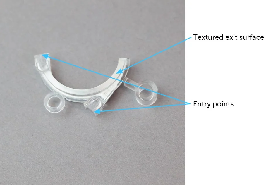

Example 1: Neato Light “Arc”
This light pipe cradles the Neato’s power button. It has two entry points for LEDs to illuminate the entire path evenly. The second LED is needed because light does not like to bend past 90 degrees. If only one LED were used, significant loss would happen where the second entry point is, and the end of the arc would be dark.
The entry points of the light pipe match the shape of the LEDs well.
Neato light pipe
Note that the top surface of the light pipe is textured, whereas all the other surfaces are glossy. Textured surfaces encourage light to exit, and glossy surfaces encourage internal reflection.
Also note that aluminum foil covers the underside of the light pipe. This has two purposes:
  1. To maximize total internal reflection
  2. To prevent users from seeing internal components underneath the light pipe
clear light pipe

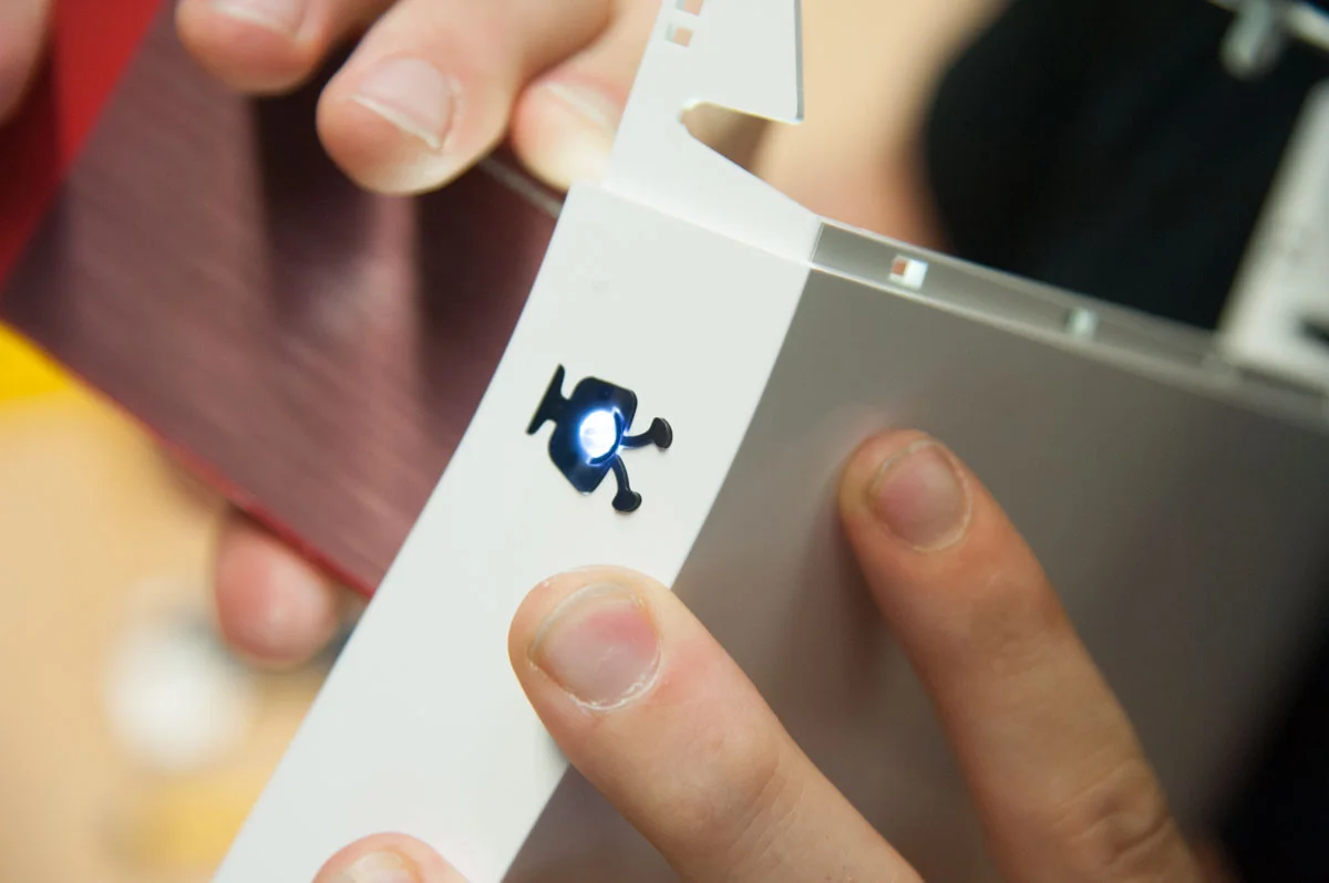

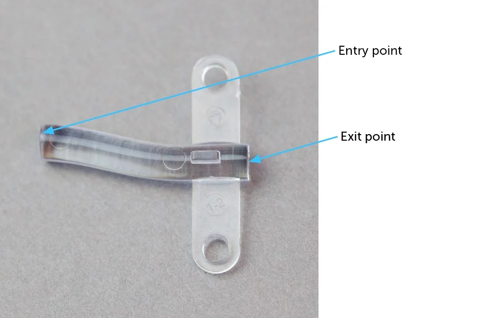

Example 2: TiVo Bolt Status Lights
The TiVo Bolt has five status indicator lights. For all of these, the light source had to be “bent” through light pipes to exit the enclosure.

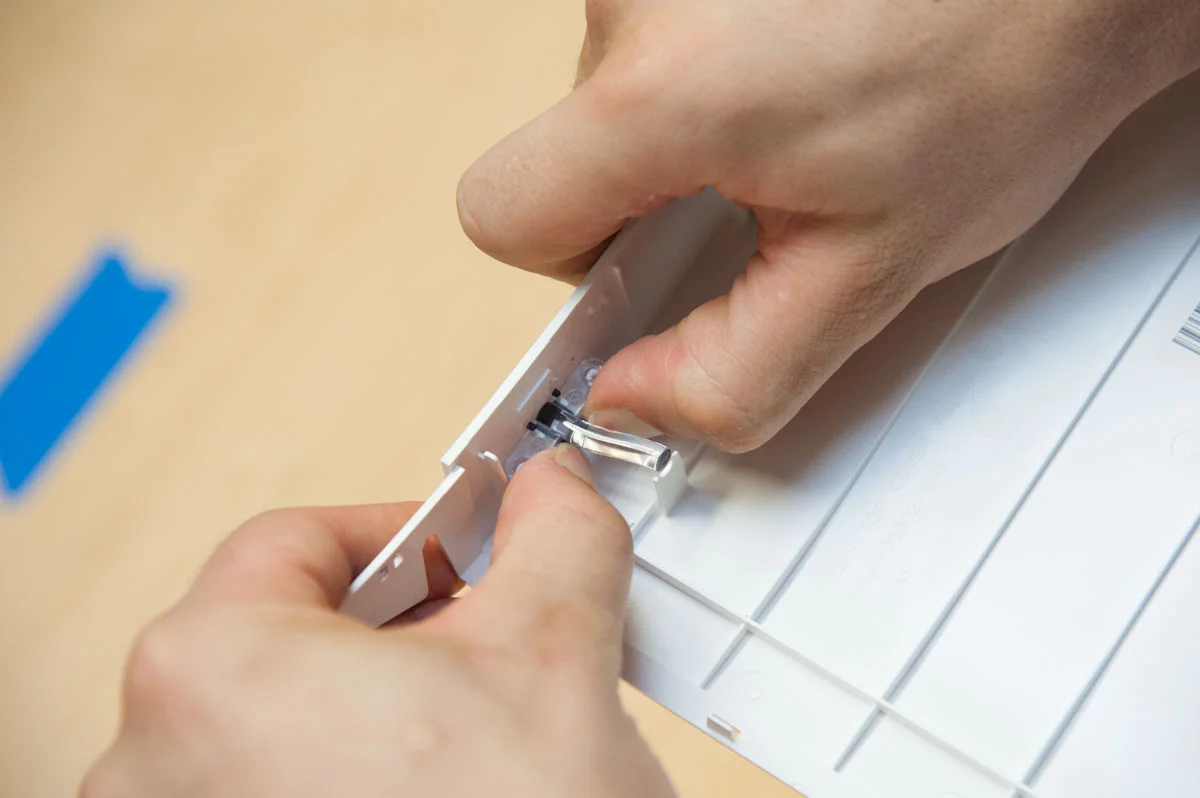

One of these is a very classic “light pipe,” a clear polycarbonate tube that’s slightly bent to transport light from the source to the exit point at the logo. The entry point is a flat surface—this is a light pipe that has not been matched to the LED, incurring brightness loss. However, this simplifies the injection mold tooling of the light pipe.
tivo light pipe
tivo light pipe
light pipe entry and exit points

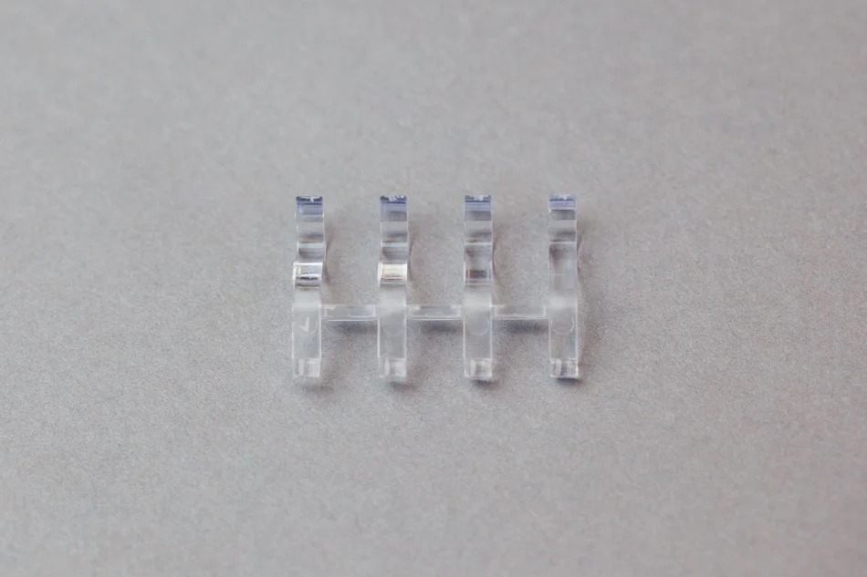

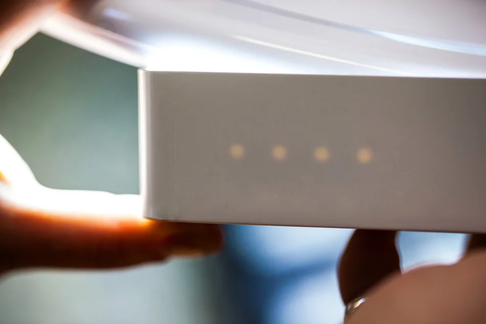

The other four indicator lights appear in a row.
tivo indicator lights

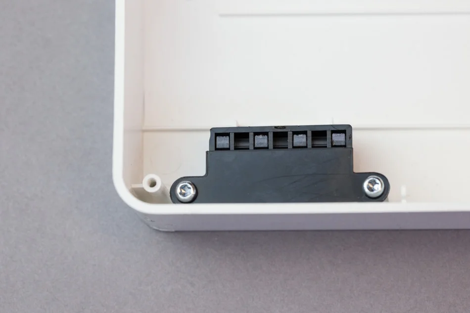

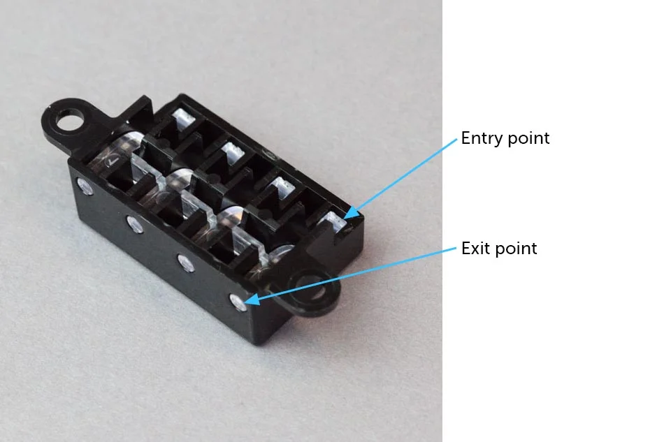

This set-up uses a multi-unit light pipe—think of this as a multi-lane roadway! Each “roadway” has its own entry and exit points. The light sources are four surface-mounted LEDs in a row.
The light pipe is covered by a two-piece black shroud, which eliminates light leakage. Since the TiVo Bolt enclosure is white (not light-proof), without the shroud, we wouldn’t be able to see each light distinctly.
light pipe shroud
light pipe shroud
