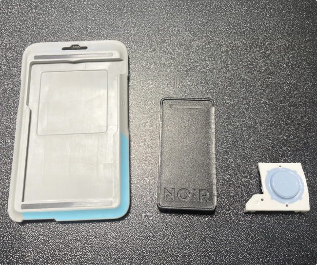

Molding two plastics together to form one part with two colors or different materials into one part. Overmolding starts by molding a single material, typically the harder material, in a mold and then ejecting it and cleaning off the gates. This part is known as the substrate and is then placed into a second mold to be molded over with a second material known as the overmold.
This process provides a complex part with two materials that are chemically bonded to each other. Examples of this type of molding are toothbrushes, surgical instruments, or power tool handles.
Benefits
Great process for 2 material parts that are:
  • Lower volumes – Under 10,000 parts
  • New product development – Prototype
  • Require mechanical interlocks
