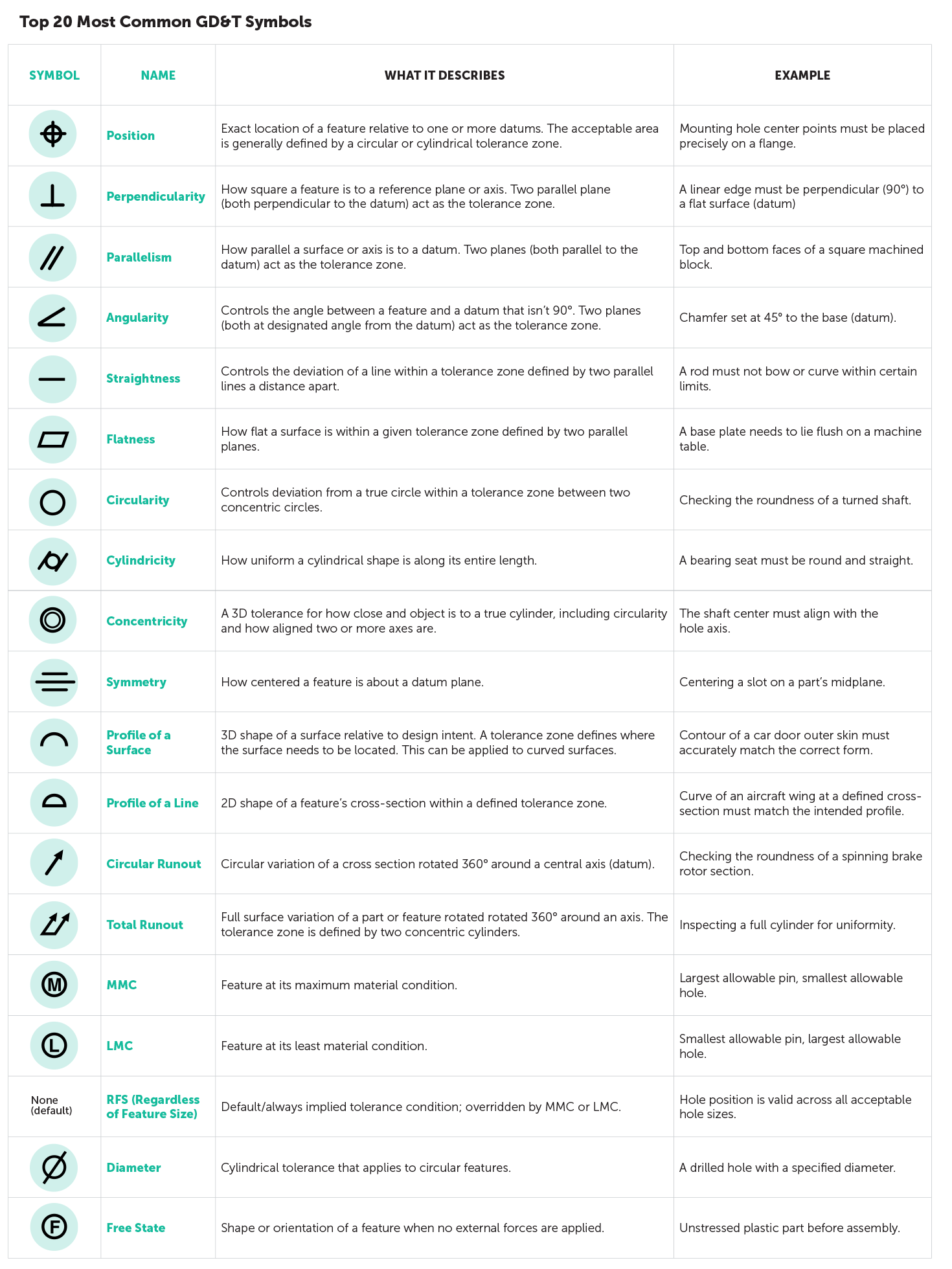

Geometric Tolerance Symbols
Symbol Name Type Controls
Flatness Form Between two parallel planes
Circularity Form Between concentric circles
// Parallelism Orientation Parallel to datum
Perpendicularity Orientation Perpendicular to datum
Angularity Orientation At angle to datum
Position Location True position to datums
Concentricity Location Median points in cyl. zone
Circular Runout Runout Variation per rotation
↗↗ Total Runout Runout Full surface variation

Material Condition Modifiers
Name Meaning
MMC Max material. Bonus tolerance as feature departs.
LMC Least material. Bonus tolerance applies.
RFS All sizes. Default if none specified.
