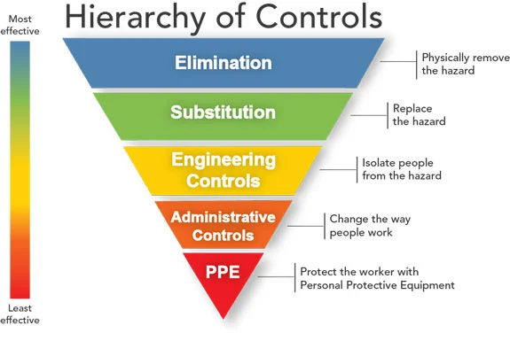

The National Institute for Occupational Health and Safety (NIOSH), a U.S. federal agency that makes recommendations to prevent workplace injuries, puts PPE at the bottom of a hierarchy of controls that are designed to protect workers from injury.
This means that while PPE is required, it’s the last line of defense in CNC machine safety. The higher level controls are more effective in reducing injuries during CNC machining.

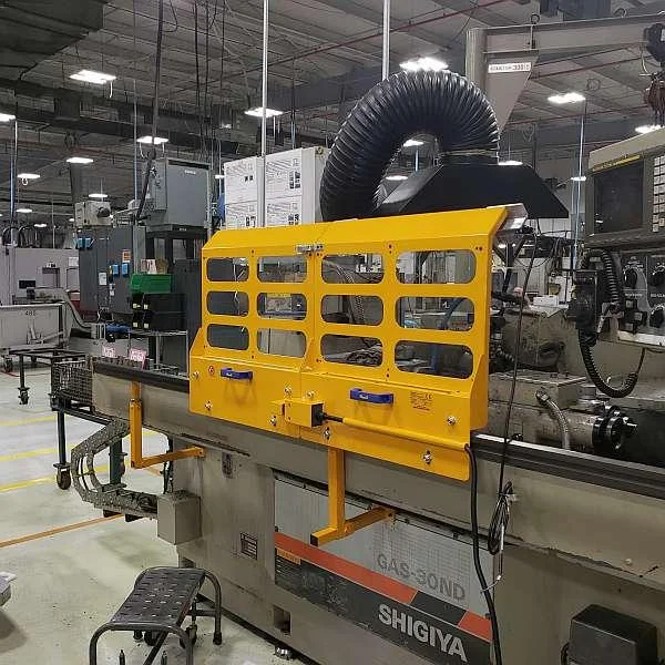

Machine Guarding for Accident Prevention
Machine guards are safety barriers or devices that enclose hazardous parts of equipment. These protective measures are classified as engineering controls, and machine guards are designed to prevent employees from intentionally or accidentally contacting these parts while the machine is running.
OSHA publishes specific machine guarding standards, including 1910.212(a)(3)(iv) for milling machines. Machine guards may be factory installed, or added to the machine after it arrives at a CNC machine shop.
Three main types of machine guards are fixed, interlocking, and adjustable.
- Fixed guards attach to machinery and are not adjustable by employees while the CNC machine runs. Examples include fences, gates, and protective covers for cutting tools.
- Interlocking guards, otherwise known as safety interlocks, are moveable and combine a physical barrier with a safety mechanism such as a switch. When the guard is open, they stop the machine.
- Adjustable guards can be repositioned or resized depending on the machining operation or the size and thickness of the workpiece. They require the most operator involvement between runs.
