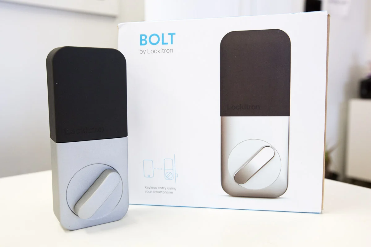

Minimize Custom Components
Since tooling can be a significant cost, we recommend minimizing the number of unique custom-designed components. Spend your dollars on cosmetic and critical components, and economize internal, non-critical components.
Lockitron's team found that reducing the number of custom components was key for their third generation product success
Lockitron’s team found that reducing the number of custom components was key for their third generation product success
To avoid the high upfront cost of tooling, you should use off-the-shelf components wherever possible and explore alternative manufacturing methods that won’t incur high upfront cost. For example, instead of die cutting a foam gasket or molding a silicone gasket, consider laser-cutting them.

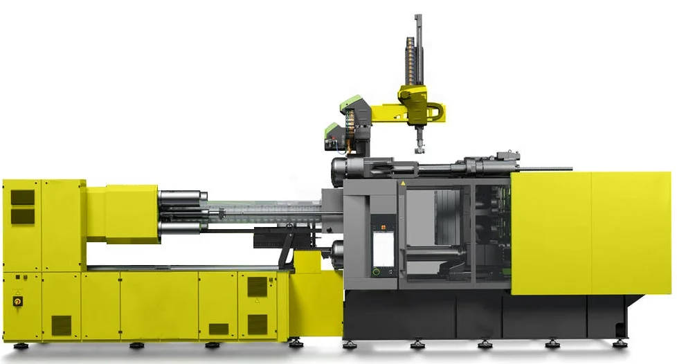

Tips to Minimize Costs for Plastic Injection Molding at Low Volumes
When most people think of mass-produced plastic components prevalent in consumer goods, they’re thinking of injection molded parts. Injection molding tooling costs start in the low thousands per mold, which is amortized over its production life.
Injection molding machine
As mentioned above, it’s key to keep the tool simple to minimize part cost at lower volumes. We recommend you minimize the number of side actions (requiring sliders and lifters) and avoid specialized molds, such as collapsible core and two-shot molds. Also be realistic about cosmetic standards: High gloss is much more expensive than a standard matte look, especially for large parts.
Injection molding costs and tooling lead time can vary greatly from vendor to vendor, even for the same design. A few factors determine this, including:
  1. Tool base metal (aluminum, P20 steel, etc.)
  2. Manual vs. automatic sliders
  3. Cold vs. hot runners
  4. Use of cooling lines
All of these factors will impact the quality of the part, especially cosmetic. Manufacturing is really a game of tradeoffs, mostly between “quality” and cost.
The fastest and most basic injection molding tool will be made out of aluminum, using manual sliders, cold runners, and not incorporating cooling lines. This is very much meant to be a quick-turn prototyping tool, but it may work for non-cosmetic components and the unit cost will be especially economical for quantities in the low hundreds.
Aluminum tool life is usually around 1,000 units. Above 1,000 units, you’ll need steel tools with automatic sliders to reduce cycle time.
Many injection molding manufacturers will make a family mold for small parts that are produced in relatively low quantities. This means that more than one component will be cast together in one mold, which saves on tool base material cost and cycle time per component. To leverage this, use the same material for as many components as possible in your design.
